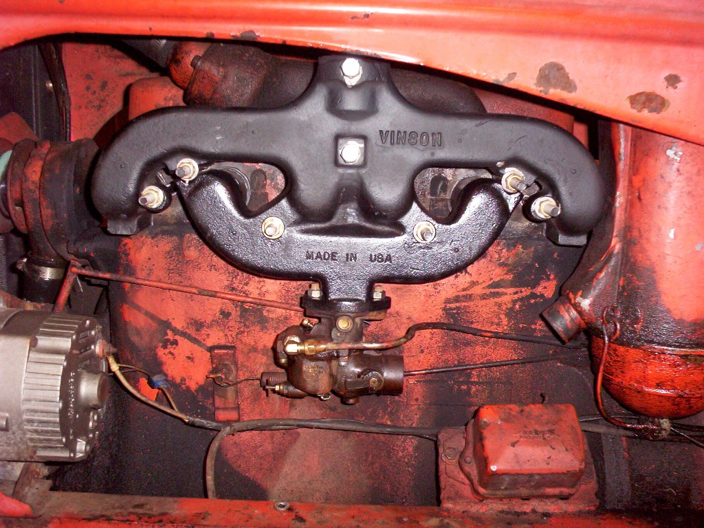

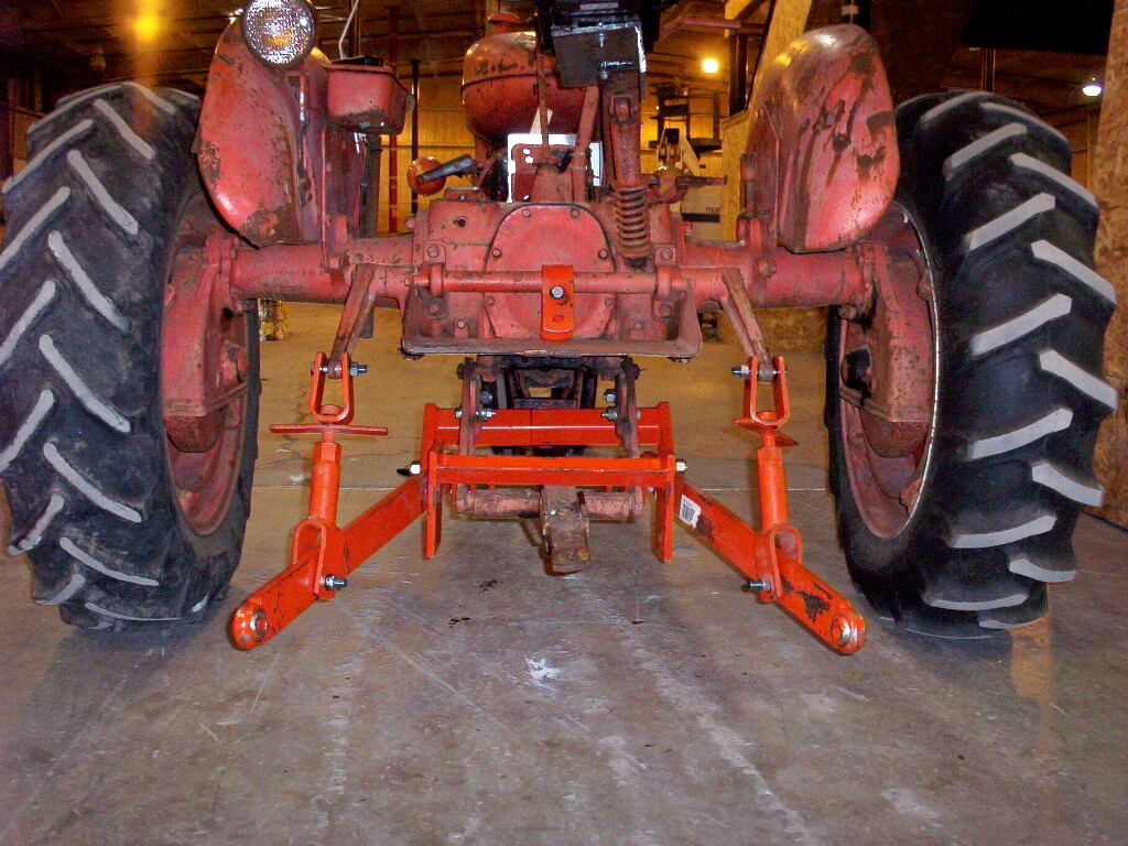

Finally got around to installing the 2-point to 3 point hitch conversion kit on the old Allis-Chalmers WD. It was too easy, something must be wrong. I got the kit from OKtractor.com along with the intake/exhaust manifold. That was a little more difficult. 3 studs broke. Luckily, they came out with a gentle twist from vise-grips. If I knew that this is all there is to the 3 point conversion, I would have built it myself. I could have gotten some arms off of anything, links also, and welded the rest. But, I can't complain as the kit was only $340+ shipping. I was going to do hydraulic TNT, but the hydraulics on these old tractors is very limited. I may do something at a later date with it, but the tractor sees very limited use, maybe 10 hours a year. I'll try it out brush-hogging this summer.

The nice thing about this kit is that you can convert back to the snap couple hitch very easily if you want to.

Andy, it is probably right in front of my face, but I can't see where the toplink attaches and pivots. Other than that, it looks like a very easy conversion and will make that tractor much more useful. Heck, you might get the hours up to 11-12 per year.;)

There's a bright orange piece right in the middle of the rear end pumpkin cover. It's a U shaped piece with a bolt thru it. That's where the top link goes.
The bolts on the top links are a little tight. I'm going to remove them and install spacers. It bothers me having those brackets bend. All I need now is the pto shaft and rear carrier and it will be fully operational. The draft control works perfectly. I was concerned that the cylinders would leak after not being used for at least the past 15 years. I have to get some weight on it to be sure, but it looks good for now.
