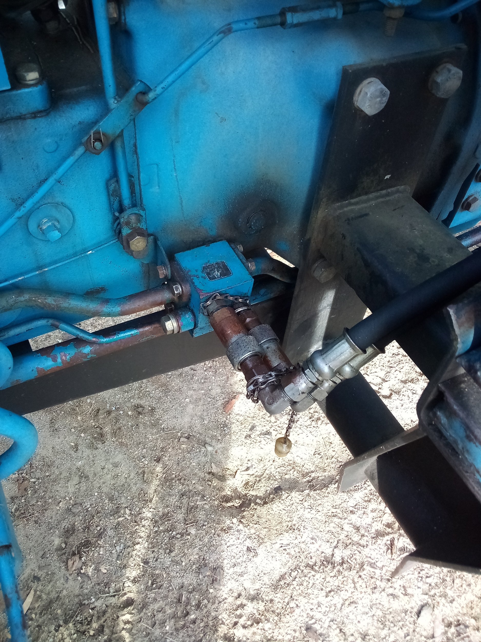

For clarification (SEE PHOTO) The main 3/4" steel hydro-line from the pump goes into the square block just ahead of the right side floor board, and straight through to the 3-point system under the seat. The block has Pressure and reTurn quick-connects for the loader or whatever.
There are no electronics, no electric valves, no reason for any tractor function to change, unless something has gone wrong inside this square block.

Harry is right. I don't want to sound rude by any means but you may want to read a little bit more about how open center hydraulic systems work.
The block you showed on the picture allows you to run the tractor with or without a loader. It has a spool that needs to be rotated. With no loader attached, you must rotate a spool in that block so the pump feeds the rest of the circuit, in this case, the 3 pt. Right now, it's pushing all the fluid through the relief valve and therefore sending all the fluid back the transmission and not feeding the 3 pt.
With the loader, you would rotate it the other way. The faded sticker on top of the block would indicate that but it's no longer readable.
With the new valve, you need the power beyond fitting for said valve as this is specific.
The Pressure line comes from the block on the tractor to feed the new valve on the P port. The power beyond line comes from the new valve and goes to the other port on the block to feed the rest of the circuit.
Lastly, the Tank line coming from the new loader valve as to connect somewhere into the transmission so it can dump the fluid there.

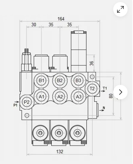

Forget for a moment the the image below is only for a 2 cylinder valve (yes control block may have many more ports for cylinders) but your concern is probably the "N" port that should supply hydraulic pressure (Power) to 3 PH if you have "typical" open center system...

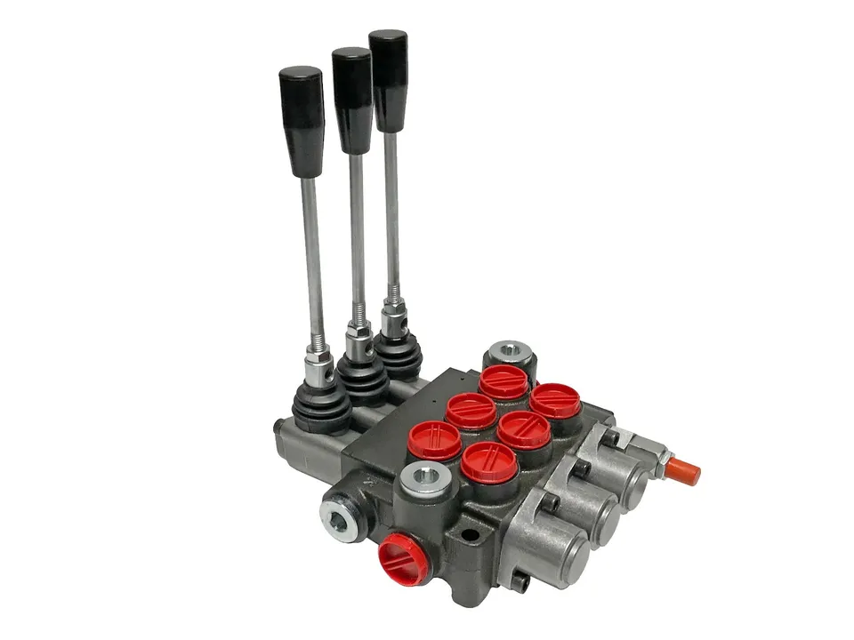

OR ...
