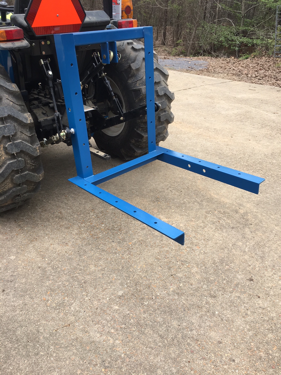

I bought mine from TSC painted it to Mach my LS 3037

Regarding the boards - 6 inch overhand on each end? 2x8s or 10s? Read a few threads and don't recall seeing the board sizes, which of course can vary from user to user.
   / 3 point carry all, build or buy? #48
If you’re referring to my carry-all, it’s a copy of MMfromPA Carry-all. Check out his YouTube video
#93 Must Have Tractor Attachment!! Follow Up Video - YouTube
One very important note concerning the trailer hitch, as I have it installed; it ain’t good for pulling logs out of a pile! I knew better but broke the 2”x10” board that the hitch is mounted to. I’ve since replaced it but I may end up welding a piece of 3” angle across to mount the hitch to.

Personally, I bought the King Kutter frame from a local tractor dealer. I think I paid less than $150 out the door. Probably could make it for less, but hey, my time is worth something. I have got an overview of mine on my YouTube channel. For those interested, please take a look.
