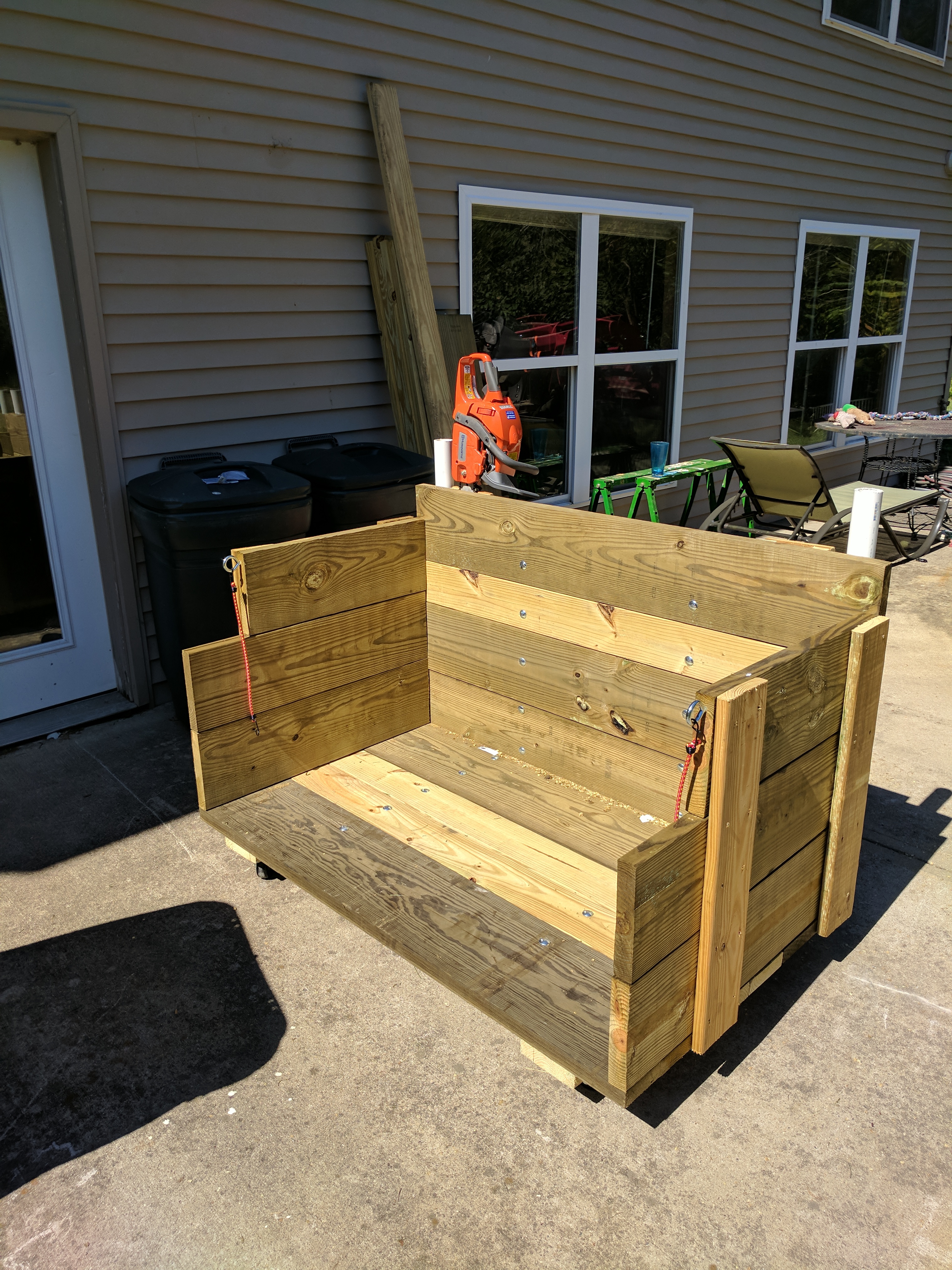

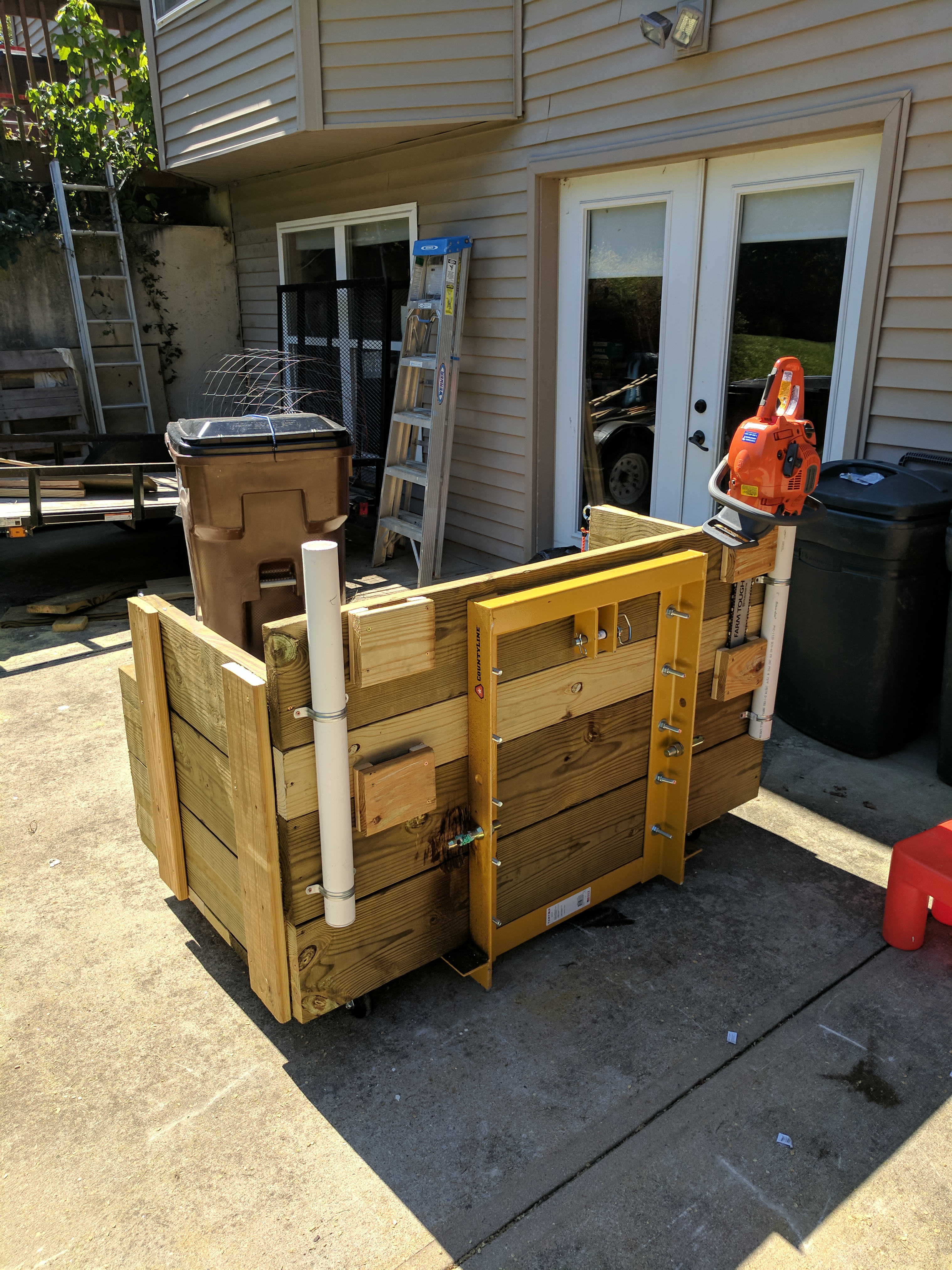

Built mine last year. Casters underneath to help roll around. Two spots for chainsaws and tubes for shovels or rakes. I also added a trailer hitch for the wood splitter. IMG_20170924_135658.jpgIMG_20170924_135648.jpg

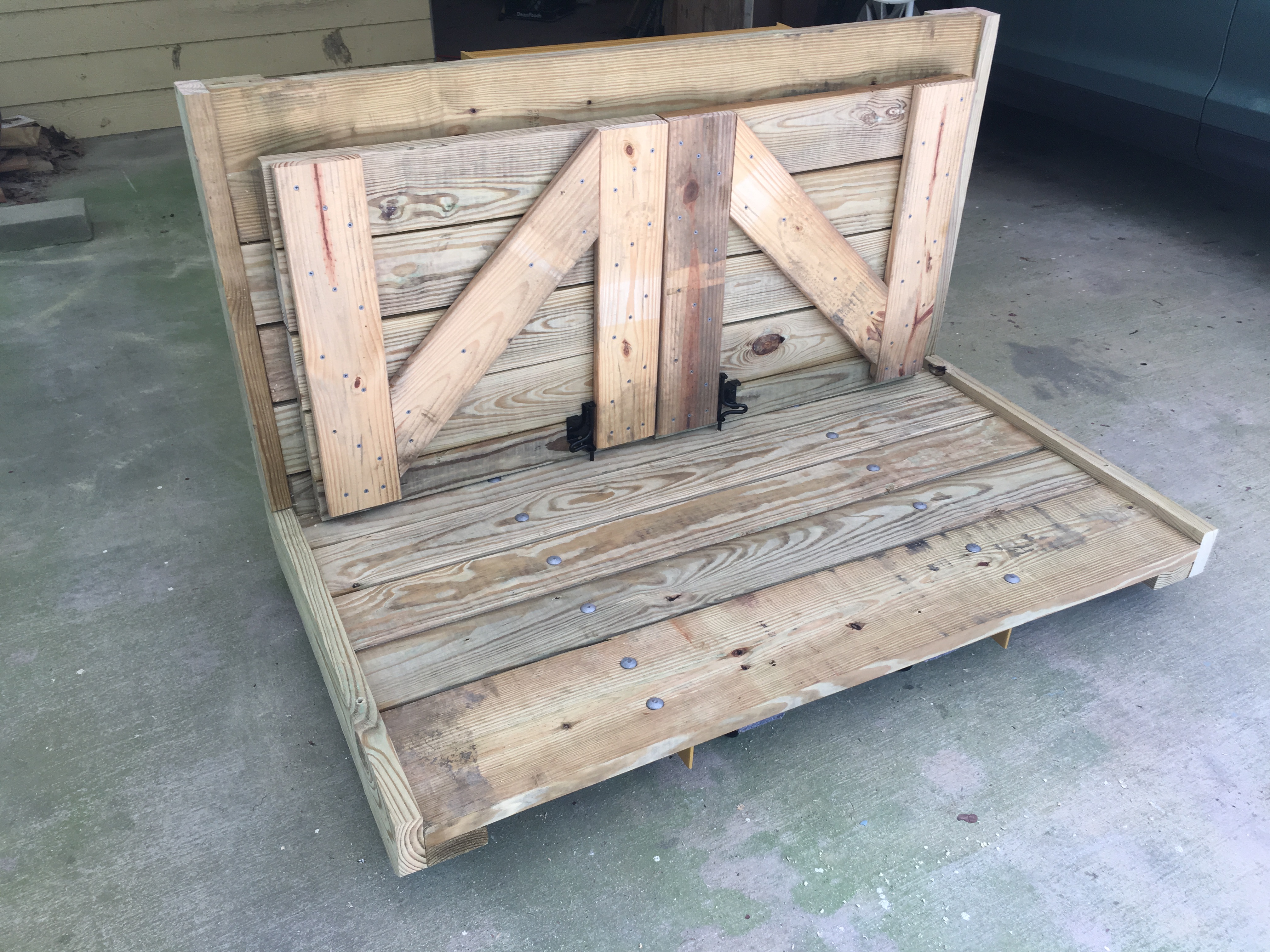

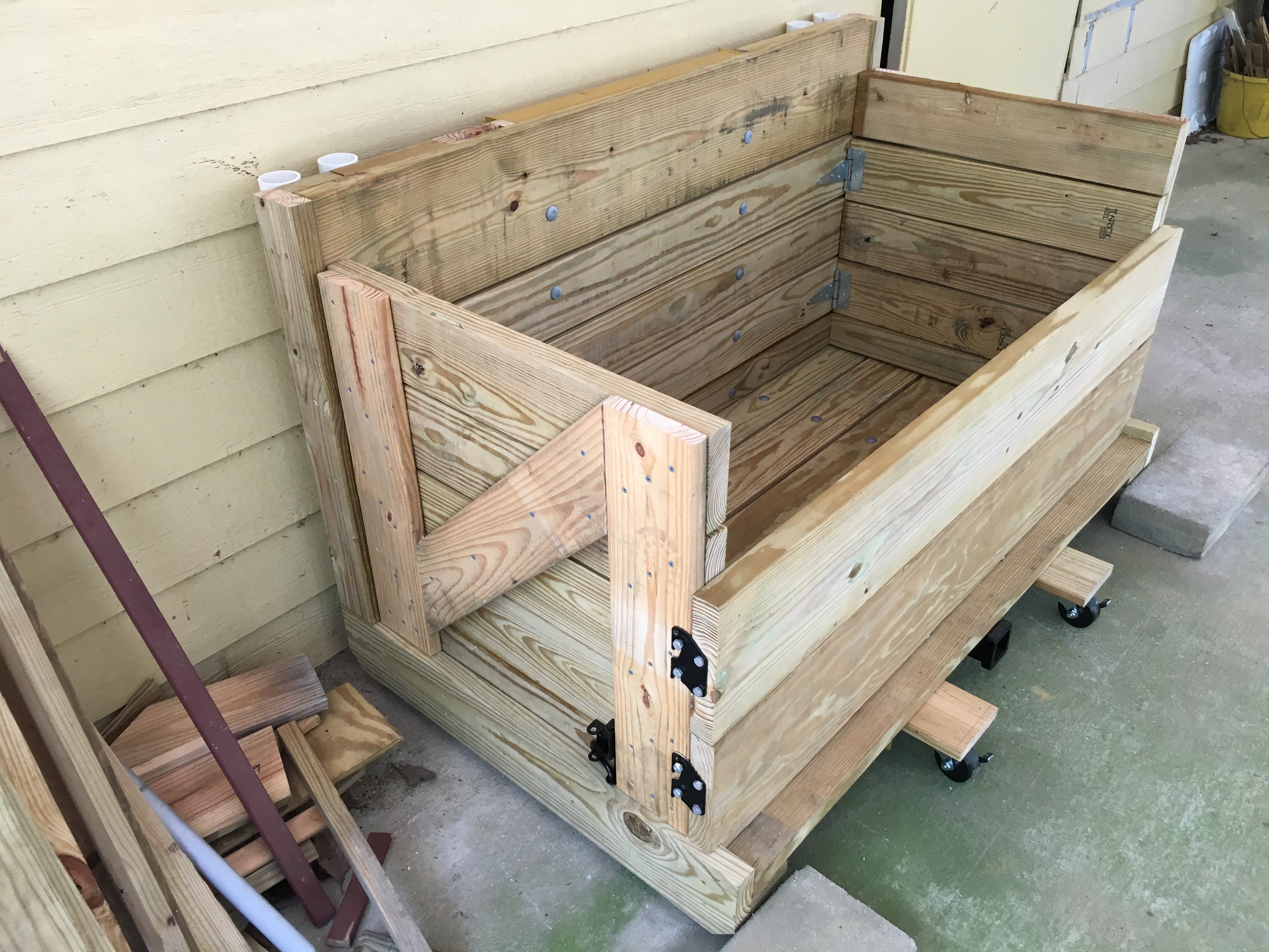

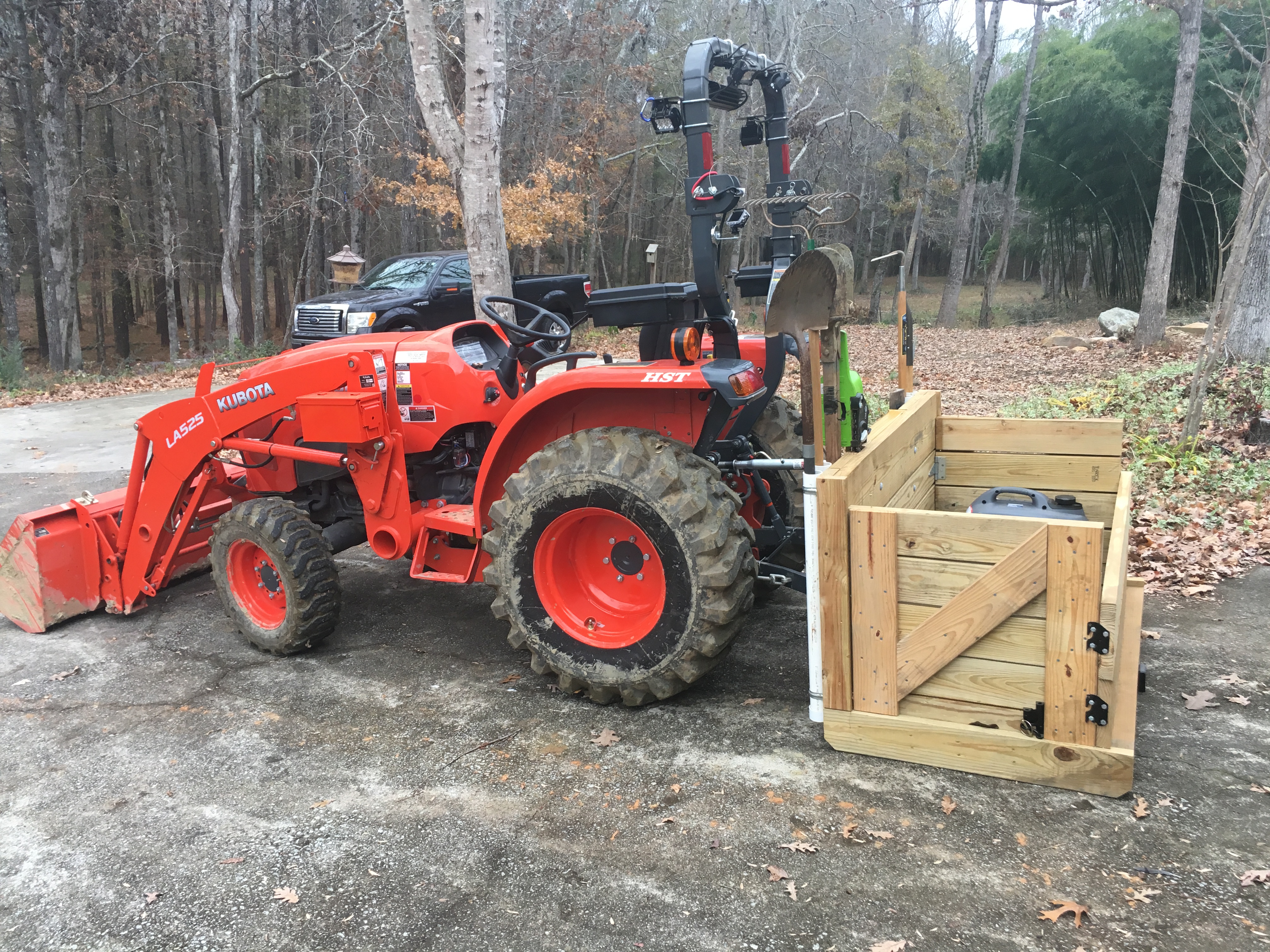

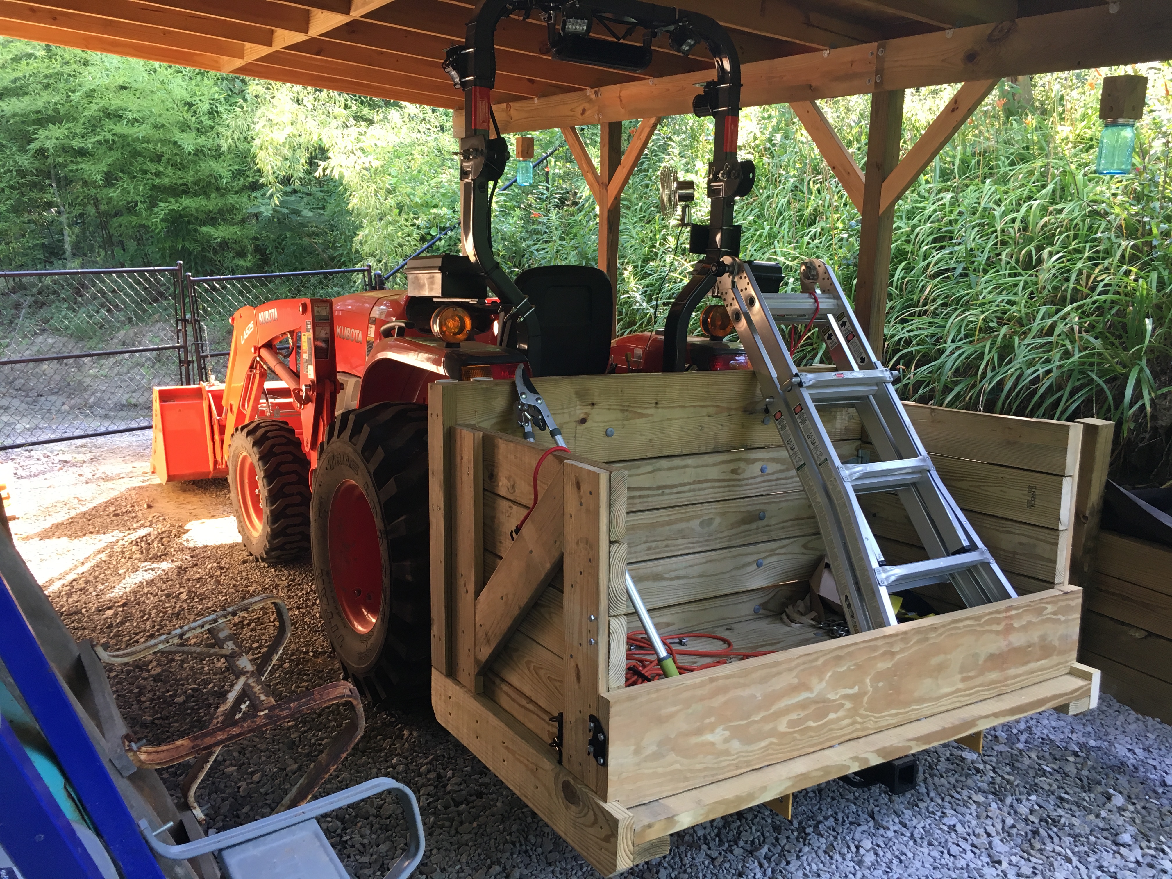

I see you used the TSC carry all frame too. I've attached a few pics of the one I built, and here are the links to the YouTube videos showing what the carry can do and how to build it:
Versatile Tractor Carry All for My Kubota Tractor - Part 1 - YouTube
Versatile Tractor Carry All for My Kubota Tractor - Part 2 - YouTube
Let me know if you find any of the ideas useful.
That looks good! I'm going to have to break down and make one of these!
Side note - do you have any videos or design docs for the overhead extension (carport?) seen in 5 pictures as I see them (view from back of tractor with ladder in carry all)? Looking to extend something from the back of my detached garage to shed my tractor and stuff.

Seems like you have a lot of heavy wood there which means a lot of weight which means reduced carry capacity. That may not matter for larger machines, but could be a deal killer for smaller ones. Sure, we could scale down. But why not use lighter materials to begin with? 2" PVC Electrical conduit and fittings could be used for framing. If sides were needed, there are lightweight perforated panels available. Solid panels and sealants could be used for weather protection of tools that might be left/stored in it.
I don't see where you have anything loaded that needs such a stout box, nor do I see that you have a way to close and lock it or to protect anything from the weather.
