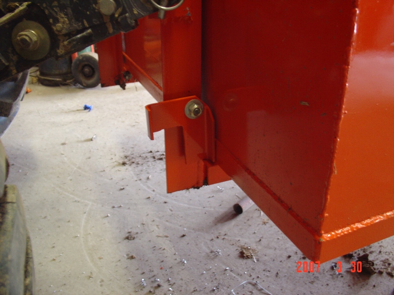

Looks great!! how do you keep the tilt bed from staying tilted ? Do you have a pin or something to keep it horizontal during transport?
Jc,
Good point. Should have added this picture. I totally forgot about a latch mechanism until I dumped a load of firewood. Necessity being the driving force ya know. So I went back in the shop and added this latch on one side. Then after I noticed the twist I was putting on the box with just one latch, I added a second on the other side. Ultimate goal is a hydraulic dump cylinder after I get rear remotes added to the tractor.
I never noticed the birdhouse smokestack until someone else mentioned it the first time I posted that picture. I couldn't have shot that better if I tried!!! :p

   / 3 point carry all, build or buy? #20
ovrszd,
That is one sweet dump/carry all you made. Adding the hydraulic dump cylinder will make it perfect.
Outstanding work!
