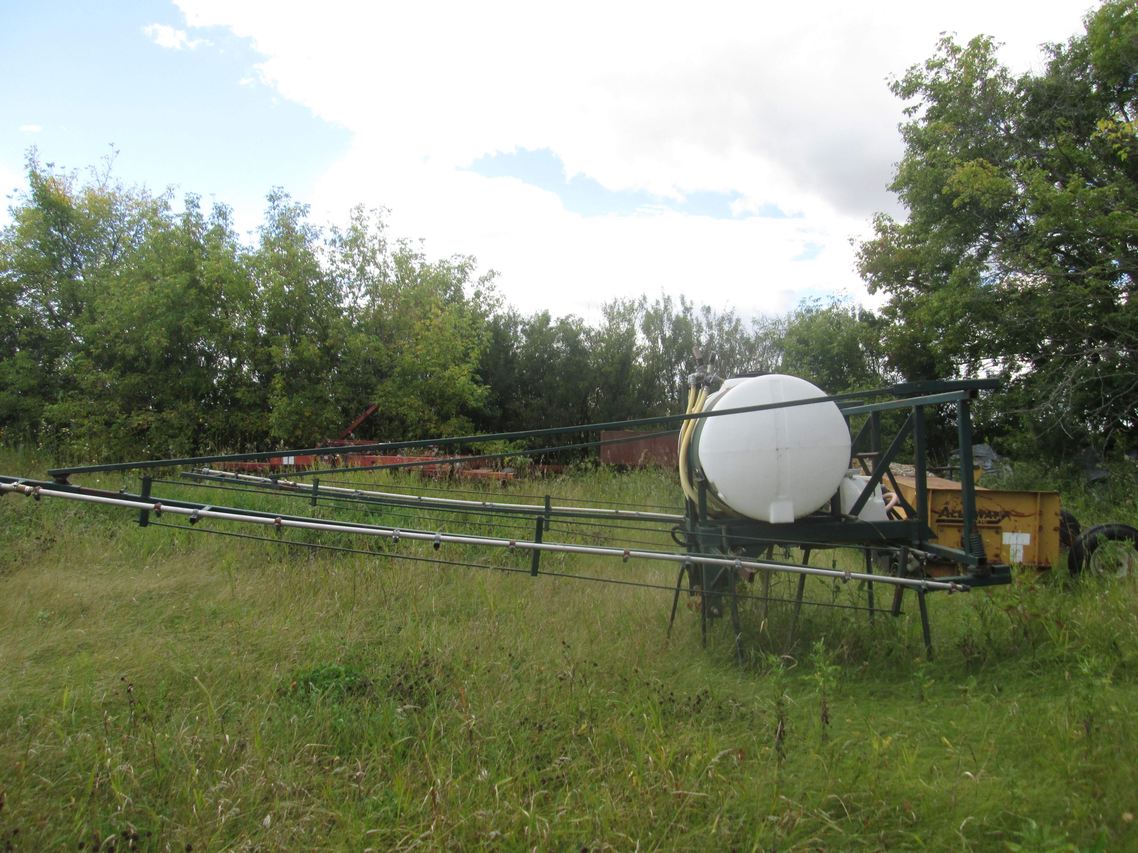

I have this for sale $100 ...no pump on it though :)
Unfortunately you are a couple Provinces to far away from me, otherwise I'd buy it right away. What are chances of you driving out west in the spring???
