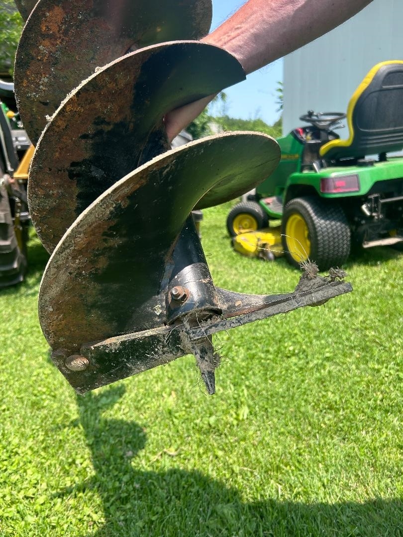

I went to use my 3 point auger on my JD 4710 tractor for the first time in years.
Everything hooked up fine but when I drop the auger to the dirt it won't screw down to create the hole. The lift mechanism is totally dropped, it just wont dig in.

Can you post a Photo of the tip of the auger? Is the pointy tip replaceable? Are we talking red clay dirt or rocky? (no location listed so just guessing).
Does your PHD have a way to slide a pipe in and add extra down pressure? Leinbach line like mine does... Again photo might help.
Try soaking the area with water to see if that helps....

Thanks to all for responses. I'm enclosing a pic of cutter. Slight clay content in soil, otherwise sandy loam. I've tried uploading a video but can't get it to take. Bit spins, I've tried low speed, high speed. With bit tucked up under auger arm 3 point arms allow for full descent.

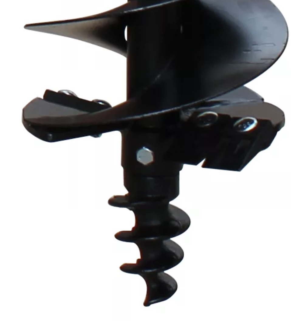

Yep, that pointy spike on the end won't dig too well......
This auger from TSC will dig to China! 4 cutting edges, and the spiral tip.
I have very hard sandy loam / clay. These are very good for the price, plus the tips are all replaceable.

As @LS Tractor Owner states, that tip is the problem. I have never seen an auger tip like that.
If you must use that particular auger you could try hand digging a small hole that would allow the cutting edges to get a better initial bite.

I’ve seen and used two augers with tips like that. When the ground is soft they work, but they are not a desirable auger.
The only thing is that is the only type of tip that will work on that auger. To switch to the screw tip you need to buy a different auger.
