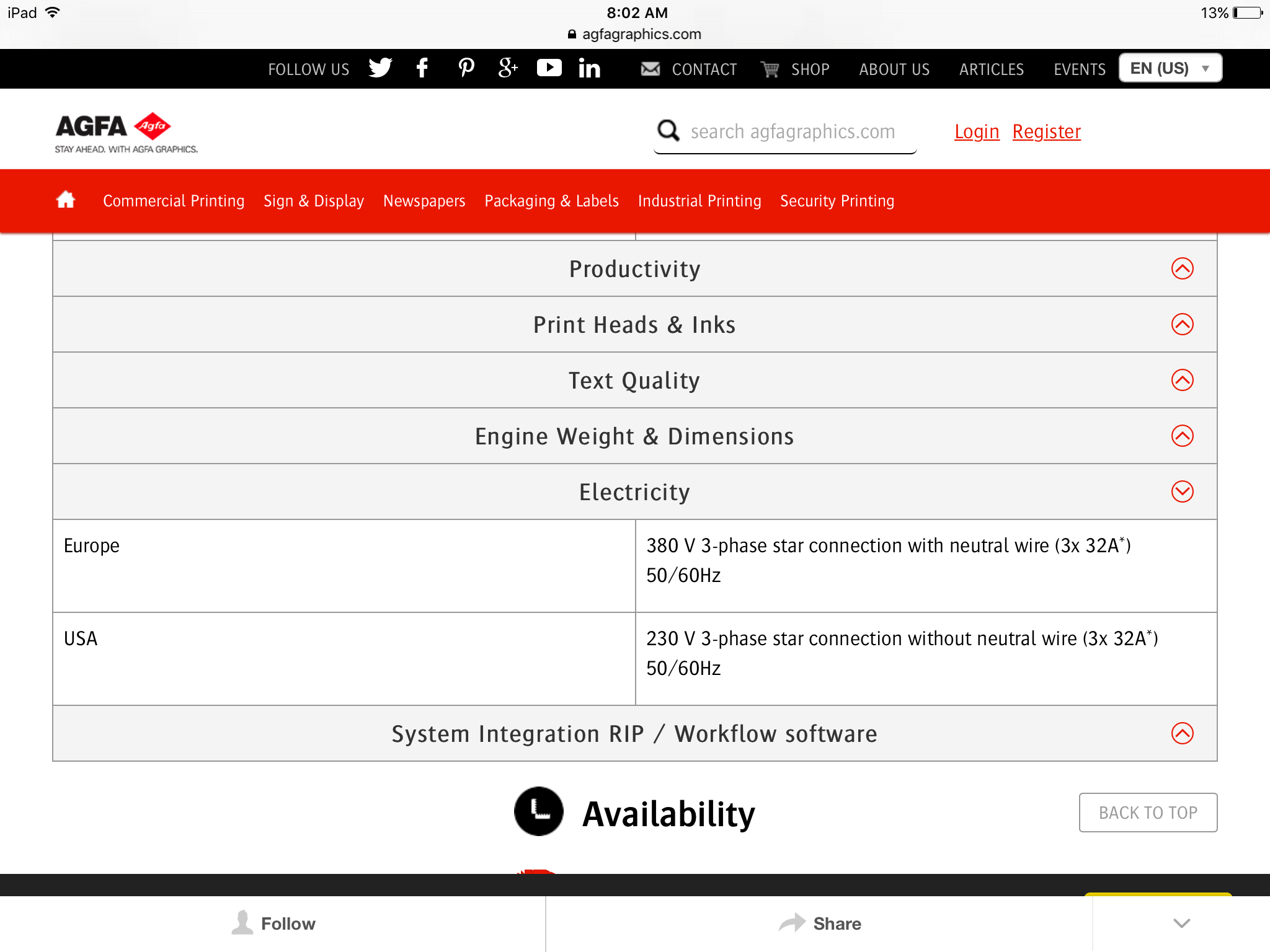

How often do you plan on using it? 32a is alot of power.
If plans to use very frequently, my want to re-consider 3ph from the power company. Over the long haul, the extra cost from the inefficiency of converting single phase may be more.
Have you even contacted the power company? My interpretation of what you said earlier is that you have not because you assume it's gonna be expensive. But you cannot make an educated decision without first finding out for sure.
Second, have you inquired if you can get the printer in a single phase version?
Either of those would be a better solution if the plan is to use it more than just occasionally, IMO

We are more than 1500 feet to run another leg for true 3 phase. I know because when I built the house, I had to trench and build the underground for our house. It's a bit over 1500 from our transformer and another 300 feet to the house.. It's also a private line and only powers my property. We would be using this almost everyday. If it won't run off a converter, I may have to look at a different machine, .. And I really don't want to.
Semantics, but you would need TWO more legs for 3 phase.
Power companies are different everywhere. Around here, it dont cost anything to get power to a meter. But you pay for and do (or contract) everything on your side of the meter.
I would still try to get ahold of the MFG just to inquire what they recommend. And will warrant. Regardless of what anyone of us on the internet say, I wouldnt do anything that would void a warranty. Which may indeed push you to find a single phase machine.

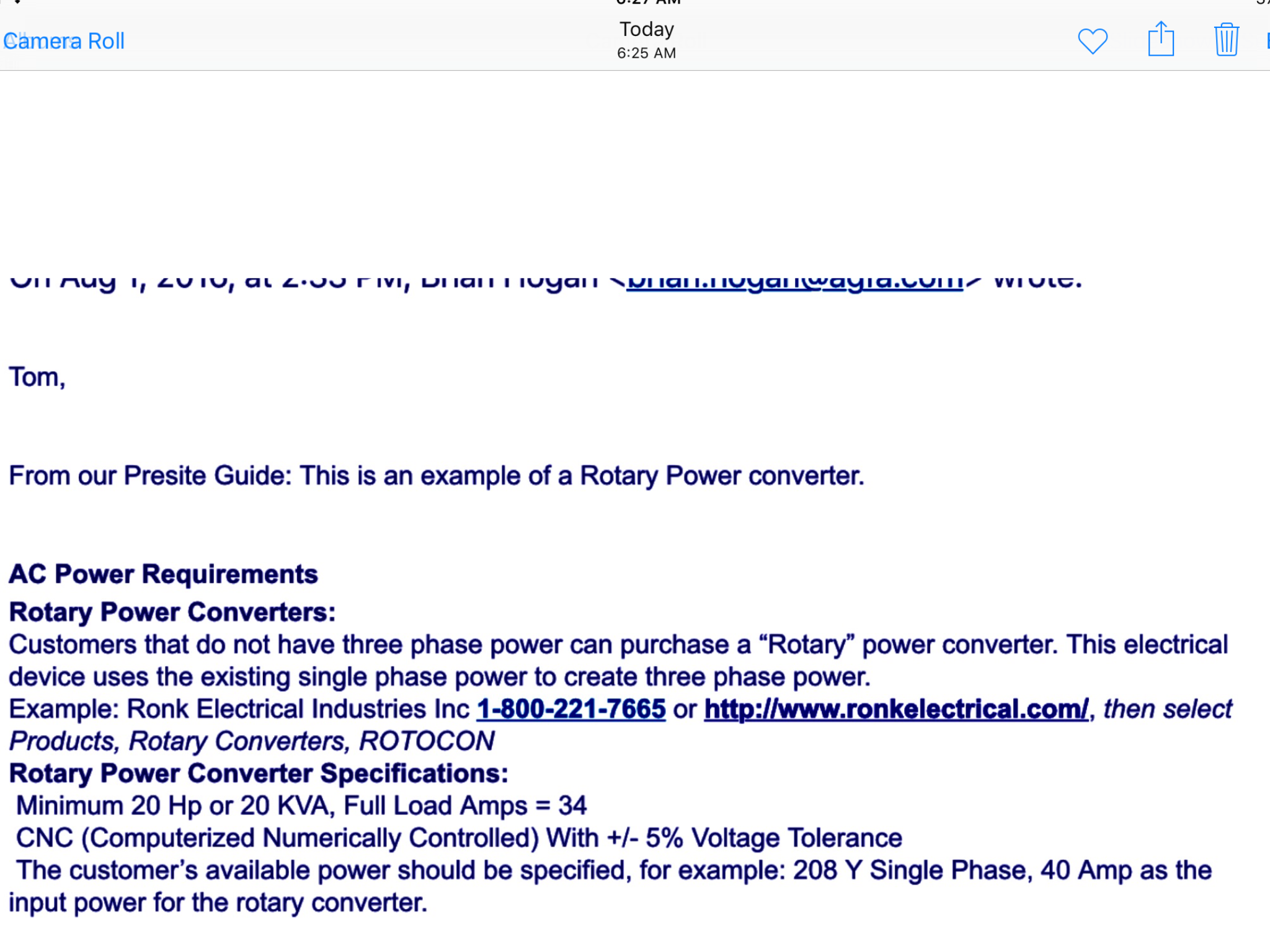

This is what they have suggested.

Sounds like their printer ain't picky if they are suggesting a rotary.
Still probably looking at $1500-$2000 or more. I have never priced one that big. And wouldn't try to make one out of a static + motor, cause keeping voltage +/- 5% is gonna be hard on a DIY.

That Ronk phase converter is definitely expensive compared to some others, but if that is what the printer company wants you will probably have to use it. It certainly appears to be a quality system. There are other less expensive setups that would probably work, but those could lead to warranty problems with the printer.

Ronk was at one time the big name in phase converters.

I suggest that if any RPC is recommended the printer likely has a degree of 'power conditioning' built in. (& that's a good thing)
If you build an RPC (w/cheap 3PH motor from CL or EB) I strongly recommend PhaseCraft for the control panel. Their setup help and service after sale are among the best out there. Lots to read here at the bottom of the page. (Not just pitch)
(20 hp, not 2hp) 2� HP Manual Start Rotary Phase Converter Control Panel | eBay
Some general tidbits about phase conversion:
- Phase Perfect doesn't require an idler but it isn't exactly silent. (not too bad, tho')
- an RPC's idler/motor typically runs 'louder' than if used as a load motor with 3PH from the pole.
- At 20hp rating, consider building a 'doghouse' for an RPC (often outside the shop/office) as noise may drown out that of what's running on it. (not so good)
btw. Counting on seeing pics of the printer/output someday. :) (3-D printer, no?)
