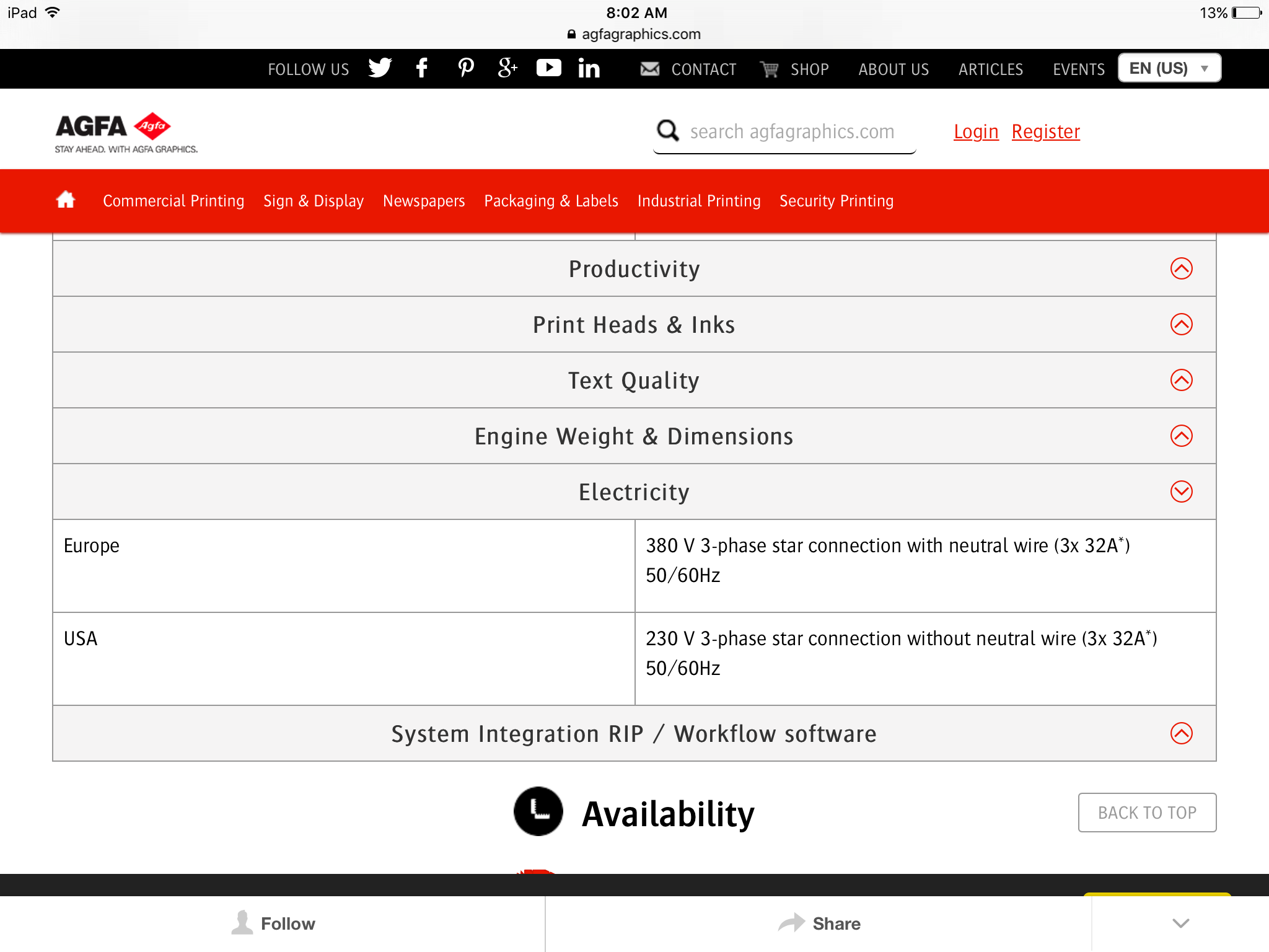

It is a electronic application. It a a large format UV printer. I'm going to ask the manufacturer is a converter is even a option with their unit. I don't want to void any warranty and can't compromise any power requirements.

If it is electronics you do not want a VFD or static. You likely need true 3 phase which is a MG set (motor/generator) or perhaps a 3 phase diesel generator.
The manufacturer should know. How big is the load?
/ 3 phase converter ok ?
#20
This is what they list for power requirements
