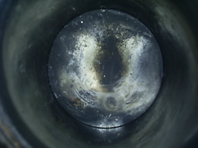

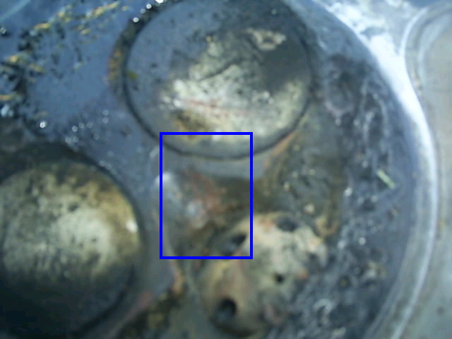

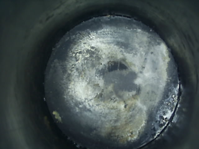

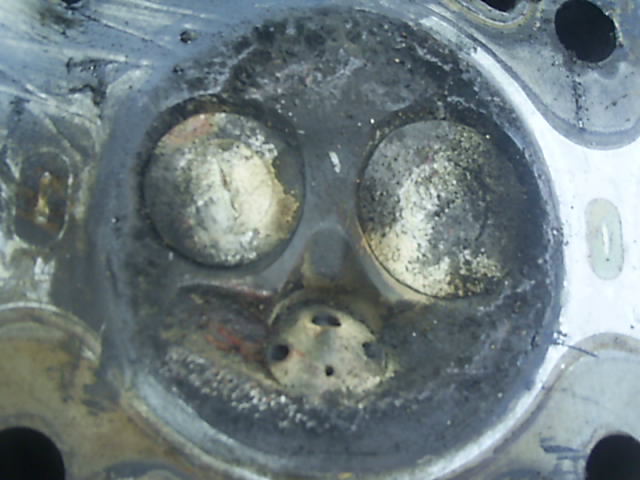

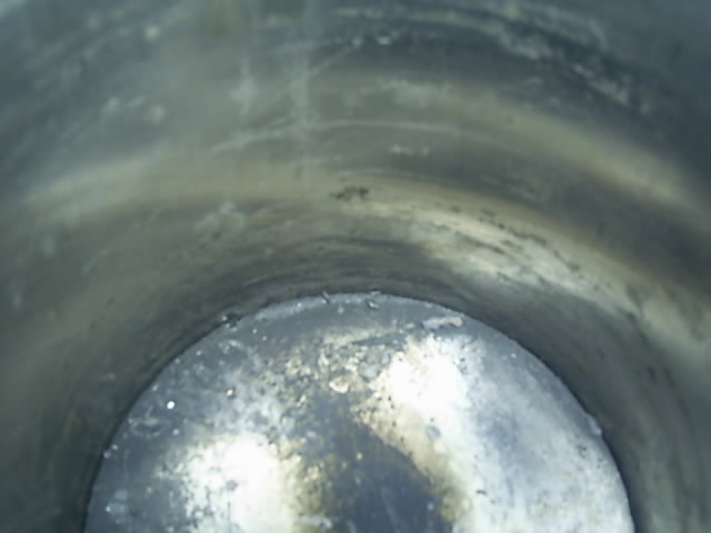

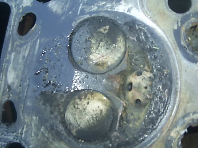

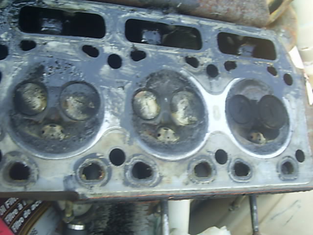

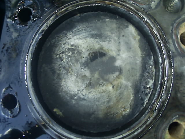

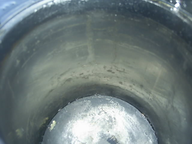

Well here is the scoop. Decided to adjust valves and noticed right away that the only cylinder that was any good was #3. I could spin motor over by the fan until cylinder #3 started compression stroke and I had to push down on valve spring to release pressure and finish adjusting valves. Did not have to do that for cylinder #1 or #2.
I assumed bad rings in #1 and #2. Tore head off this afternoon and WOW I cannot belive this thing actually ran and did not have major smoke issues and blowby.
Head is so cracked that I can see cracks with naked eye. The area between intake valve and injector is where crack is. Also the combustion chamber of Cy1 and Cy2 have large pits in it where it looks like some metal melted. Taking head to machine shop tomarrow to see if it is salvagabe. I kinda doubt it.
Piston #1 and #2 are toast. I will need new pistons. Liners in 1 and 2 are pitted and scratched. Could be saved but I will replace them too.
When I took my intake manifold off there are numbers and letters stamped on the inside--- 3T80J. Motor has 3T80D stamped on block. I believe the 3T80J is a John Deere motor.
Here is the issue WILL THE 3T80J HEAD FIT THE 3T80D block????? John Deere still makes the 3T80J head for the JD 850. Not sure of the price but if head cannot be saved I have to do something.
Photos of disaster attached.
NOW I KNOW WHY IT WAS HARD TO START!!! Can't believe it even ran like this and had loads of power (with Turbo).
Cylinder #3 was in PERFECT condtion but I am still going to replace rings.

The motor in the 850 was never made by Deere, nor was the head; they were made by Yanmar. The head for the 850 lists at $855. Even if the numbers cross, that's a lot of $$. I suggest you contact Fredricks Eqpmnt to see if it can be repaired. The worst you'll be out to find out is shipping, and I know they have a shop they send heads and blocks to that does remarkable work.
/ 2610D and Engine ISSUES!!! #3
Rock,
This goes all the way back to difficult starting, cold starting issues when you first started the turbo project.
Some pics of porosity and pitting may indicate ether/starting fluid damage from the previous owner.
How does the bottom end rod and main bearings look? It will be very interesting to see how the tractor's performance is after the overhaul...and before the turbo is refitted.

LMTC, thanks for the info. Fredricks is sending me a reman head $550 plus $450 core. Will get $450 back once I send in old head. Fredricks is a lifesaver. A new head at $855 plus $300 dollars worth of valves, springs, and such would have been over $1000 dollars. As it is, should only cost $550 plus shipping.
Mark, did not think of starting fluid causing the damage. I assumed engine got overheated. But it makes "CENTS" that rings went bad and previous owner used starting fluid to get things running. Wondering why cyl #3 looks so good though. Its as if it is brand new.

We've seen some boat anchors that were perfect candidates for overhaul IF the owners hadn't used ether. Unfortunately it's the go to tool when a simple ring (and valve job) is all it would take for another 3-4K hours of viable life.

Got pistons out today. Rod bearings look almost new, no copper color at all. Liners are out too. Cy 1 and Cy2 liners have the same melted spots as the head did. IE the very top of liner where liner touches head gasket.
There was antifreeze and water still in the block. It would not all drain out when I drained block. When I pulled liner #1 some coolant was released and drained onto my crank, DANG IT! Cleaned as best I could but I still hate that.
Was able to clean top portion of block where top of liner seats. How do you get to the lower portion to clean it?
