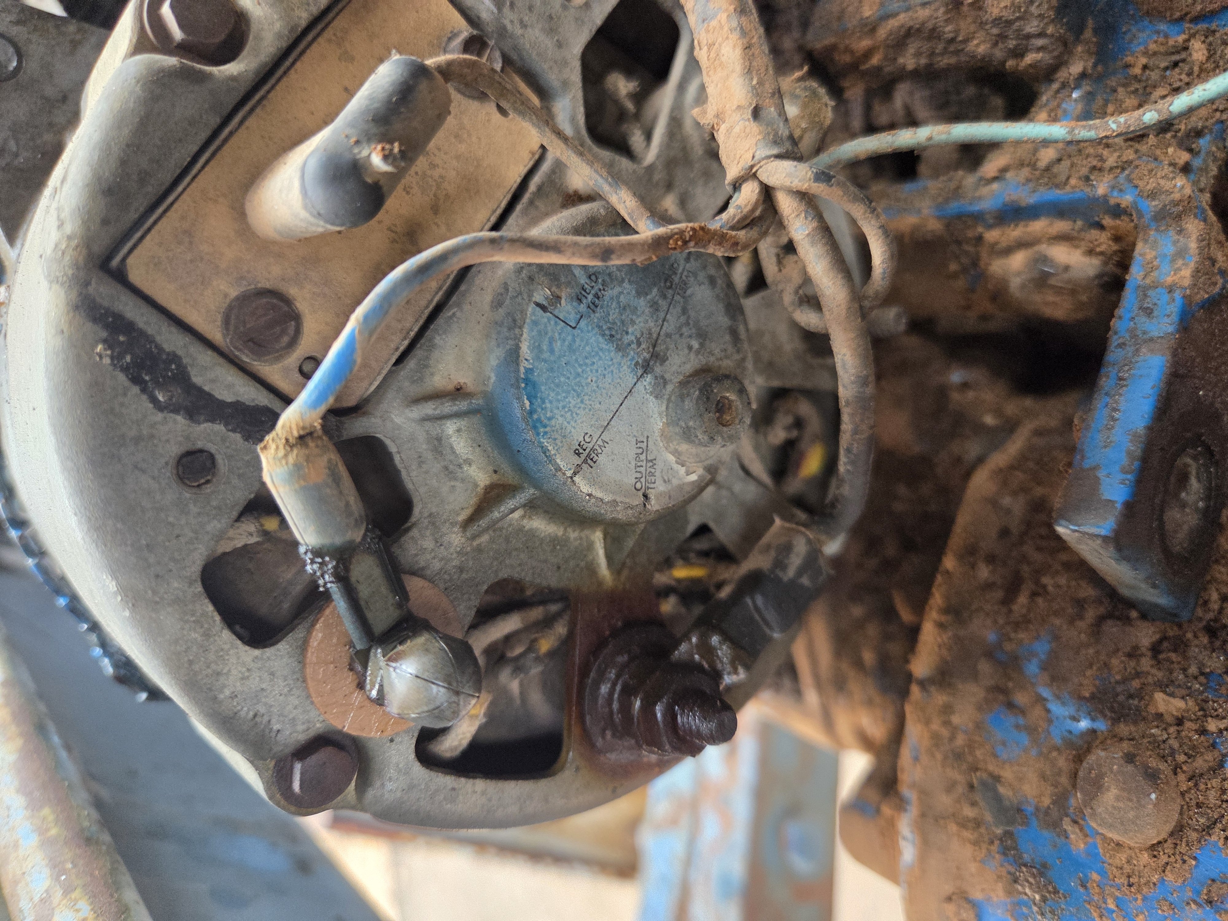

Ford 2600

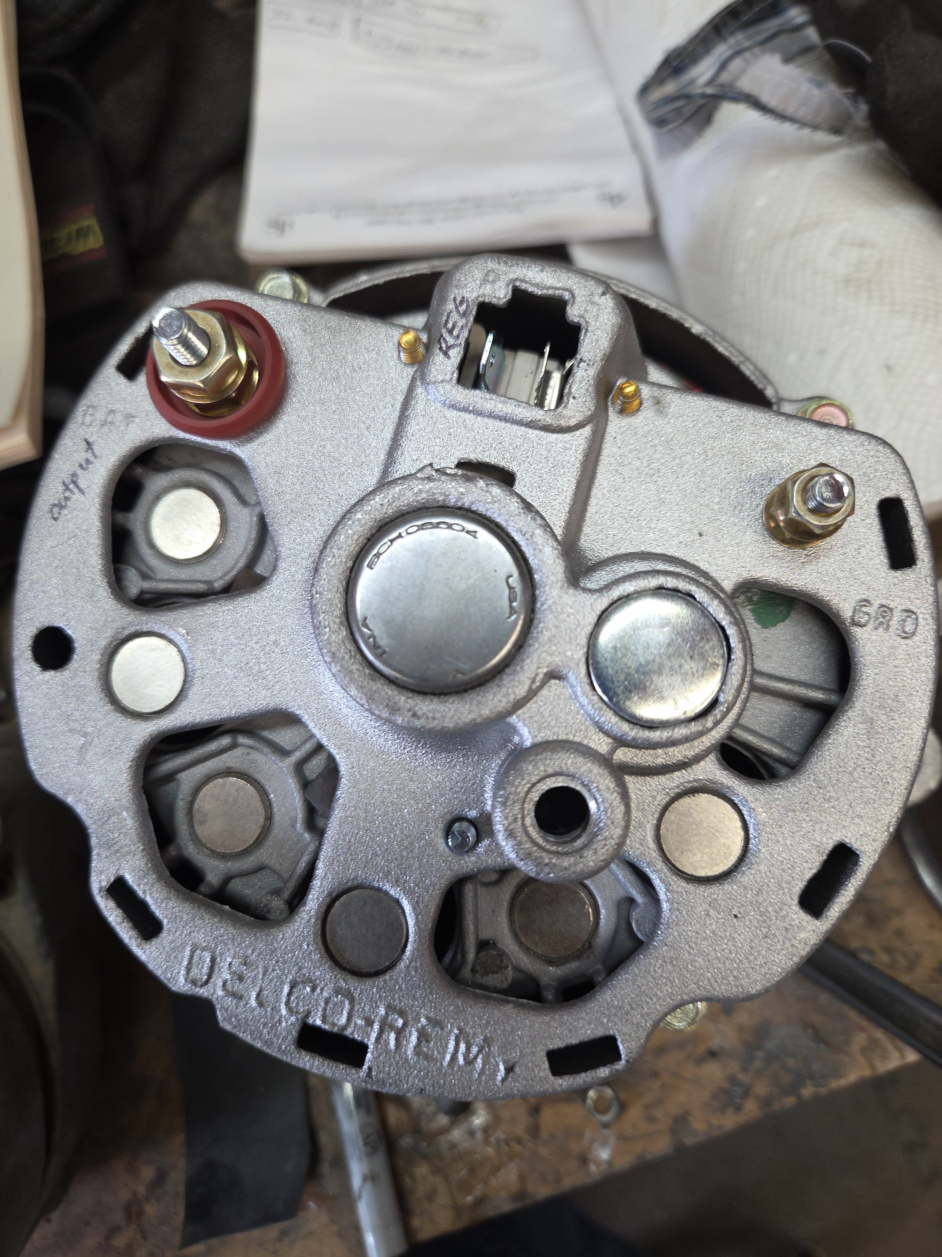

I have a 1973 2600, 3 cylinder gas tractor. I'm replacing the alternator and it tractor parts store sold me an alternator they say will fit but the wiring is different. Can someone assist me with the correct wiring?

It’s very possible it could be done and also possible that it just isn’t made for your present wiring. For me, I would return it and pursue the proper alternator. That just doesn’t look as simple as those one wire gm alternator
/ 2600 alternator #3
There's a difference between what will fit and what will work. You need more information on the new alternator identifying connections as well as info on the old one. Or you could make the adapters for a GM one wire alternator.

Wiring aside, the Delco style alternator will not fit in the same brackets as the Motorola you removed. Save yourself the trouble of changing brackets, probably the pulley and belt length as well. Just get the right style alternator. ASSUMING you have confirmed the alternator is bad, and it's not a regulator or wiring issue?
