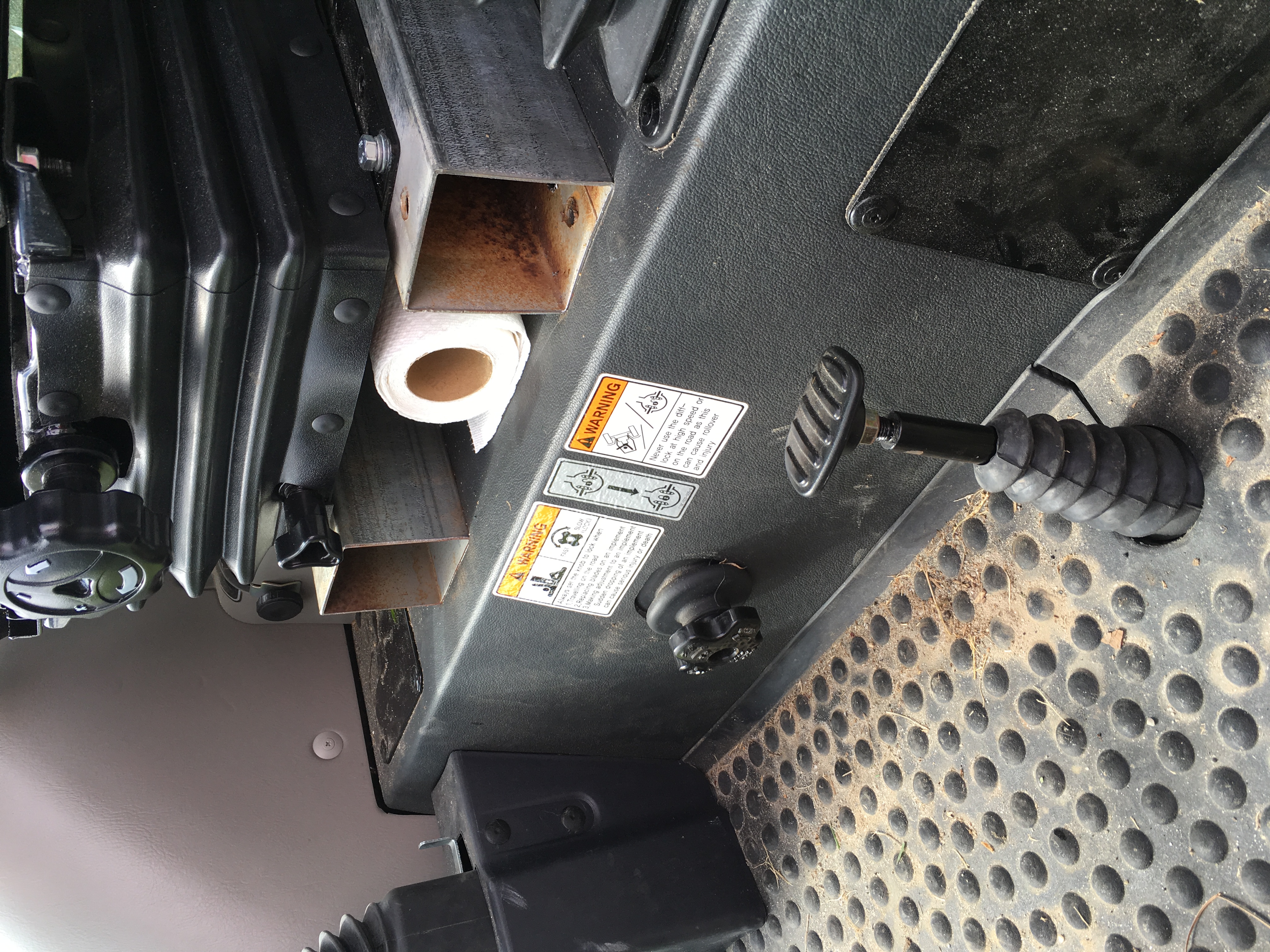

also be raising my seat up since at 6? my knees are higher than my butt. I致e already moved the seat back to the second set of holes and that helped. Like Jerry mentions, if it痴 not to your liking, change it, lol.
Tom
Check out this thread on the tractor seat height. It shows Jerry's risers and I also posted pics of mine. We both had opted to raise the seat 3" and it seems like that's the magic number. Just be sure to use the correct grade of bolts since they're a safety item. You don't want the seat breaking off with your butt seatbelted into it if you were to roll the tractor.
http://www.tractorbynet.com/forums/mahindra-owning-operating/362011-2555-hst-cab-seat.html

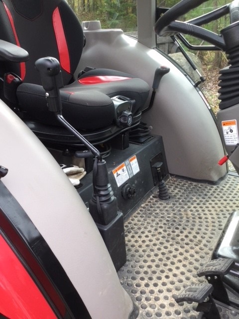

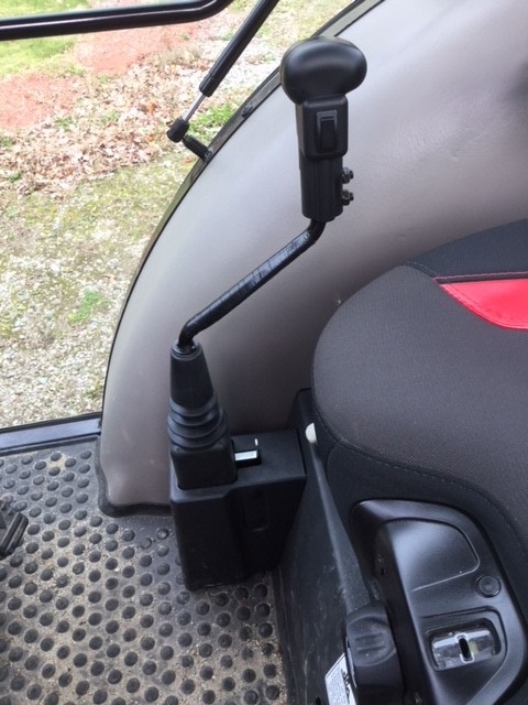

/ 2555 exhaust outlet
#12
I had the dealer do that prior to delivery. Amazed me that it was in what I considered the wrong position to begin with. But I知 sure they had a reason. I do wish I had gotten the front hydraulic outlet for a future grapple tho. Is that what you use yours for?
/ 2555 exhaust outlet #13
I would actually prefer the lever be straight and not bent but I'll leave it like this for now, might be a mod I do next spring. It is originally in the designed position because in the shuttle shift version there is another shifter where the blank-off plate is on that side.
My 3rd function is for my grapple and my snowplow.

works great on the loader control on a hydro but what about the shuttle?
You probably can't do it on the shuttle because of the extra shifter on that side. Maybe if you had a straight shaft for the loader instead of the standard bent one it might work but I don't know.
