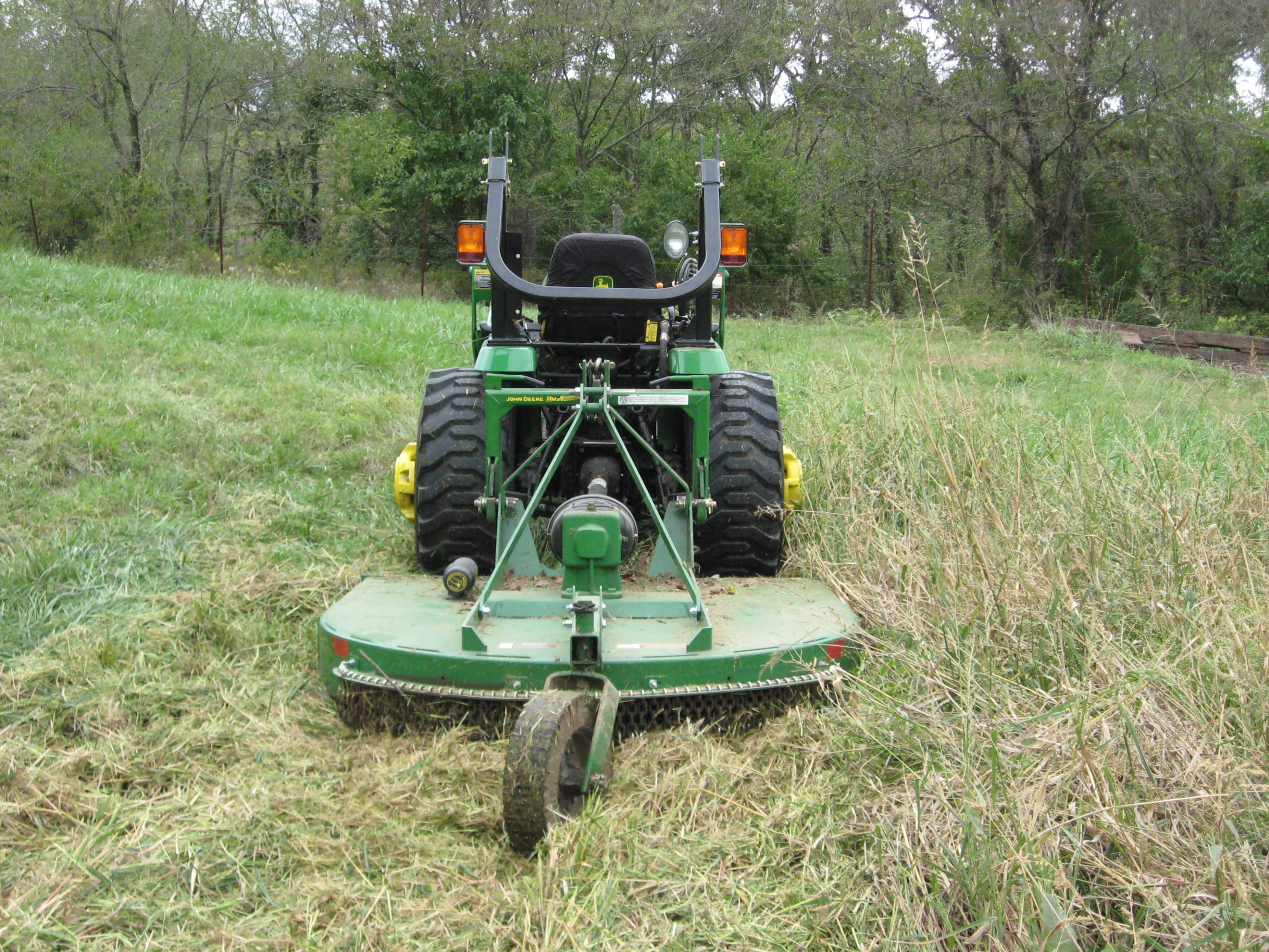

I run a 72 inch RFM and a 60 inch brush hog with my 2520 and it handles them fine for my use. If I were buying right now, I'd go for the 2720, just to have a little more on the PTO for good measure (this would be especially appreciated when operating my Wallenstein BX42 chipper...).
I also use a 60 inch box blade and 46 backhoe and haven't had any problems with it handling them.

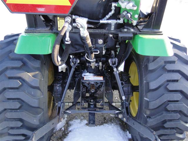

So....I finally got some pics and some description of the 2520 in question.
It appears that the tractor has Power Beyond and two sets of remotes installed on the back. Looks like somebody knows what they are doing here.
The category 1 on this size tractor continues to plague me with a question. Somehow I was led to beleive that the 3 point dimensions on these tractors are smaller (like some SUB-CUT's). True or false?
I sure would like him to be able to fit my 3 point implements to his tractor for his occasional needs.

I see that one has the old style lower link arms.
Doesn't seem to be any evidence of rubbing though.:confused:
As for the 3PT,I'm pretty sure they are the same. If you both had the I-Match,then you would be GTG for sure.:thumbsup:

Yeah....I don't see any stabilizer arms on this one? ....which has me concerned.
I have PAT's.....so maybe I have to give him a little sell-job on Pat's. :D:thumbsup: (I wish I could get I-match to work for me.....and I tried, but too many "funny-sized" old implements to get 'em all lined up. And I like my Pat's)
I see the stabilizer's-barely though. They are not arms but chains, the bolts just in front of where the lift arms connect is where they are attached.

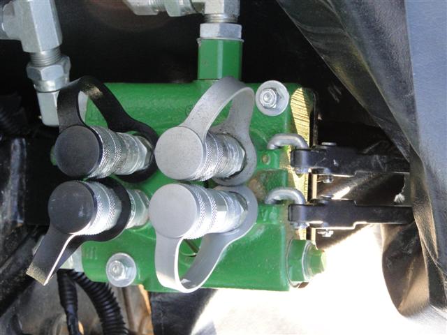

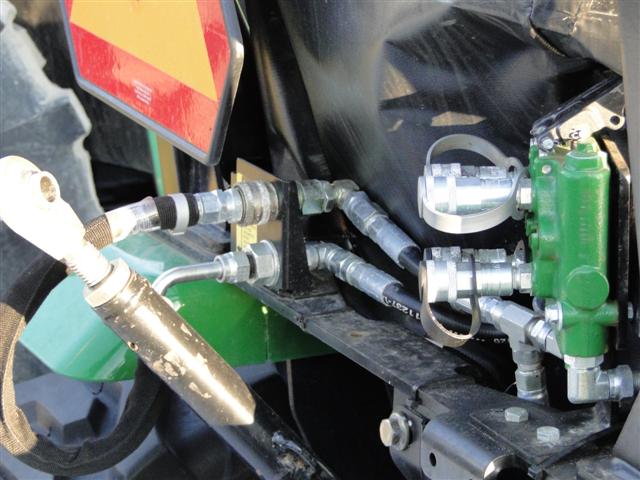

I am real curious to see better pictures of those remotes? Looks like it's well done though.

Thanks for the input on the chain stabiizers. I see 'em now....much like on my old 790. They work.
Here are a few more pics of the set up for the hydraulics. The soft cab blocks some of the pics but the hydraulics appear well done. I may make a drive tomorrow to look at this tractor. Too many unanswered questions.
(oops - that first pic is rotated 90 degrees to the right)

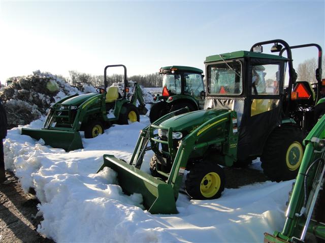

Yeah...I think I need to go look at this one. Still snow and cold around here....hope it has a block heater. ;) I just never became familiar with the 2x20 series.
This one needs some bucket hooks. (grin)

Looks Great!:thumbsup: I think that might be the 60" bucket and not the 54".
I know someone that can help with the hooks;)
