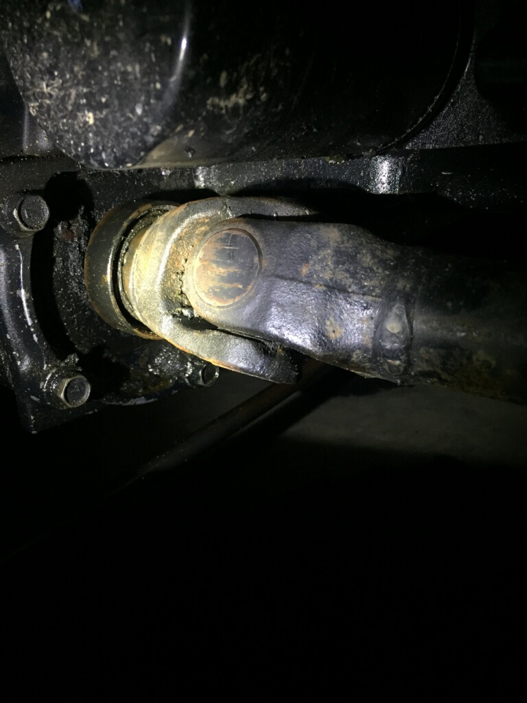

I am looking for a technical manual for a 2520 to see if replacing this leaking seal on my mid-mount PTO is a big deal and to try and figure out what the part number is.
Thanks in advance for any help you may offer

Which 2520(rowcrop or CUT)? If a CUT then I think mid pto seal is part # R91131 which is $4.20 from JD
/ 2520 leaking hydraulic fluid

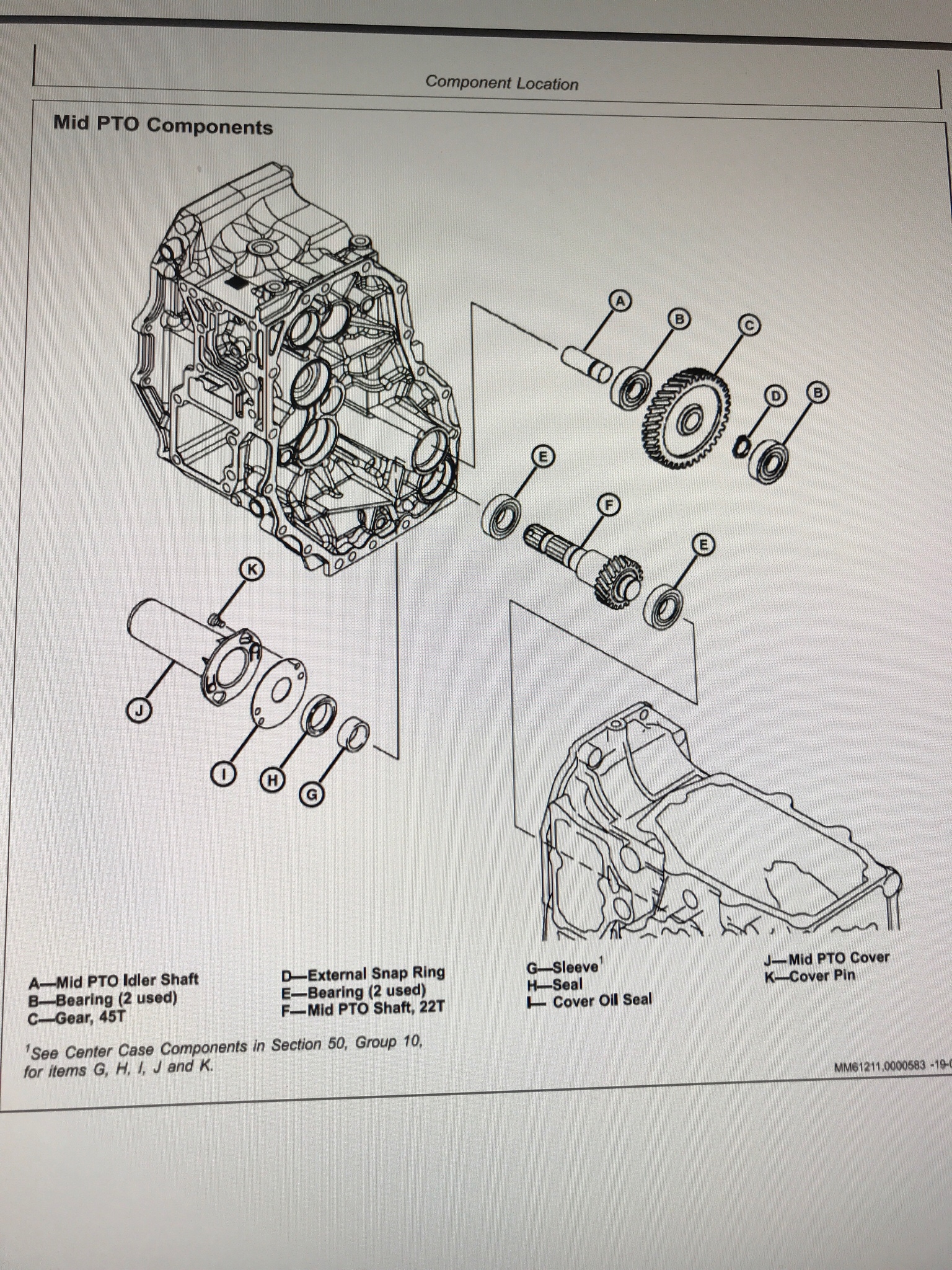

I just left the local JD dealer and he gave me seal # M800600 / and sleeve CHI4967 but didn't have either in stock.
/ 2520 leaking hydraulic fluid #7

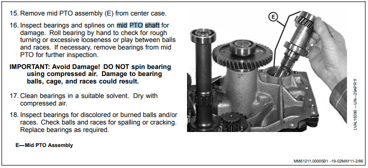

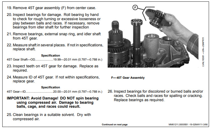

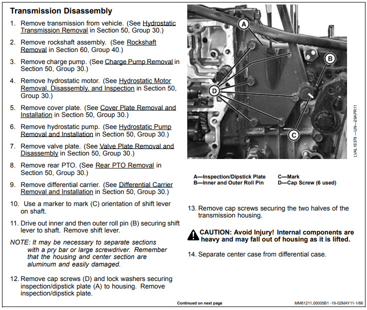

It looks like a pretty big deal to change. According to the tech manual it has to be disassembled from the inside after removing and splitting the transmission.

Are those bolts around the pto a removable plate? If so it might not be to hard.
I had to change the pto clutch on my 2520. If I remember correctly it was over 20 hours in labor just to disassemble to get to the part. Hope you don’t have to.

It looks like just the cover plate and the seal
It looks like the cover plate and the seal hopefully not a big deal. I ordered the seal and spacers and my neighbor will do it this weekend and hopefully will go well.

It was the cover plate and seal my neighbor helped me it took about 8 beers.
