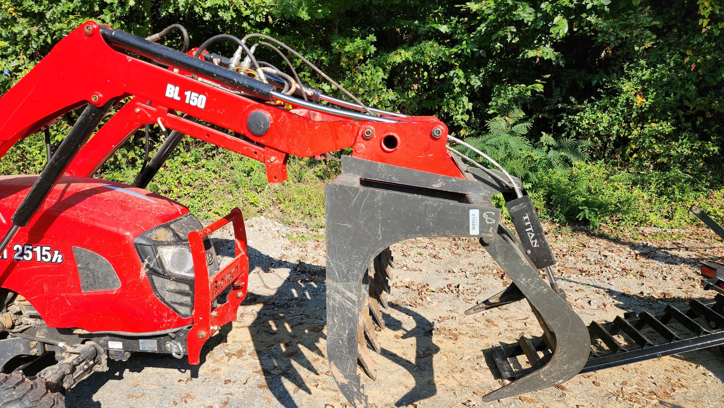

Was doing some grapple work today and bent a loader hydraulic for the tilt function. Is there any company out there that sells an upgraded set for these tractors. I am aware the BL150 loader is more prone to bending than others and I don't want to take the chance of bending another one and being down. Any help is appreciated!

I do not believe the BL150 is any more prone to bending a cylinder than any other loader with it’s capacity. Just do a quick search of bent loader cylinder and you will see many examples.
The issue is most people do not know or think about the stress they are placing on the cylinders doing certain task. Back dragging the bucket with the cylinder extended is a good example.
You could get larger Cylinders but then something else will become the weak link. You can have cylinders custom made as well.

Cylinder. I was helping a buddy clear brush and trees for a new driveway. I am aware of the hazards involved when using a grapple. I probably side loaded the grapple with a tree and bent it. I kept working till the cylinder just pooped out and puked its guts out.
I noticed branson did add some linkage to the loaders reducing the amount of stroke the cylinder has when the bucket is at full tilt. I have the non linkage version.
I noticed on Fakebook the bent loader hydraulics seems to be a common problem with the BL150 due to poor quality per the consensus. I'm accepting user abuse on my end. I was just curious if a aftermarket company made a better hydraulic to purchase if I am going to replace it.
I'll call Reed and Reed Tuesday and talk to parts and get some input. I'll probably just replace it with a factory part and move on.
I will say I put this tractor through its paces yesterday....even with the blown cylinder it really impressed me on its capabilities for this frame size.

Well it looks like I bent them both, one more than the other.

As long as the length is correct I see no issues with these cylinders. Just remember going to a bigger diameter will make the curl and dump slower. Likely not an issue but thought I would mention that.
At least with both cylinders bent it makes replacing with a different size more practical as both cylinders need to be the same size. Good luck and keep us posted on what you decide.

Update: The link I gave to the aftermarket cylinder is out of stock with no shipments in the near future. Reed and Reed is closed today so I called Mathis Tractor in Rome GA, great folks by the way, spoke with Robin at the parts counter. She is going to run these by the warranty department to see if they can be replaced. I'm 2 months past the loader warranty so it's a long shot. Branson in the past came through for me on past warranty issues. Cost for each hydraulic cylinder is $816 for each side.
If the loader warranty is a no go I will take them off the tractor and see if my hydraulic shop can fix them and or source me another set. Stay tuned.

Do you know what operation bent them? I could see it happening by going to pick up a log with the grapple pointed down, the lid hitting the log first which would apply pushing force on the curl cylinders.
/ 2515H Bent Loader hydraulics
#11
No. I am going to assume any operation at this point. I went into the weekend knowing these cylinders are prone to bending and used as much caution as one could while not being to hard on the tractor and trying to use it for what it's made for. I didn't try any hero stuff or hey look what my tractor can do. It was simple loads lifting and dropping. No back dragging of any kind. It's kind of one of those things when you look at how you worked the tractor and what happened you say to yourself " This should not have bent for what little I put it through. I've been on tractors for over 20 years and feel I know how to operate one. At this point I think my old 2400H could have handled this past weekend just fine without issues. You shouldn't have to tip toe around using your FEL and worry about stuff like this when your just lifting and dropping. I may have side loaded a few times but even then the ground held some of the weight as I didn't lift anything until I felt it was evenly loaded in the grapple.

OK I have an update, kinda long but it has a good ending. I got froggy did some more searching online and came across a company called Northern Hydraulic. I spoke with their customer service / Sales dept.... very nice, eager to help, and knowledgeable guys. Northern Hydraulic is a reseller for the Massiger line so they can't get the part since they don't actually stock any product.
The sales rep did some digging and found another company called "Long" based here in the states, the sales rep said its a good brand he has good luck with. He found pretty much the same hydraulic cylinder that matches specs on the Massiger brand. In stock shipped to my door $750 for the pair. Looking better than almost $1800 from the dealer.
I got a call today from Robin with Mathis Tractor and said Branson is willing to warranty out my bent cylinders. I sent in the same pictures I posted here for Branson to review.
My question to you guys as tractor guys what would you do..... money is not the conern here its the time of not being down I am after. Should I put the replacement cylinders on or get the Long brand and go with a beefier hydraulic? I still have a lot of land clearing to do that involves more grapple work.
Anyhow this is where I am at. I'm leaning on with going with Longs and keeping the replacements as a backup replacement.....kinda like an extra belt for your car. Thoughts?

I got the name of the aftermarket hydraulics wrong its called Chief LD. Here is the spec sheet. I actually found them cheaper on Farm and ranch depot. Around $575 shipped.
My replacement stock cylinders will be here tomorrow so I am going to put those on the tractor for now to get back up and running. The hydraulic ports on the Chief cylinders are top mounted vs side like the branson cylinders and will require a longer hose on one side due to the ports being in a different spot. I'm also not sure if the Chiefs are plug and play with having SAE 8 ports, I am hydraulic illiterate when it comes to fittings and sizes.
I plan on ordering the chiefs and taking to the hydro shop here locally and getting the hose and fittings I need to make it plug and play. I'll keep yall posted in the replacements.
