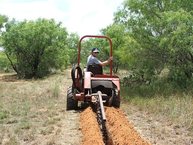

I'm having my new neighbor's dad dig me a trench with a backhoe. I plan to specify 20-24" deep. Good info on the gopher stuff, I didn't know they could eat through PVC.
