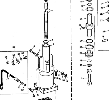

Where is the steering valve?
/ 2440 hydraulic test ports #10
Under the steering wheel. To check for internal leakage in steering valve one needs to disconnect hose(key 34) then put cap on supply line that goes from frt pump to clutch housing.

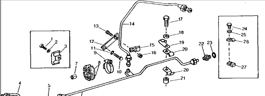

Tx Jim where is the clutch housing line. Ive finally got around to trying to figure this out. Im having a hard time finding it.
/ 2440 hydraulic test ports #12
Power steering supply line(key 14) is on RH side of tractor in front of brake valve pedals.
Thank you sir. I'll find these when it cools down this even and grab some plugs for both lines
