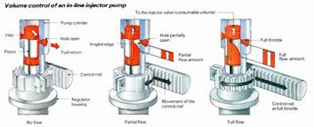

Hello I have a question about my 2003 2420 farm pro tractor. When I start the engine it goes to a full throttle and the only way to shut it down is there is a metal handle located under the steering wheel that I pulled out and turned and it shut it down. Would this be a injector pump problem? None of the speed levers are stuck as far as I can tell. Any ideas? Thanks
/ 2420 injection pump ? #15
Sounds like the rack is stuck in your injector pump's governor assembly. You can carefully clean this portion of the assembly, but don't mess with the injector pump part or you'll be buying a new pump. Your tractor should have a kill handle somewhere under the dash - what you're using sounds more like the compression release. The kill handle shuts off the fuel flow to the injector pump and on my tractor it is a black plastic T-shaped knob on a cable to the left of the steering column, below the dash. If your injector pump is on the right side of your engine the kill handle will be on the same side, probably. If you can't ind it any other ay, start at the injector pump and trace back the cables/linkages from the governor to the throttle(s) - it will be the "extra" one.
/ 2420 injection pump ? #16
I agree with Rich. Apparently you actuated the compression release. That isn't a recommended method to shut down the engine.
In the illustration shown, the "control rod" is commonly referred to as the rack because of the rack and pinion type of gearing. In your case the rack sounds like it is stuck somewhere in or near the full fuel position.
