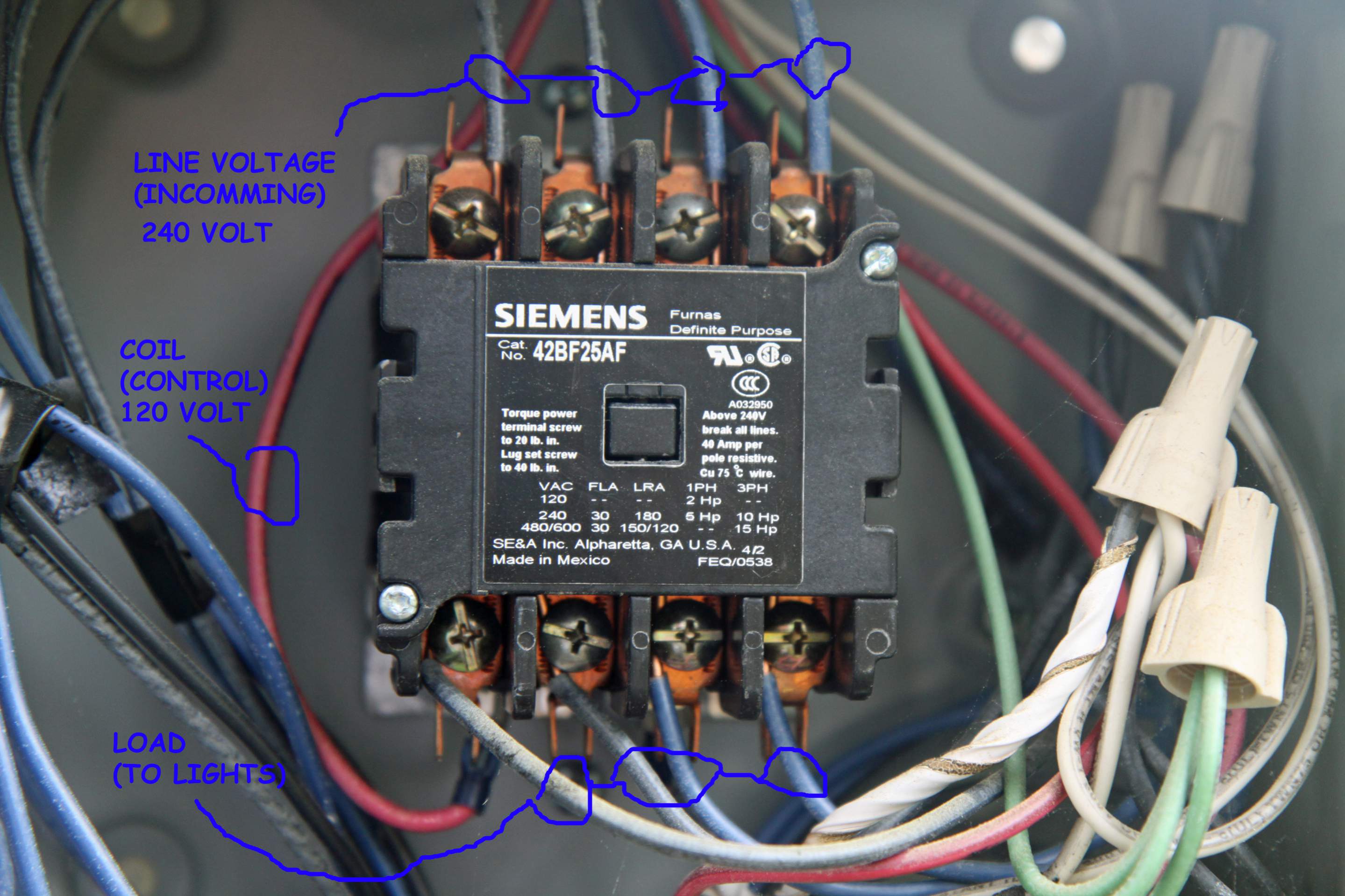

/ 240V 3 way switching..... #4
I am an electrician, and whenever i find a 240 volt light requiring 3 way, 4 way, etc wiring i use a contactor.
A general lighting contactor only cost in the range of $40.00 and is real easy to install. My arena uses two separate 240 volt , 20 amp circuits to light a combination of 1000 watt and 250 watt MH lights. I simply wired all of them to a 4 pole contactor that has a 120 volt coil. Then i wire the coil as you would wire a normal 3 way circuit. You can wire the contactor with a 15 amp circuit and 14 ga wire to save $$$ on wire.

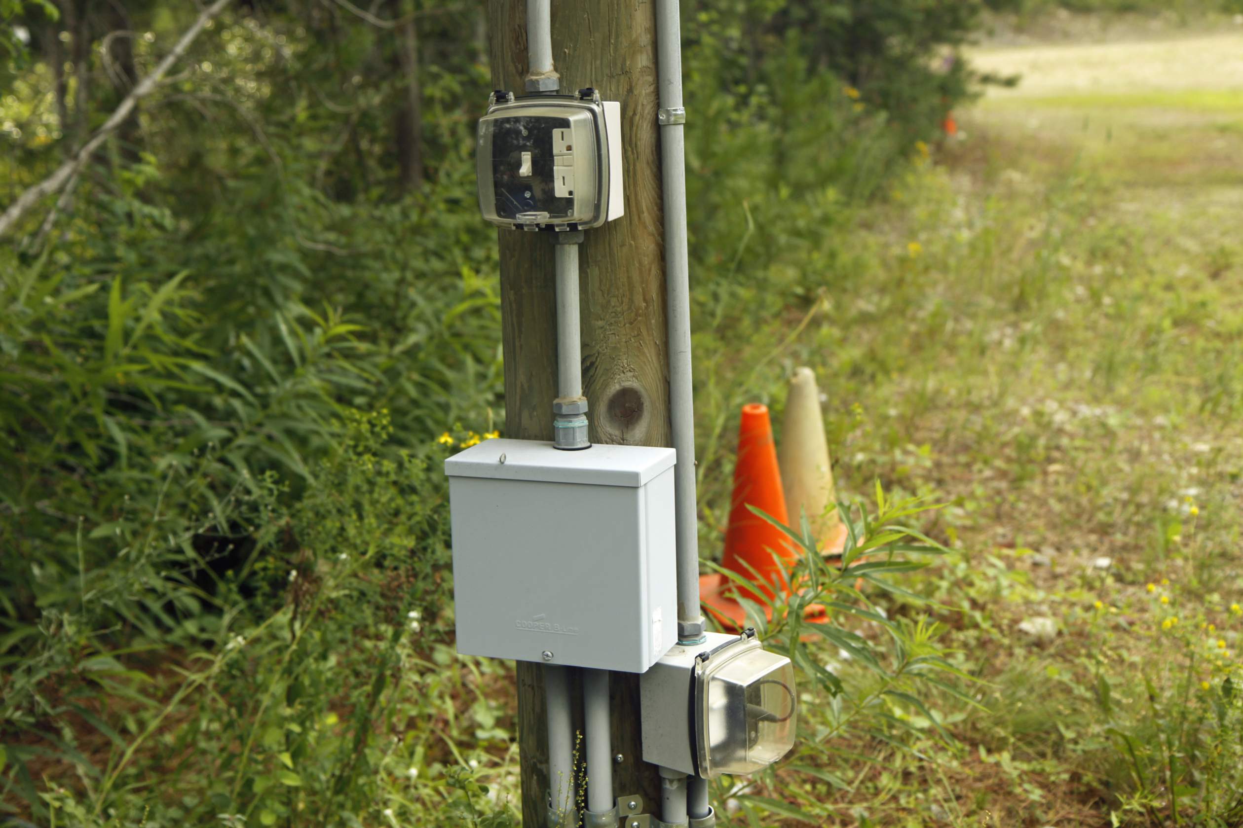

/ 240V 3 way switching..... #9
Ok, here goes contactor basic wiring 101.
On this application i placed contactor inside waterproof box on arena light pole. It has two separate 220 volt incomming circuits and two lighting load 220 circuits (output). It also has a 120 volt control feed (coil circuit). The 120 feed closes the contactor and that completes the 4 circuits.
I have a cabinet shop io wired a few years back that had 70 - 200 watt light fixtures. All controlled by 1 toggle switch 3-wayewd between two separate entry doors. With a single flip of one toggle switch, 14,000 watts of lighting is turned on and off.
