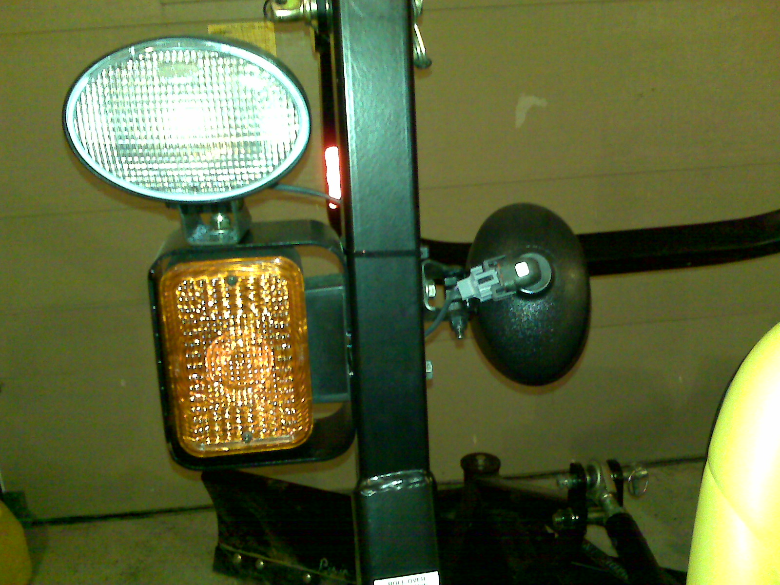

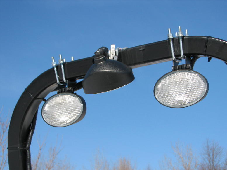

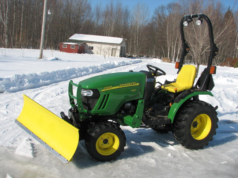

PCABE5 said:
Do you have any pictures of your setup?
I've attached some pics.
In the last shot you can see I ran the wires a little differently than JD suggests. I used the small gap between the ROPS and light housings that mounting the brush guards created to run the wires through the hole on the outside of the ROPS as opposed to snaking tubing around the ROPS to the inside hole. It just looked a little cleaner to me.

I like how you installed these to provide light in both directions but leaving the ability to lower the ROPS without affecting the lights. I know you said that you needed this to get in your garage but I need the same flexibility when mowing around some trees. Good job in triming out the wires to look factory installed.
