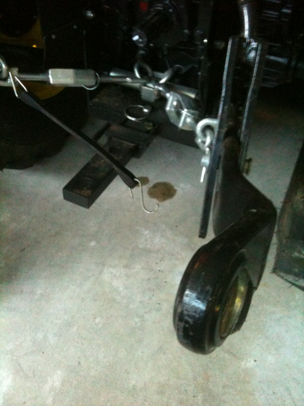

Have a few small drips under the rear end that happen after use. It must happen over the night. I am **** with my stuff - the tractor has 20 hours.
Any thoughts?
Josh

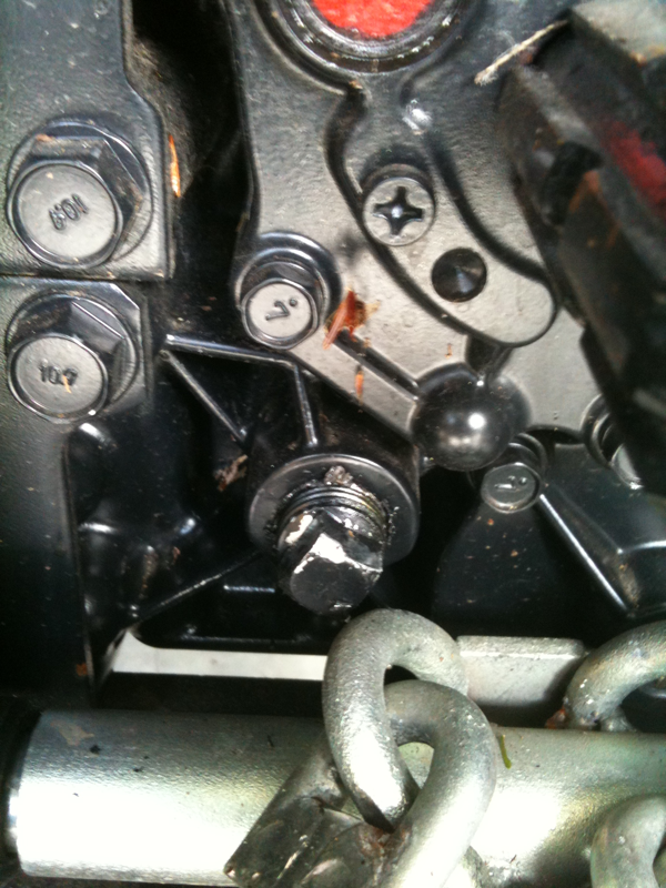

I want to fix it. Having trouble finding the source.
/ 2320 rear leak?
Found and fixed. So the 3 pt hitch hits the rear drain plug and loosens it? Really?
All fluids are fine. Anyone else have this issue?
