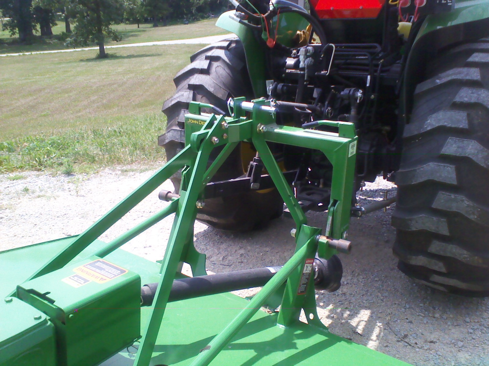

I agree with Arlen, very easy with a helper, I wouldn't risk injury trying to do it alone with a bum shoulder. Under normal circumstances, I pick it up and rest it over the lift arm swivel balls, then lean it in to attach the top link to steady it. Then lift each side to align the pins and you are done.

More to scale of a 2320 here a picture of the x749 and 4520 both with IMatch and my landplanes. For clevis style implements you need simple bushings as on the smaller plane in second picture, for the popular open ended single attachment point pins you need the quick hitch adaptors with the shoulders on the pin ends. These are installed over the existing pins and secured in place with a roll pin provided. I prefer the clevis style because it is stonger and more durable all new stuff I build will have the clevis mount.

Here is a picture of the knock off of Pats Easy change. The real advantage it does give is the fact that it should fit all equipment and all you have to do is adjust your top link. But because of the extension, you may need a longer top link. My factory top link does work but it is almost adjusted all the way out.

The proper bushings are pinned on, so moving them is not a easy task. See the link I posted above.

If your lower pins are cantilevered (attached only on one side) the pin on adapter is correct to use but if you have through pins (like on a box blades) the sleeves are correct (and a lot cheaper).

I had completely misunderstood how the bushings work, talk about a picture being worth a thousand words you guys gave me the equivalent of an instruction manual. Thank you, now I won't make an idiot of myself when I go to the JD Dealer. I usually look over the back of the tractor when hooking things up so installing the top link myself would not be much of a drawback. I am leaning toward the Pat's Easy Change but do want to look at the Imatch in person. If the dealer has one installed I'll hop on and see how easy it is to use.
