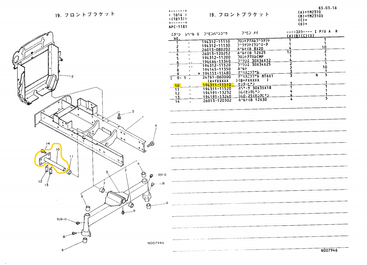

Neighbor and I figured it out.
The front post is bent.
Not sure what the previous owner hit, but OUCH!
Picture is the part that was the challenge.
194311-11510
The service manual (even in Japanese) was HELPFUL :)
Thank you!
+ James

Plus, you can take a screen shot image in the Japanese manual, upload them and read the translation in English on these 2 sites:
Translate an image or Translate text from photos from English and other languages – Yandex.Translate
Another really helpful thing with the parts manuals is this ...
Look at the image, get the part number. Type the number into a search engine. Something typically shows up in English to tell you what the part is called.
194311-11510 = PIN CENTER -0
The first part of the number could mean the area of the tractor. In this case suspension. The last part related to the sequence part number. And if the part number ends in a zero, then it's original. Other numbers means it was superseded by a revision or an alternative part is available.
And the part 194311-11510 is a typical one Yanmar uses. It's on the US domestic YM Series models too.
