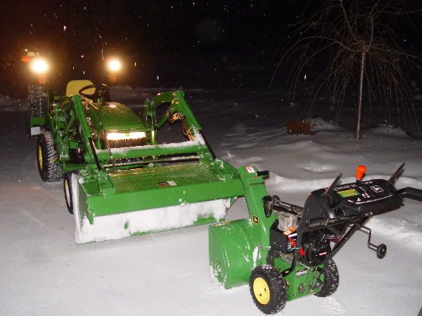

I have the 2305 with both the loader and blower.
1*I keep the blower mounted during the winter with the loader standing by.
2*If I need to manage built up snow, it only takes about 3* 5 minutes to dismount the blower and slap on the loader .
http://s283.photobucket.com/albums/kk286/lb59/?action=view&current=100_2316.jpg
1*I kep this snow remover mounted 12 months a year.
2*I keep this FEL connected 12 months a year.
3*Is this 5 minutes inside of a nice warm building?
Since my fel stays on the tractor it takes O minutes to swap the FEL.
