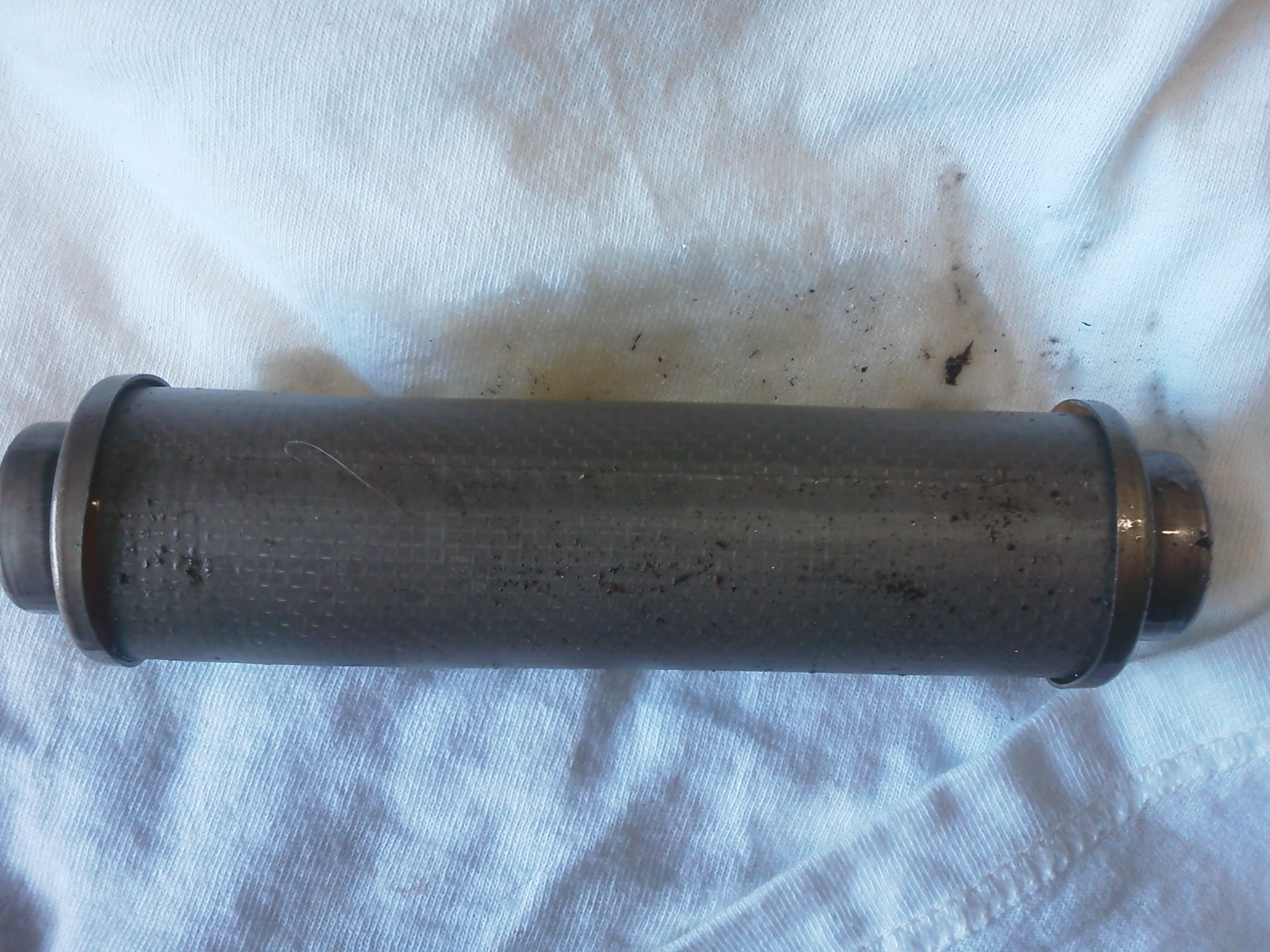

Anyhow hydro fan broke and they used in for 30-40 hours with it broke I figure. Fluid is fried to dark brown or black. dampening control is bent, drive shaft bent. Had that fixed and put in new U-joints. to my surprise with 900 hours they were fine but I replaced them anyway since it was apart. Change the fluid, filter and cleaned the screen all nasty. Just did my annual maintenance not long ago and changed the oil, filter, air filter and greased her up. Keep in mind the hydro fluid was just changed last yr as part of the reg maintenance.

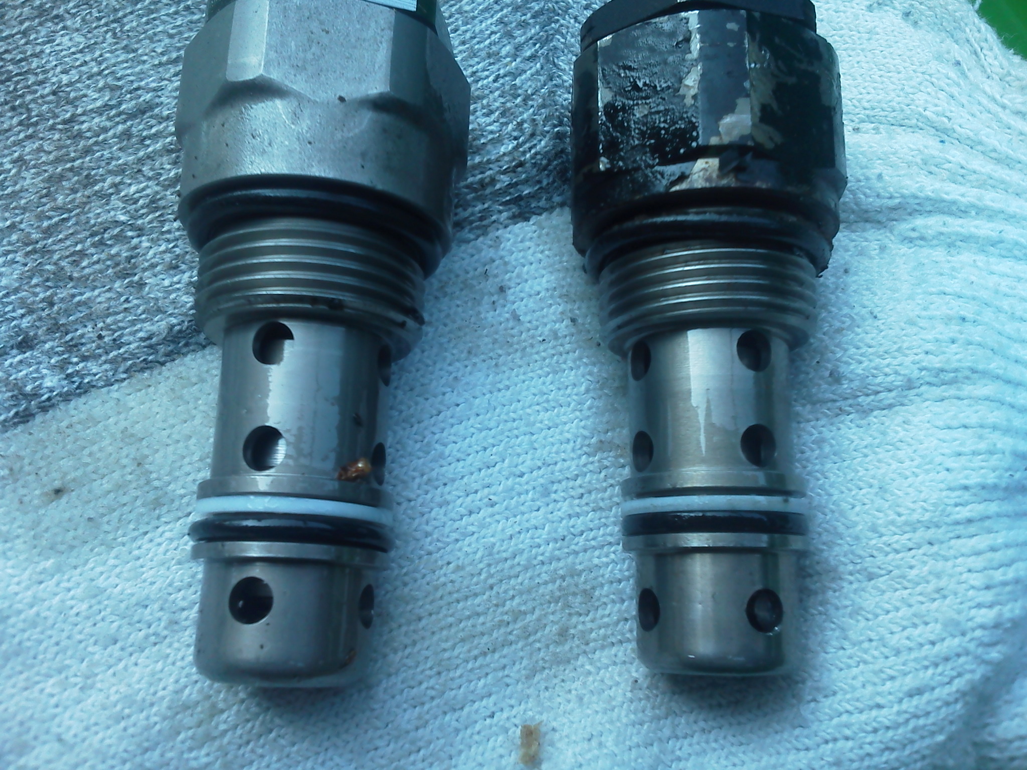

Another question about JD pricing? I've been looking for part# LVA801209 and understand it's been replaced by LVA 803403. But I can still find the original on line in several places for as little as $250.00. Yet the new number over $600.00.
What's the difference and which do I have in a 2006 2305?
/ 2305 Power loss?
Per the tech manual:
Wheels rotate in one direction only.
a. Forward or reverse relief valve malfunction. Swap forward and reverse relief valves to diagnose and isolate problem.
b. Pedal linkage damaged or broken.
Now to figure the difference in the new part numbers and price.

OK I do think I have figured out the problem.
After switching out the forward and reverse valves I now have ground speed again, Hard to tell but I would figure 90%, ran around the yard twice with the mower cutting and where it's been bogging down it barely bogged but the grass was wet so. I asked around about the new part number and the old and was told if I could find the old go for it so I did from a JD parts store on line. $250.00 compared to $608.00. We'll see.
Before I put the new valve in I will be changing the fluid, filter and cleaning the screen again!
Anyway since I have it all apart I'm going to give it a like new detail which I haven't done in two years. For ten+ yrs old she still looks like new!!!!

IMG_20160910_110252.jpgIMG_20160910_112245.jpgOK All back together and back to normal. The on-line JD Parts store was a scam bait and switch. Two days after putting in the order and paying I received an E-Mail saying the part was no longer available and replaced with the new part for 3x's as much of course. I got a refund and went to the JD store here in SC and he cut me a good deal I guess $489.50 instead of $560.00.
I changed the fluid and filter and cleaned the screen again and was surprised it was still dirty, I guess that's from what I couldn't get out from draining it because it says 3.4 gallons but only took 3 gallons and about a pint.
As far as the part there is a physical difference as you can see but the only difference I could see was the O-Ring was beefy on the new one and the old one it was flat and used up?

Are you telling us that just 1 of the parts on the left costs $489.50 ???
/ 2305 Power loss?
#14
Yes and that was a good price! The JD website has it at $609.51 plus tax. I kind of had to tell the guy how much I spent there and that I traveled there three times from an hour away. The one on the left is the new one.
