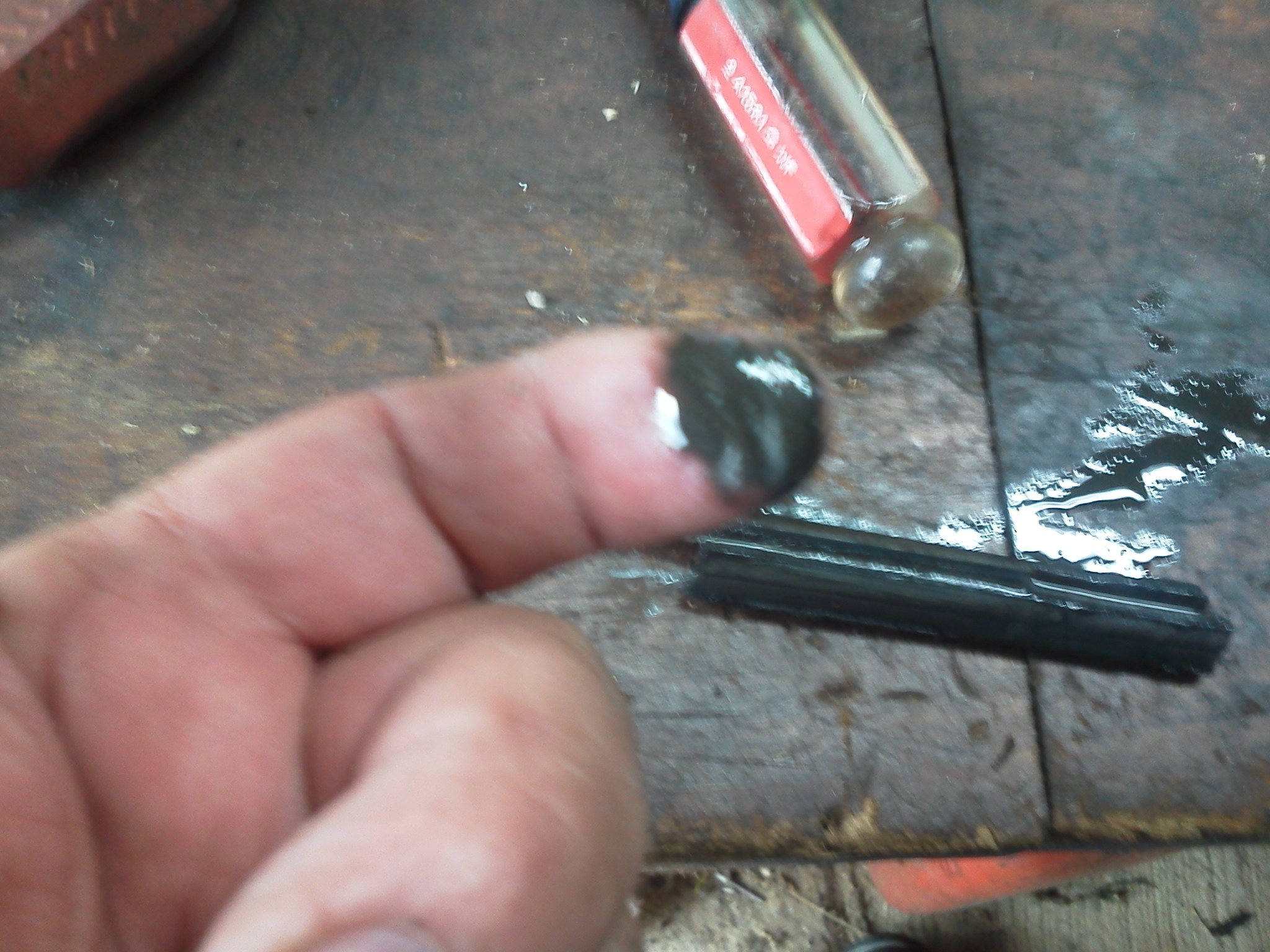

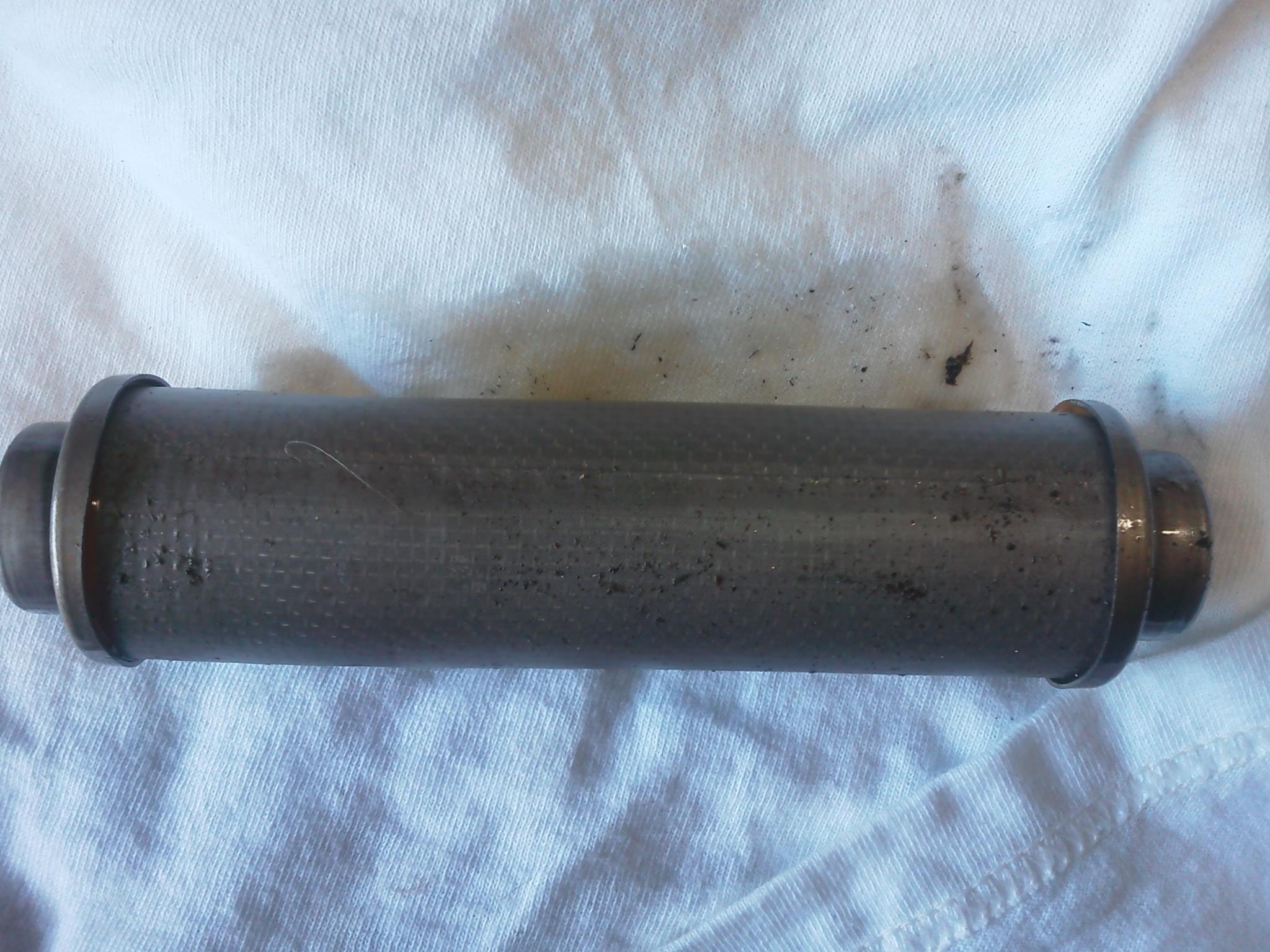

Anyhow hydro fan broke and they used in for 30-40 hours with it broke I figure. Fluid is fried to dark brown or black. dampening control is bent, drive shaft bent. Had that fixed and put in new U-joints. to my surprise with 900 hours they were fine but I replaced them anyway since it was apart. Change the fluid, filter and cleaned the screen all nasty. Just did my annual maintenance not long ago and changed the oil, filter, air filter and greased her up. Keep in mind the hydro fluid was just changed last yr as part of the reg maintenance.

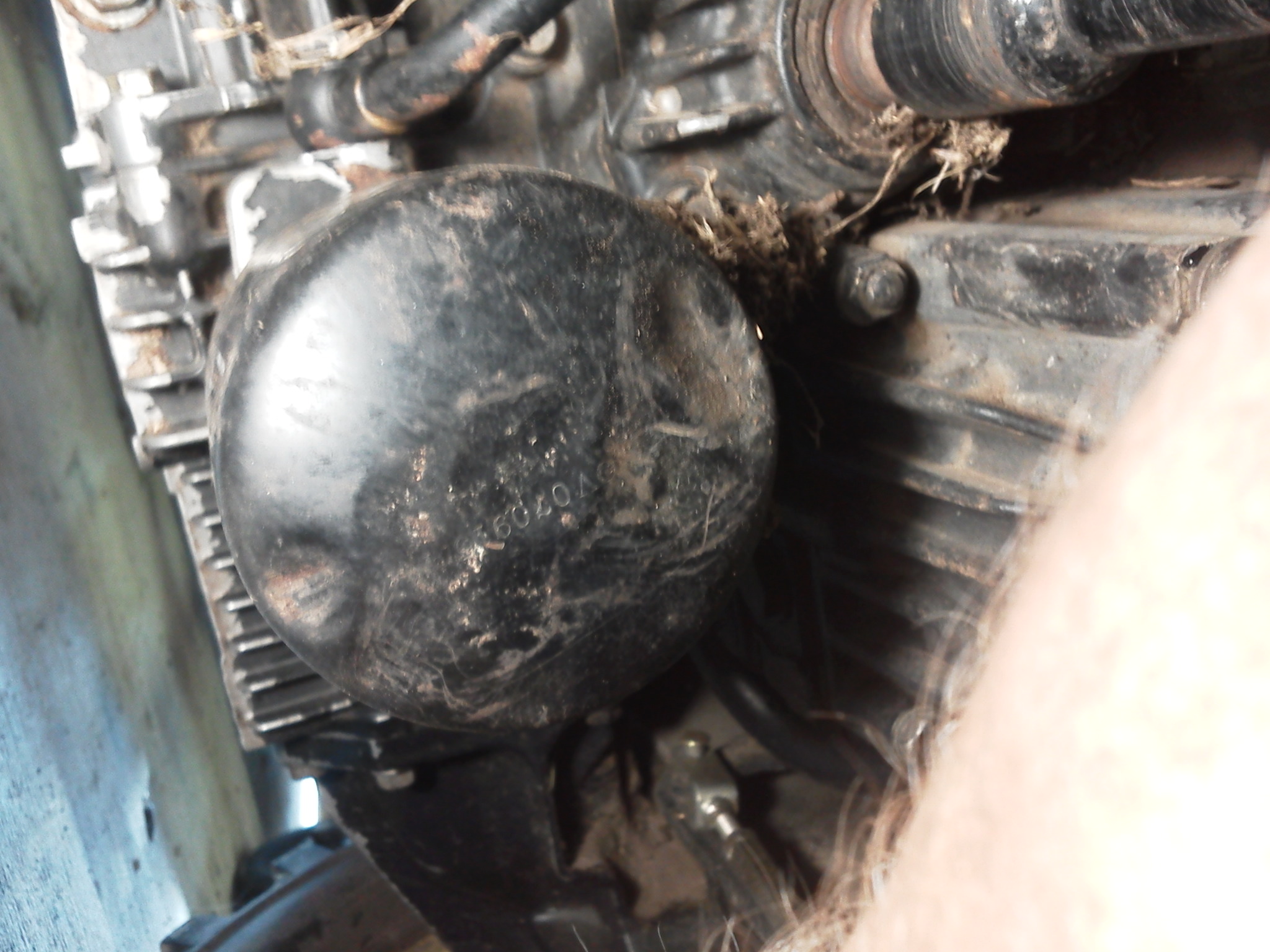

The pile of crud was just what I could reach to pull out on top of the hydro pump by all the linkage. I blow it out or hose it out every few times I use it and spray the linkage with lithium grease and it's worked for me more than 10 years now, others just don't respect things I figure.

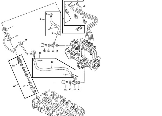

Check to be sure fuel return lines(key 20 & 22)are not blocked IE is excess fuel being returned to tank?

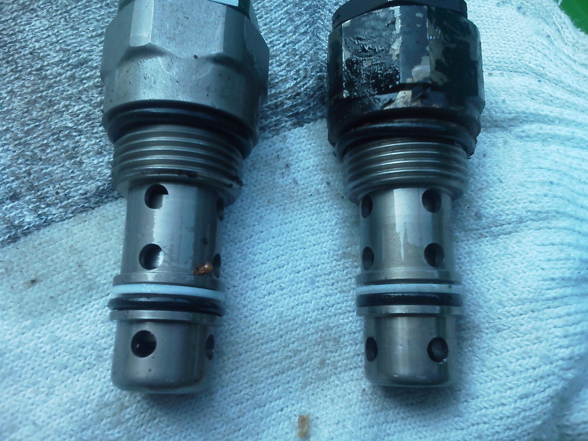

Per the tech manual:
Wheels rotate in one direction only.
a. Forward or reverse relief valve malfunction. Swap forward and reverse relief valves to diagnose and isolate problem.

I don't have good news for you. First, I'm surprised the fan lasted as long as it did. Heat, age, and debris cause them to break. Down here in the heat they don't last but maybe 3 - 4 years.
Looking at the oil on your finger, and the screen filter, there are problems. If if were mine, I'd start dis assembling the transmission to find out what is going out. Long ago I had started a thread on the 2305 we had at work. I remember that the tranny castings were up revved to include a beefier bearing support for one of the shafts. The one at work ended up with a major tranny malfunction and the boss traded it in after it was torn down at the dealership. Ultimately, I believe your problem exists within the tranny.

After switching out the forward and reverse valves I now have ground speed again, Hard to tell but I would figure 90%, ran around the yard twice with the mower cutting and where it's been bogging down it barely bogged but the grass was wet so. I asked around about the new part number and the old and was told if I could find the old go for it so I did from a JD parts store on line. $250.00 compared to $608.00. We'll see.

IMG_20160910_110252.jpgIMG_20160910_112245.jpgOK All back together and back to normal. The on-line JD Parts store was a scam bait and switch. Two days after putting in the order and paying I received an E-Mail saying the part was no longer available and replaced with the new part for 3x's as much of course. I got a refund and went to the JD store here in SC and he cut me a good deal I guess $489.50 instead of $560.00.
I changed the fluid and filter and cleaned the screen again and was surprised it was still dirty, I guess that's from what I couldn't get out from draining it because it says 3.4 gallons but only took 3 gallons and about a pint.
As far as the part there is a physical difference as you can see but the only difference I could see was the O-Ring was beefy on the new one and the old one it was flat and used up?

Are you telling us that just 1 of the parts on the left costs $489.50 ???
/ 2305 Power loss?
#14
Yes and that was a good price! The JD website has it at $609.51 plus tax. I kind of had to tell the guy how much I spent there and that I traveled there three times from an hour away. The one on the left is the new one.
