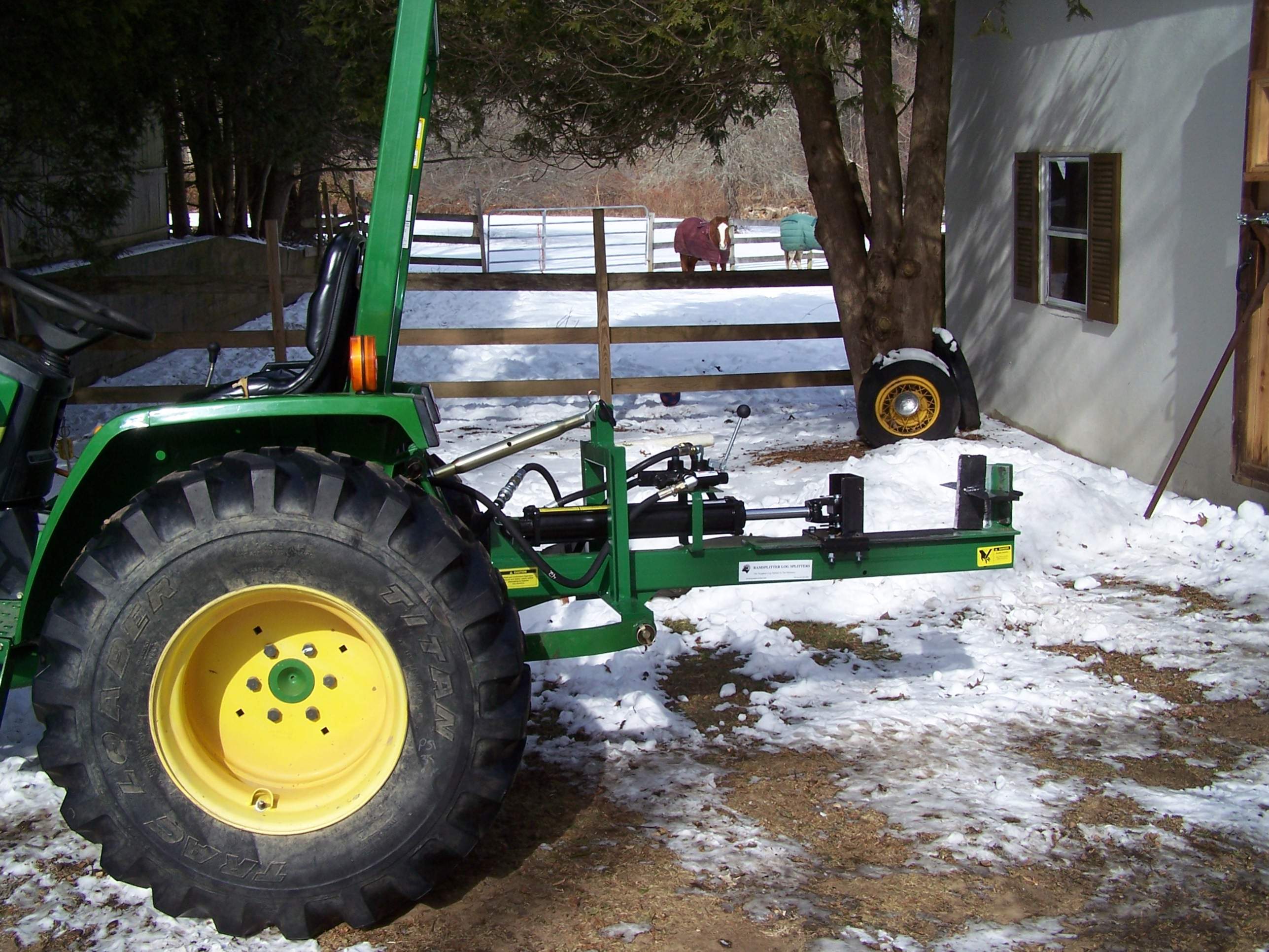

2 quick thoughts, 1. I like the steel wings that come with the complete unit, saves toes and allows to stage logs
2. worry about safety, with a remote operator and some one else loading the splitter.....

Sorry it took so long, Pics of logsplitter in action, and the tractor dressed for winter. Fred

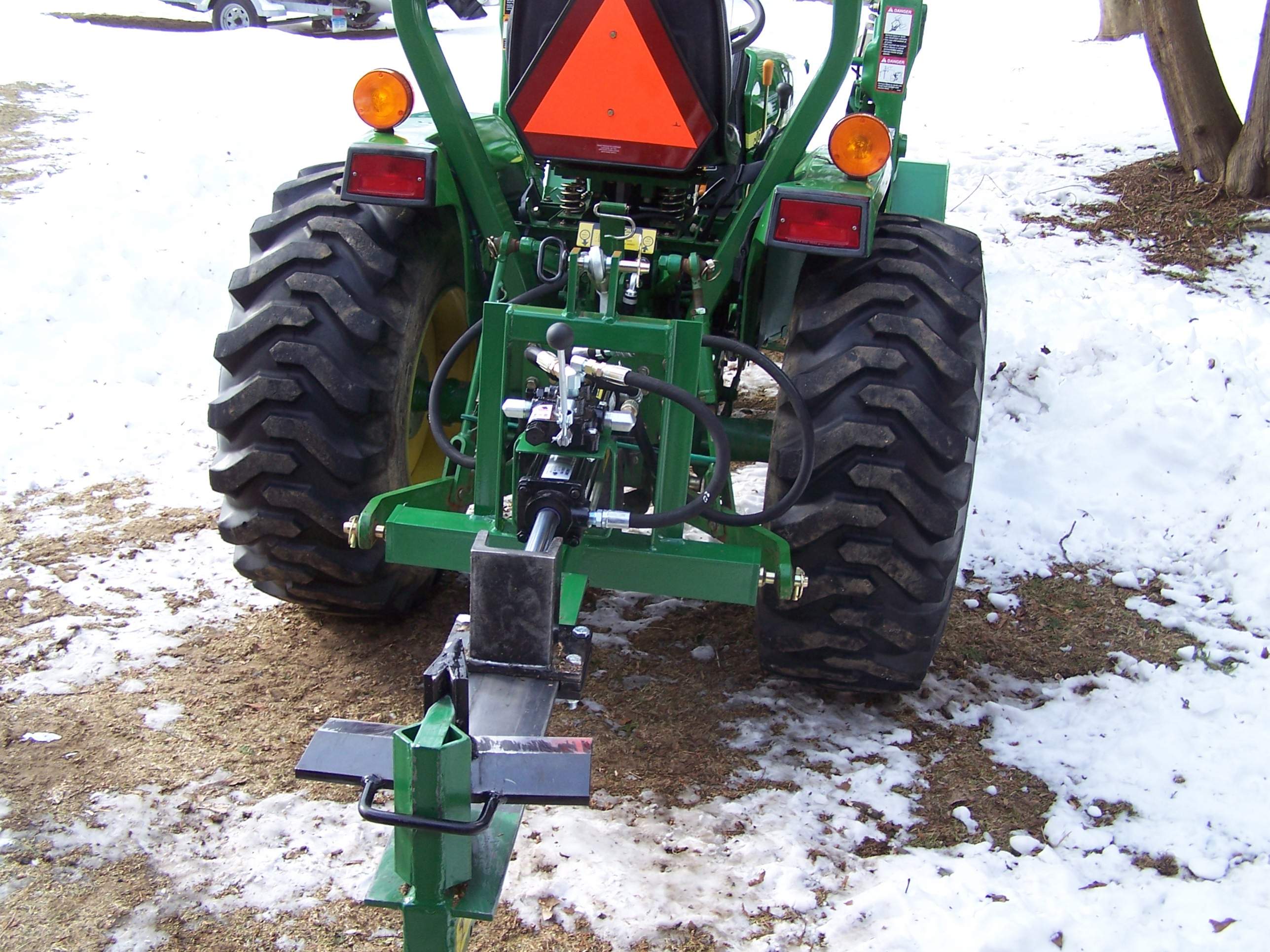

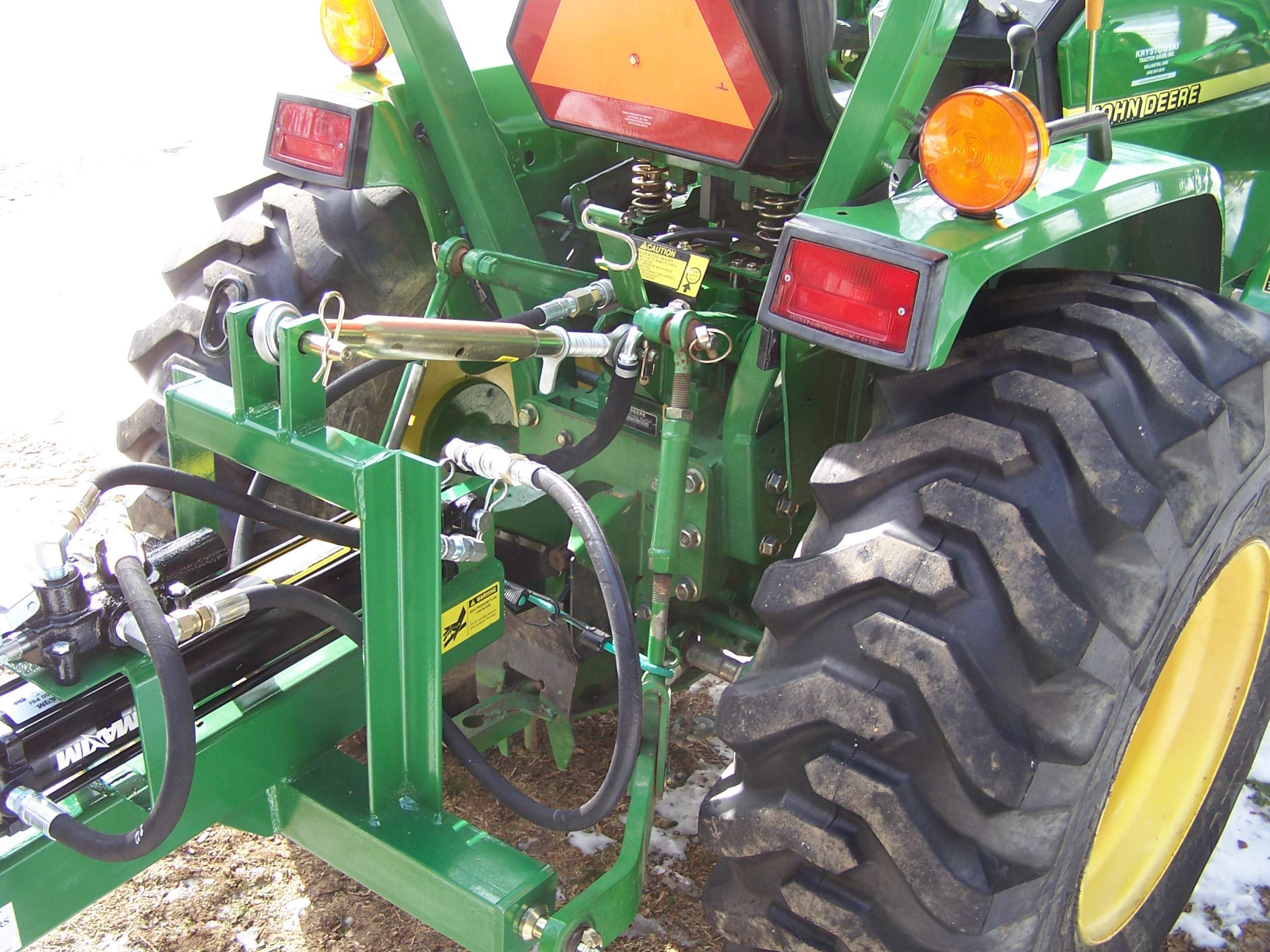

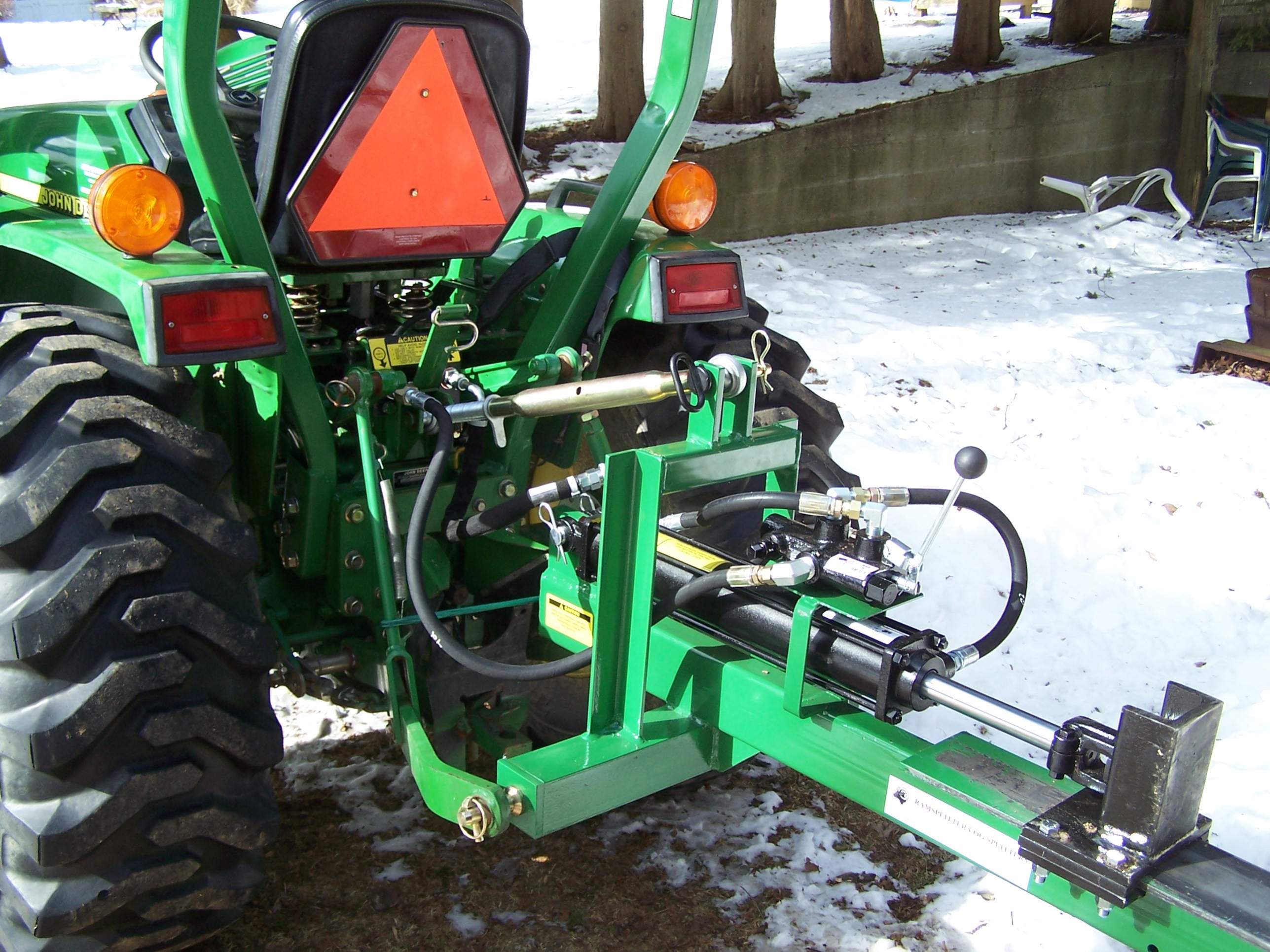

I finally had my Ramsplitter 16T 3Pt logsplitter delivered this week. To me, it was a steal for $430 plus shipping off of ebay.
I had to spend some pretty good coin at the JD dealer to get the quick disconnect couplers to fit the power beyond fittings but the guy at the dealer was very helpful and figured out which parts I needed pretty quickly.
I split about 1 1/2 cord of wood in about 2 hours. My tractor is rated at 5.4 GPM, and I expected it to be slow, but it moves as fast as I can handle and it sure beats splitting with a maul.
TommyJD790

Very nice. Did that quartering wedge come with it or did you have it made?
