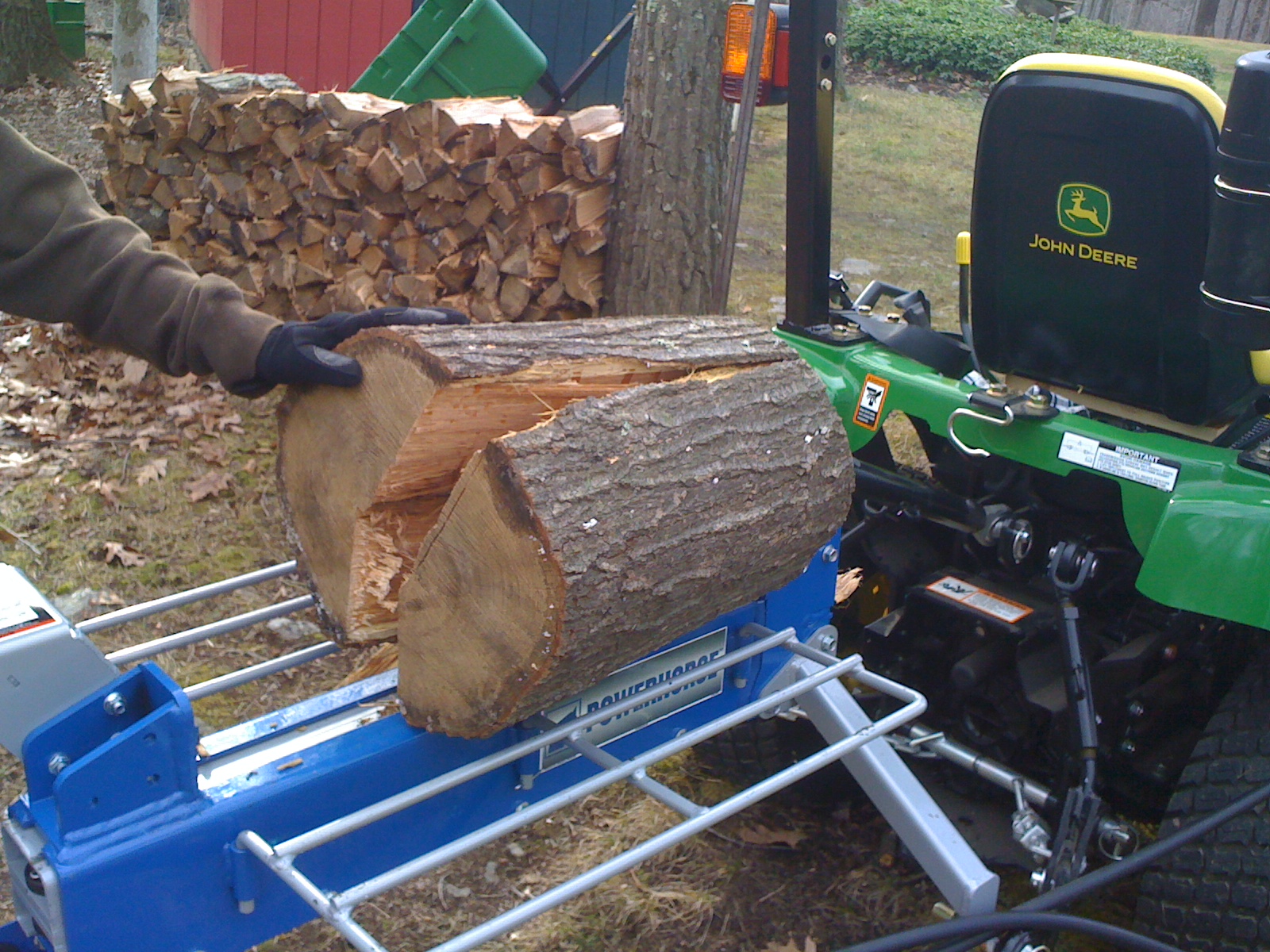

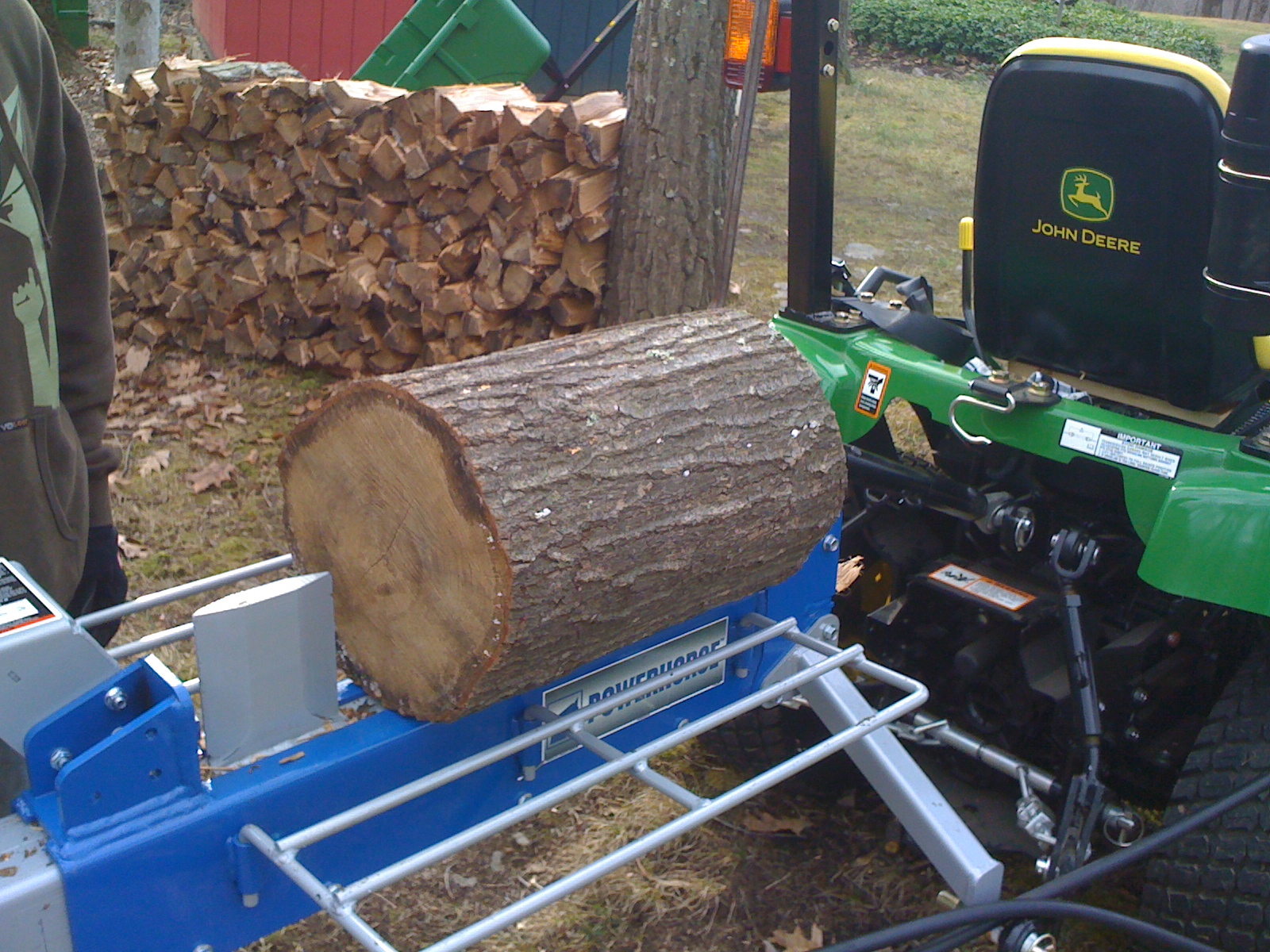

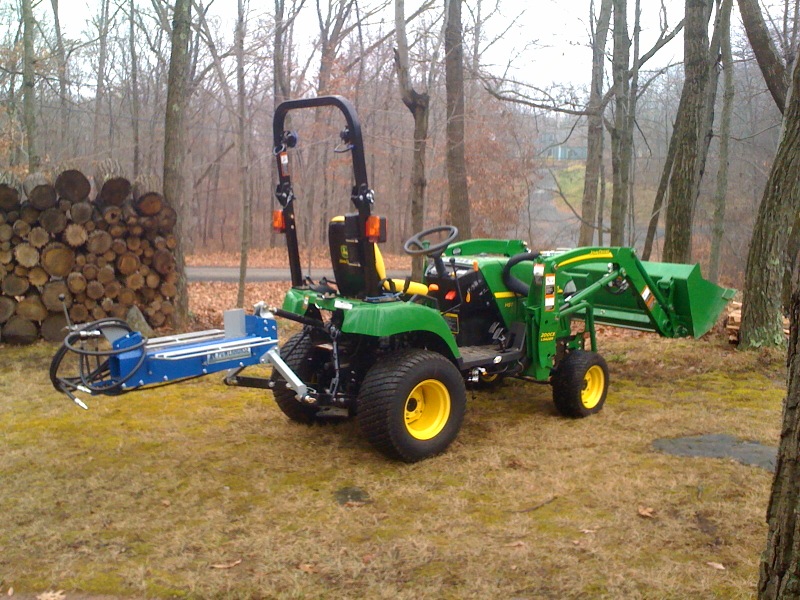

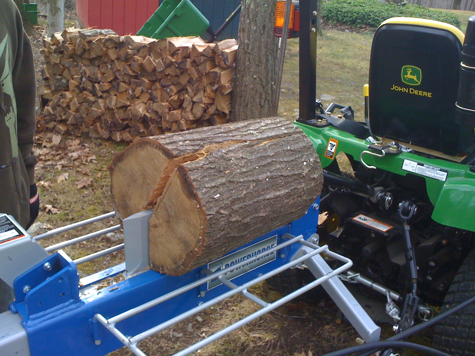

Sorry it took so long, Pics of logsplitter in action, and the tractor dressed for winter. Fred

Don't be sorry, its never to late. Man, this logsplitter does not seem to be intimidated by the size of that log. Bet your happy with your setup. Enjoy!

Thanks, yes it works well, does struggle alittle with logs with big knots or where a branch is, but I was cutting oak with little trouble. Looking to put on a power beyond kit, so I can hook up to back of machine and keep bucket active....Santa IS comming soon!!

The diverter would work, but the BEST solution (and cheaper also I think) is to get the Power Beyond kit to power the splitter, leaving the loader 100% functional. Might even get a little more speed out of it also because you won't have the restriction of the SCV valve and the small QD's.
