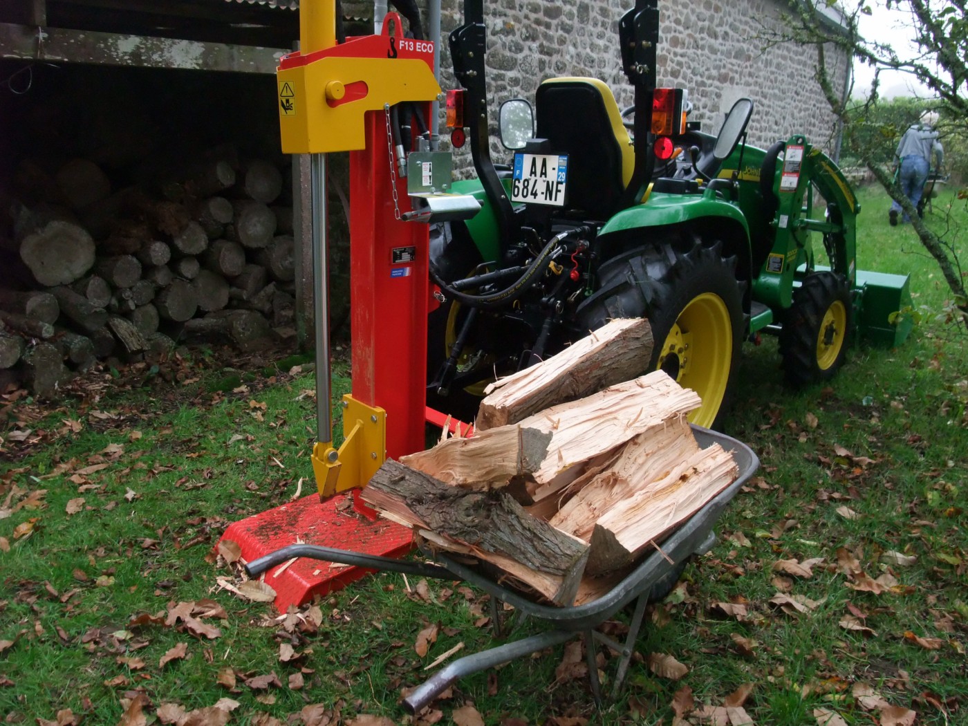

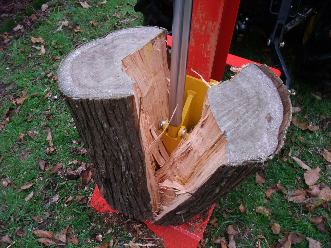

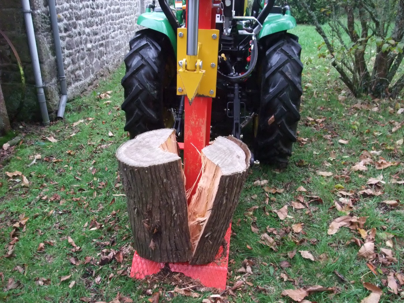

No real lifting to do with the vertical splitter. I drive the tractor to just before the shed where the big pieces have been brought with the loader. I then roll the pieces onto the bottom plate of the splitter and load the split logs on a wheelbarrow for the 20 or 30 yards to the next fire wood pile. Very pleasant work in the strong smell of freshly cut wood. Of course the tractor must be placed so that the wind will take the smoke and noise away from you.

Well, just a follow up for those who are interested, I got the splitter and it works great, have split oak up to 18"dia. with no problems. The splitter has steel wings on it so the logs do not fall off and get your toes. It does run alittle slow but not sure I would really want it to go any faster and it does cut in both directions. one question I do have is....is there any issue with leaving the bucket up in the air and rolled back so I can put logs in it with the hoses unpluged, so I can hook up the splitter? I had the splitter hooked up to the ports that roll the bucket, but when I pulled the ram all the way back the bucket would begin to rise as well. Thanks

Fred, which tractor did you put the splitter on, 2305 or 4115 ? Be nice if you had pictures.

so far just the 2305, pics to follow, need to figure out how to get them off an Iphone, need to ask my son....some things beyond me, but not our children
