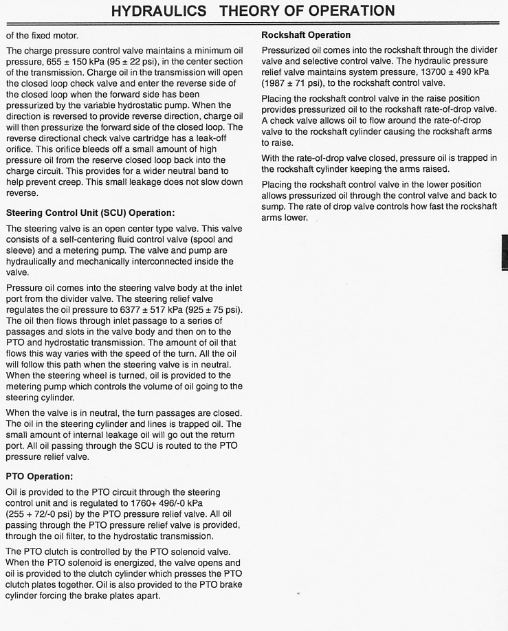

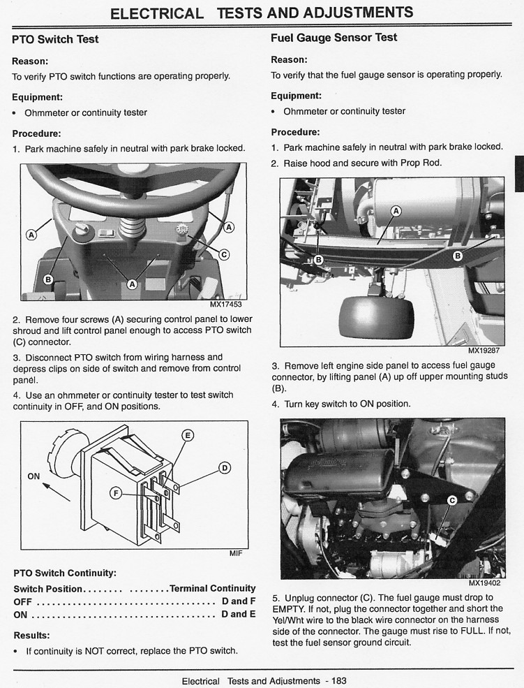

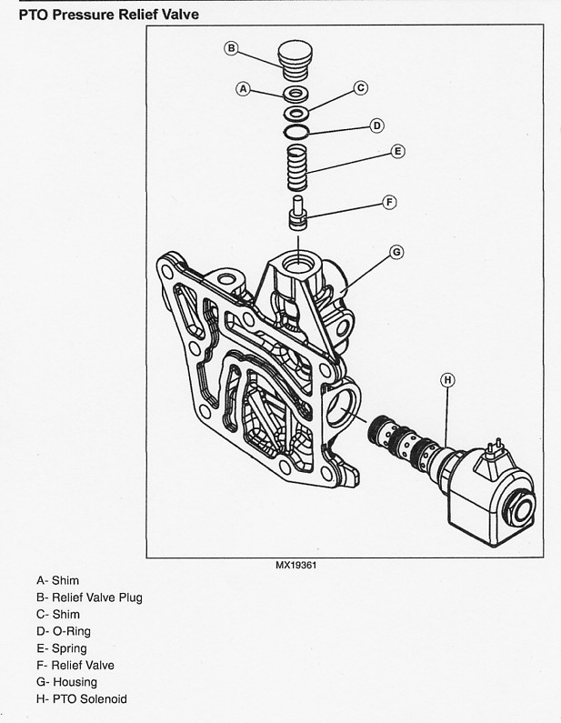

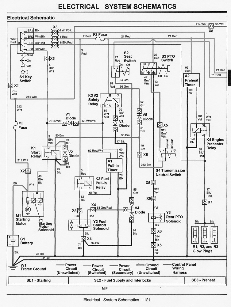

Hopefully this will help.
   / 2305 not cooperating, need help
#18
I haven't been able to solve the problem yet but something different happened today so I thought I would mention it in case it helps someone point me in the right direction.
Last week and today the tractor allowed me to mow for 10-15 minutes before the burning smell started and then I would shut it down on my own before the fuse blew. One time today I didn't shut it down when the burning smell occurred and then the pto stopped turning. I was mowing and didn't touch anything and the deck just stopped cutting. After disengaging the pto and letting it sit for a few minutes I engaged it again and the mower worked briefly and then within a couple of minutes it just stopped again. I engaged it again later and this time it blew the fuse.
Sound familiar to anyone? I don't know if the pto solenoid could act up like this but I don't know what else could.
   / 2305 not cooperating, need help #19
It sounds like a short to me, but it could be other things too. Solenoid valves will draw more current if they are not completely engaged. It could have some debris interfering with it's motion or the pressure relief valve that apparently controls the pressure to the solenoid.
When you can smell something burning, does the switch, wiring or solenoid feel hot?

Thanks for all of the diagrams davkir. The switch didn't feel hot today and last weekend I did check some wires that I could see but I wasn't sure where the solenoid was so I'm not really sure that I was checking the correct wires. The wires seemed warm but not hot. I also disconnected a couple of connections to inspect them and all looked good but again I'm not really sure that I was looking at the correct wires. The wires I was checking were on the back right hand side of the machine(when facing forward). I was basically reaching in above the right rear tire to access the wires.
