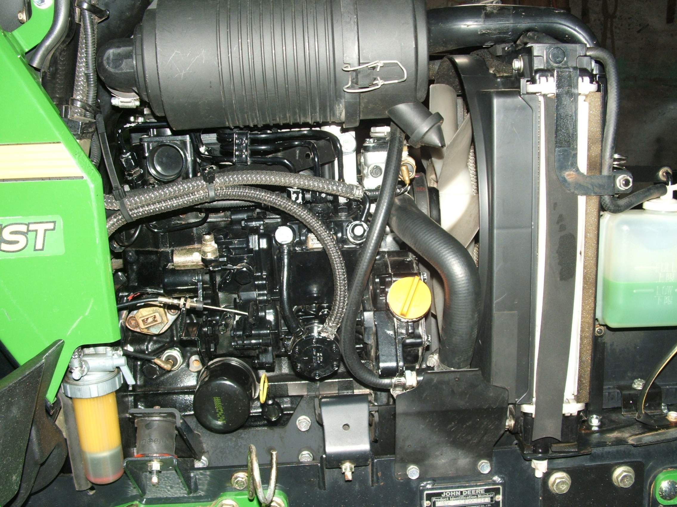

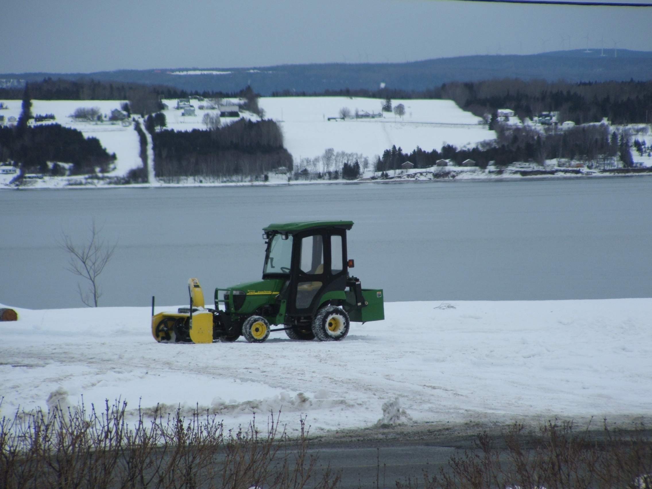

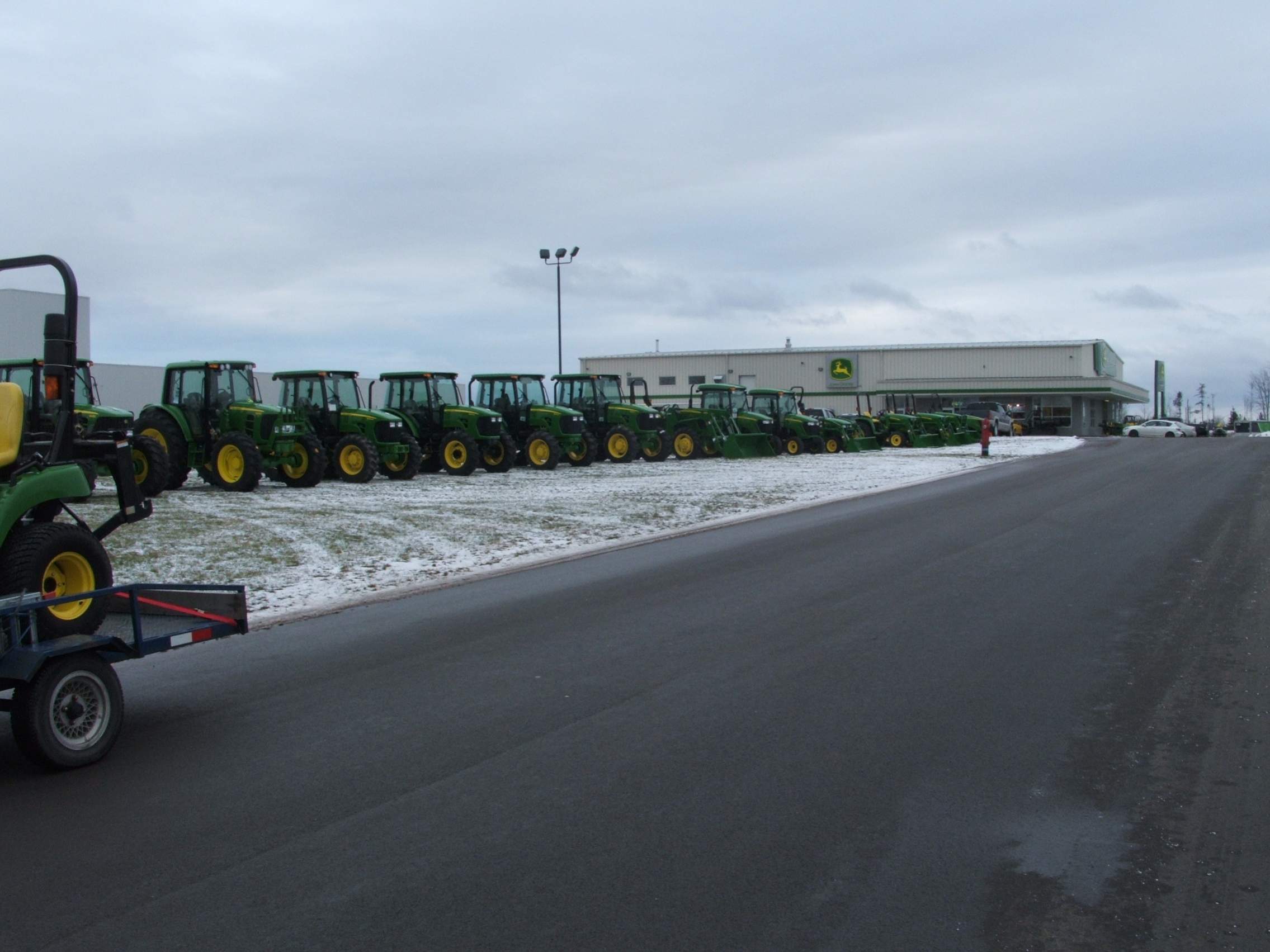

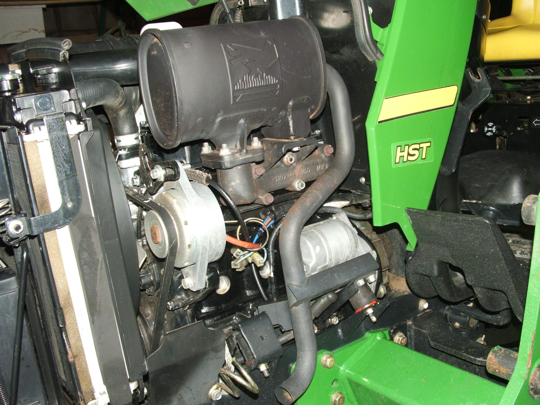

It's finally home! So they did put a ''short block'' in it, new water pump, glow plugs, and had the head and injectors check. Had it on the dyno for 45 min. tested at 21 pto hp, give or take a few since it is not completely accurate for small engine. They had the tech guy from JD (he was passing through) to look at it and he couldn't figure out what could've cause it. I guess will never find out. So, now its home, got the cab and the blower on and it is working great. I never realize that I was lacking power, but now, I do see a difference and the engine noise is also different. This is going to be a great Christmas after all. :drink: Pics from my dealer and the engine. Thanks everyone and Merry Christmas! Henri

/ 2305 engine needs to be rebuilt #92
Good Christmas present to you Henri!
Did they advise you on how to run the engine?
