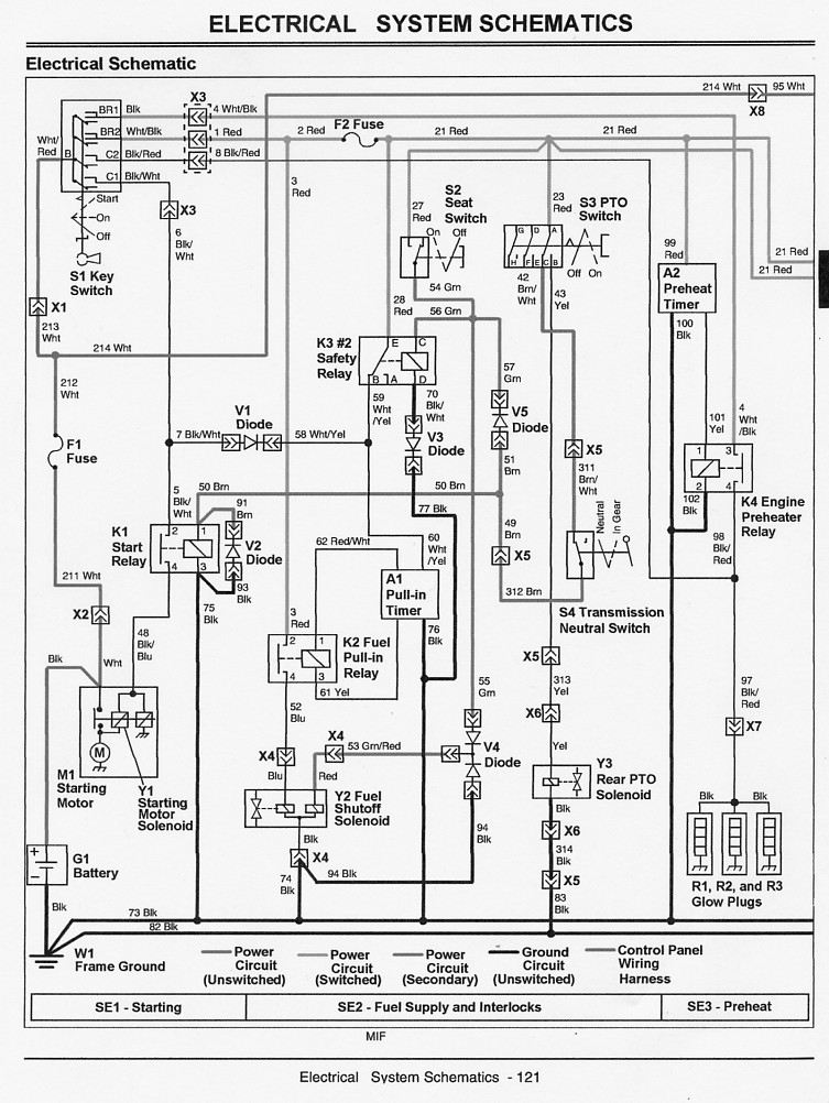

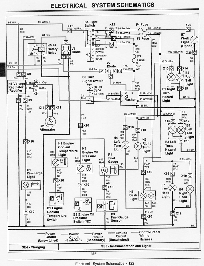

For the last three times I have cranked up my tractor the yellow caution lights come on and stay on? I have looked for any wiring problems that I could see from just looking around but nothing out of the ordinary. Anyone else have this issue with their 2305 or any JD tractor for that matter?

Hope this helps.

There are 2 diodes under the dash that can cause problems similar to what you are describing.
