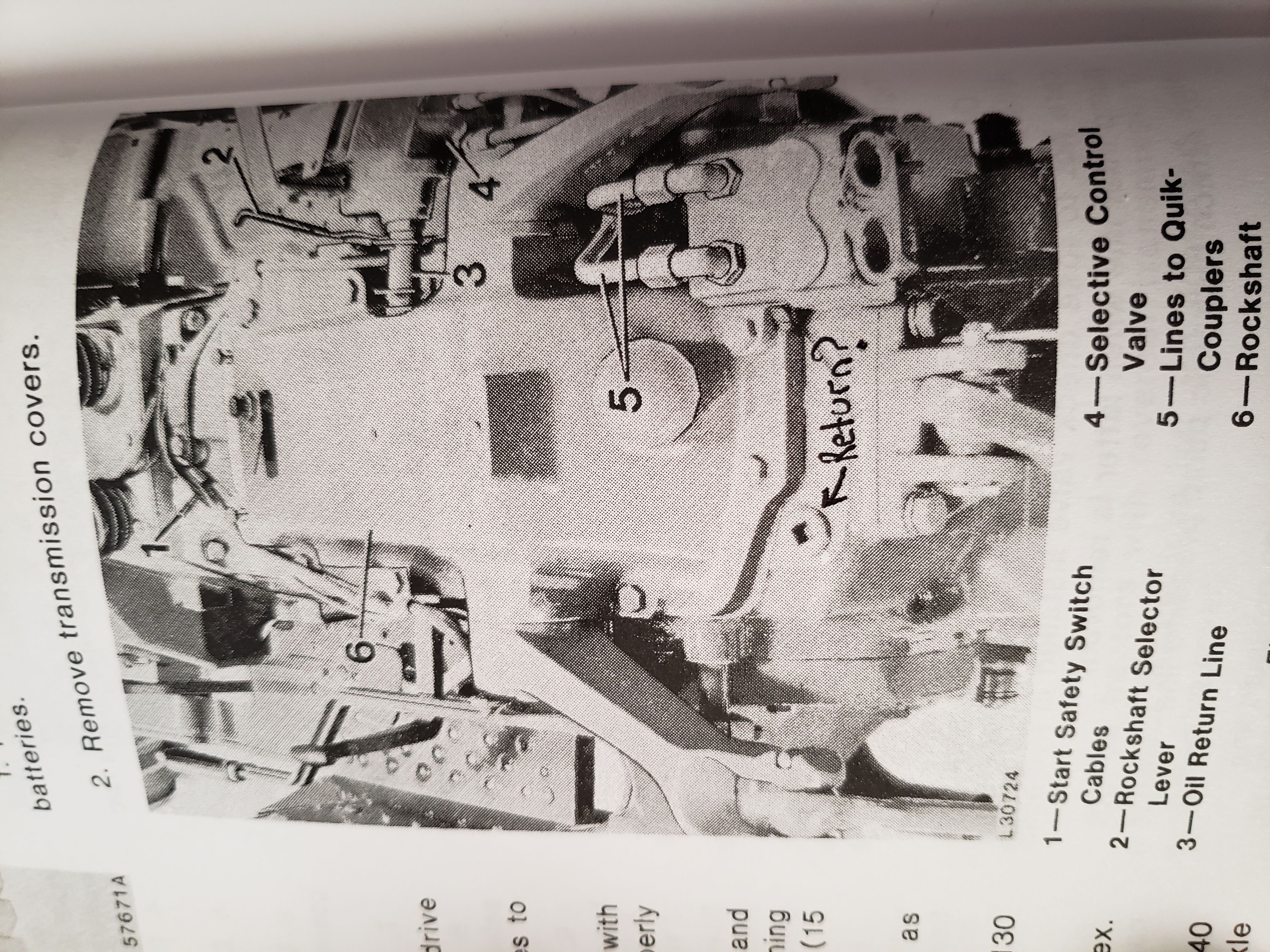

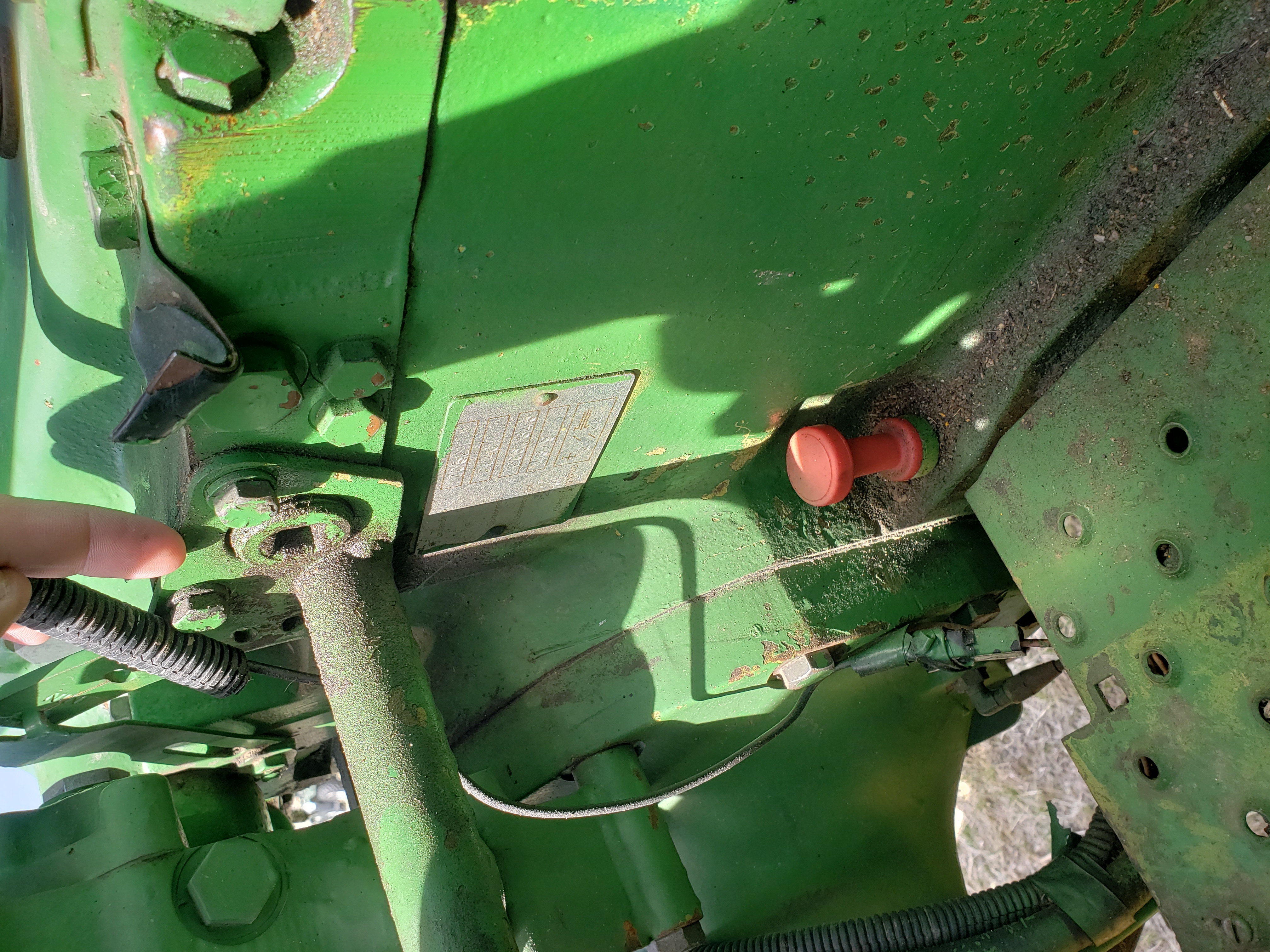

I really hate asking dumb questions, but i have a feeling that I'm about to. I recently bought a JD2240. Ive been using this tractor for a couple months now for odd jobs around the property, but have yet to really use the remote hydraulics in the rear. Im looking at a post pounder to use on the 3 point hitch. I have learned that the post pounder requires a larger diameter hose for the return line. Where do i plumb this hose into on the tractor?
I think i need to unscrew the plug that a 3/8 ratchet fits into and screw a hose fitting into the hole to attach the return line from the pounder. Next question, does it matter which quick connect port in the picture i attach the high pressure line from the pounder to? Either one will provide high pressure to the pounder, right?
Last question. I know that my tractor uses a closed center hydraulic system. The pounder has its own hydraulic control levers on it. Do those hydraulic controls on the pounder have to be specific to closed center hydraulic systems? Or does it make no difference at all and the pounder could be used on either an open system or a closed system?

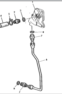

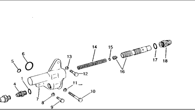

IIRC 2240 didn't come from factory with ported filter cover as standard equipment when I sold them when they were new. There is a fitting(key 4) to get pressure behind pressure control valve below but not above the foot board.

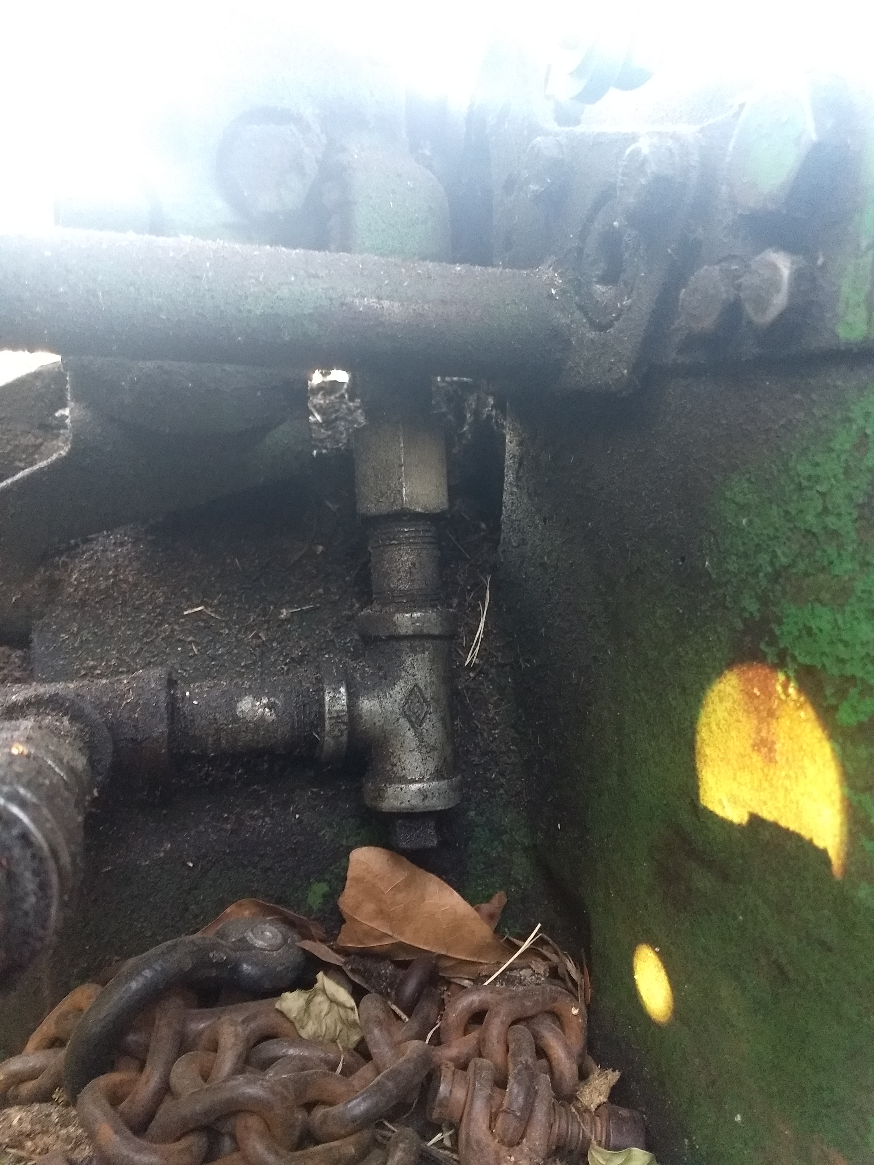

I can't find the illustration at the moment . The pressure line I'm Talking about comes up by the tranny and rock shaft and goes into the remote control block . I have installed a T in this line on a 2040 and a 2630 to run a FEL on these tractors. The first one I saw done this way back in the nineties had a drilled tapped nipple in the filter housing. This was performed by the dealer. Right or wrong it worked . All i have now is the 2630 and can snap a pic tonight of the plumbing .
/ 2240 Hydraulics Questions #7
here is a pic of the line i am talking about. I mispoke on the dipstick , mine has the dipstick located where i described.

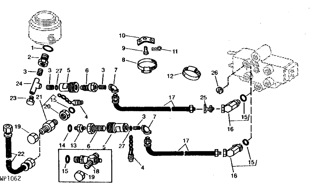

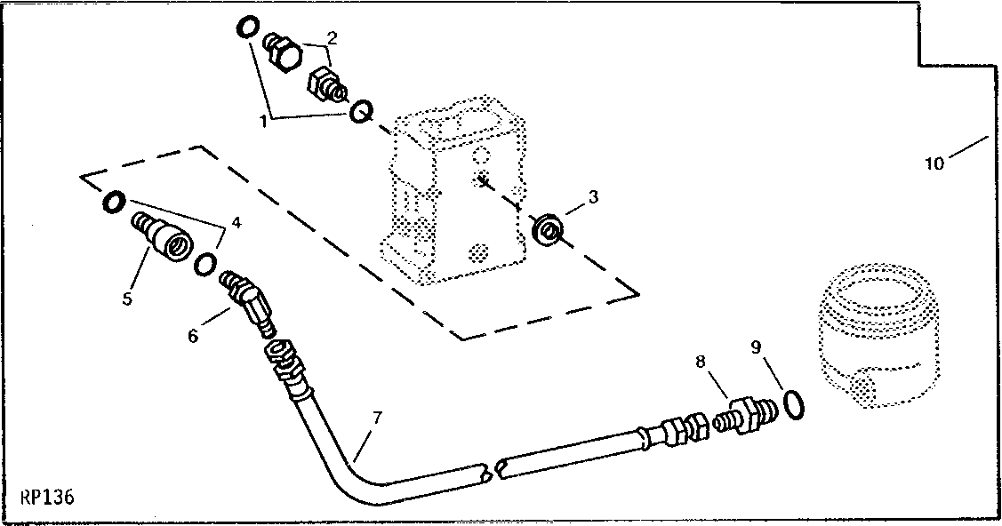

Here's a parts photo of the line you're referring to. We are referring to basically same hyd source just opposite ends of the line. 2nd photo shows how JD engineers thought an added hyd valve should be attached to a JD utility 20-55 series tractor. Hose(key 22 2nd pic) is hose you're referring to in your last photo. IMHO it's easier to install a tee in the lower section of the line than the upper section especially if fender is mounted close to scv. I either installed or supervised installing many frt end loaders while employed for 21 yrs at a JD dealership.

M5farms, i think this is the port you are talking about.
No that's not the port I was referring to. Port you're pointing finger at is just an opening to sump. Port I was referring to is under foot rest at rear of priority(pressure control) valve.

This is how mine is plumbed.
Do you realize that galvanized pipe fittings does not have a pressure rating anywhere close to 2250 psi? It will be alright for return oil but I wouldn't use it for pressure.
/ 2240 Hydraulics Questions #14
It's possible it might fail and possible it won't . If it does I will replace it .

Here is the RETURN from the SCVs on my 2030. It's my understanding this was some type of optional kit It goes to the optional ported oil filter cover
/ 2240 Hydraulics Questions #16
You're correct the hose from scv to ported filter cover was a "very good option" that I never personally witnessed.
