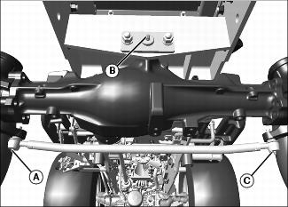

I was greasing the front steering links and I had taken the pressure off by raising the front with the fel when I noticed that the axle rocked slightly from side to side not from back to front. Is this a problem?
/ 2210 front axle #2
Most all tractors pivot side to side at the frame/front axle mount point.
Should be a grease fitting there also.
/ 2210 front axle
thanks. So that grease point is for that swivel point. I am forever pumping grease into it but nothing ever comes out. Where does it go?
/ 2210 front axle #4
It might be coming out someplace you can't see, like the top or back side.
Feel around or use a small mirror. Your going to want to clean the excess off.
Or you'll find it with your shoe later. ;)
/ 2210 front axle #5
On my 2210, dealer tech said he pumped in over half a tube of grease before any would seep out. Must be quite a grease cavity for that front pivot pin...
/ 2210 front axle #6
I grease mine every 20 hrs and it only takes a few pumps.
