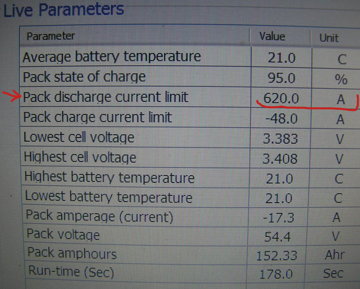

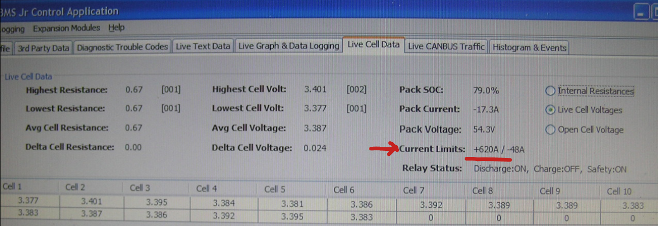

   / 2022 Polaris Ranger EV - picked up today! #37
I've read on some other forums that the Ranger EV takes around 180A cruising and up to 480A at full power. Does anyone here know the actual numbers?
Mine went over 620A up a short steep hill on the way to the mailbox.
   / 2022 Polaris Ranger EV - picked up today! #39
How did you measure the current draw?
The BMS shut it down when I went up the steep hill.
It was set at 620A:
What type of batteries does your Ranger EV have in it?
Voltronics. My thread: Electric Polaris Ranger
