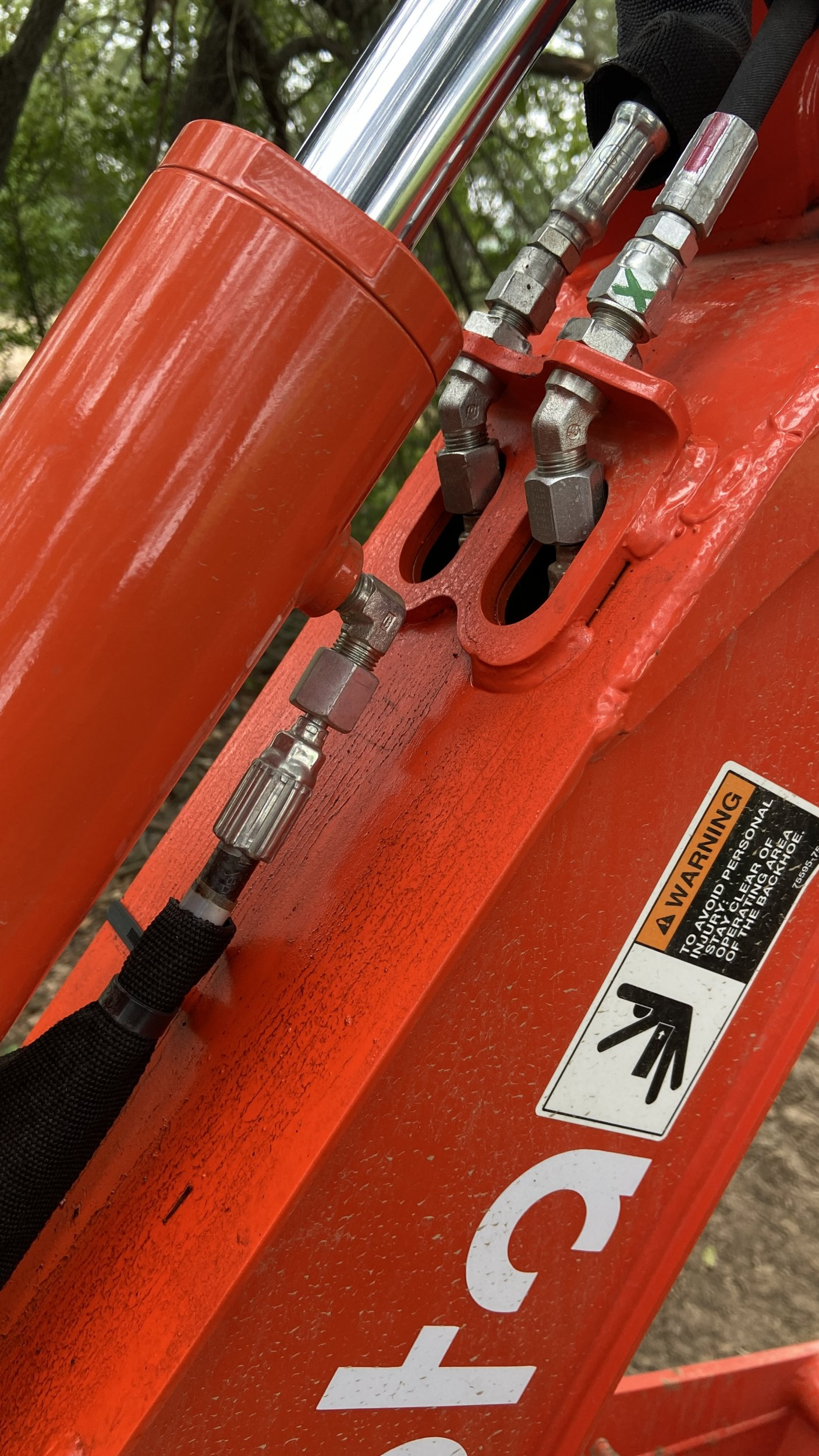

Bought the Kibota L3302 with a backhoe, took delivery of the tractor late in the evening, didn’t get to play with it that day, the next day I went out to play around with it, be darn, the backhoe had leaked fluid on the ground over night. A brand new tractor less than 2 hours on it leaking.
Called dealer, sent someone out, also noticed the backhoe mounting frame was not bolted up correctly to the tractor missing bolts, wrong bolts.
This isn’t the worst part, they kept the tractor for a few days, changed out the backhoe mounting frame, put correct number of bolts in, said they fixed the fluid leak on the backhoe, well used the backhoe yesterday and bam, leaking again, called dealer and they’re a no show on fixing it again.
What the heck has gone wrong with businesses? They don’t seem to care anymore, they take your money but give you defective products.

Like I said previously, get a new dealer. I bought a backhoe for my B series from my dealer. Got a deal on it because it had never sold and was sitting outside in the crate for 2 years. Paint was starting to fade from the sun.
I got it home and after I started using it, a hydraulic line started leaking. Called my dealer and told him. They said ya, we figured that might happen after sitting in the sun for 2 years. So they gave me new lines for it for free from Kubota parts.
That is how a good dealer takes care of things.
