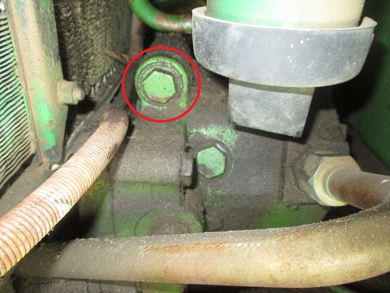

Feb 11, 2018 / 2020 Hydraulic Pump Filter? #1 bodin1968 Bronze Member Joined Jul 14, 2017 Messages 96 Location Montgomery, AL Tractor 1968 John Deere 2020 recently changed all of the fluids on the 2020 (hydraulic oil/filter, engine oil/filter, coolant etc.).... i'm having no hydraulic issues w tractor. should i pull this hyd. pump filter and clean it or leave it alone? thanks in advance....

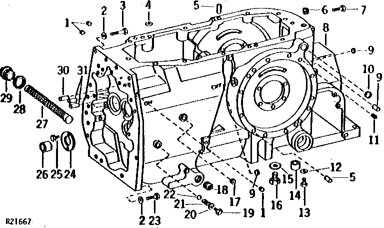

Feb 11, 2018 / 2020 Hydraulic Pump Filter? #2 Zebrafive Super Member Joined Aug 5, 2010 Messages 5,635 Location South West MI Tractor John Deere 2030, John Deere 6415 I would first pull and check/clean the internal sump screen that is in the transmission case. 27 in the drawing Attachments 2030transscreen.gif 15.9 KB · Views: 584
Feb 11, 2018 / 2020 Hydraulic Pump Filter? Thread Starter #3 OP bodin1968 Bronze Member Joined Jul 14, 2017 Messages 96 Location Montgomery, AL Tractor 1968 John Deere 2020 thanks zebra... will i lose much hyd. oil when i pull this screen to clean?
Feb 12, 2018 / 2020 Hydraulic Pump Filter? #4 Tx Jim New Member Joined Jan 26, 2007 Messages 10,391 Location Coyote Flats,Tx Tractor JD 4255/Kubota M7040 HDC Only about 8 gallons. In lieu of draining the oil one can insert the nozzle on hose of an operating shop vac in hyd filler hole with excess of hole blocked off with a shop towel to create a vacuum.
Feb 12, 2018 / 2020 Hydraulic Pump Filter? Thread Starter #5 OP bodin1968 Bronze Member Joined Jul 14, 2017 Messages 96 Location Montgomery, AL Tractor 1968 John Deere 2020 no thanks. 2020 manual says change Hyd. oil every 1k hours. is this right? ...and the manual says there are 2 hyd. drain plugs? i see one drain plug. is the other hidden by my draw bar? Last edited: Feb 12, 2018
Feb 12, 2018 / 2020 Hydraulic Pump Filter? #6 Tx Jim New Member Joined Jan 26, 2007 Messages 10,391 Location Coyote Flats,Tx Tractor JD 4255/Kubota M7040 HDC bodin1968 said: no thanks. 2020 manual says change Hyd. oil every 1k hours. is this right? ...and the manual says there are 2 hyd. drain plugs? i see one drain plug. is the other hidden by my draw bar? Click to expand... Yes IIRC 1 drain plug is hidden by drwawbar.
