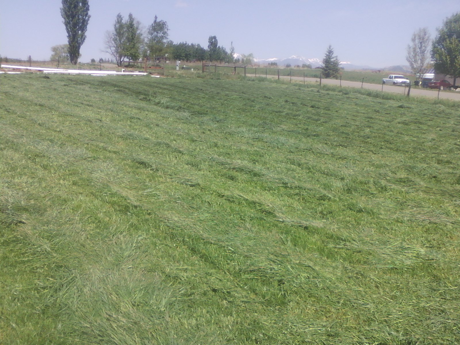

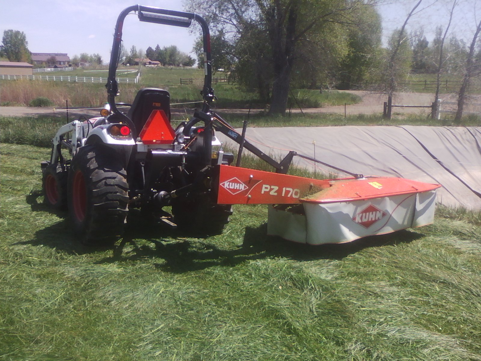

Well did the second cutting yesterday on my 3 acres with the PZ 170 mower. Waste high thick grass. Cutting in some area actually put a load on the tractor running in mid range. No uncut strips this time as I finally figured out where to drive. I started by driving the outside, cutting in and then went back and cut the outside the opposite of how I drove giving the grass a chance to spring back. This worked great as the mower cut the mashed down grass by sliding under it first. Using my hydraulic top link also made adjustment of the drum mower easy. Best position was a very slight up tilt.
I have at least 7 days of sun, 90 degree temp and up to 15 mph winds - perfect drying conditions with humidity in the mid to low teens. I will tedd the windrows left by the mower tomorrow after the top drys today.
I still need to add my disk spacers if I can ever get the bolts to come free to raise the cutting height.
Adding a few pictures of my mowing set up and the results.
