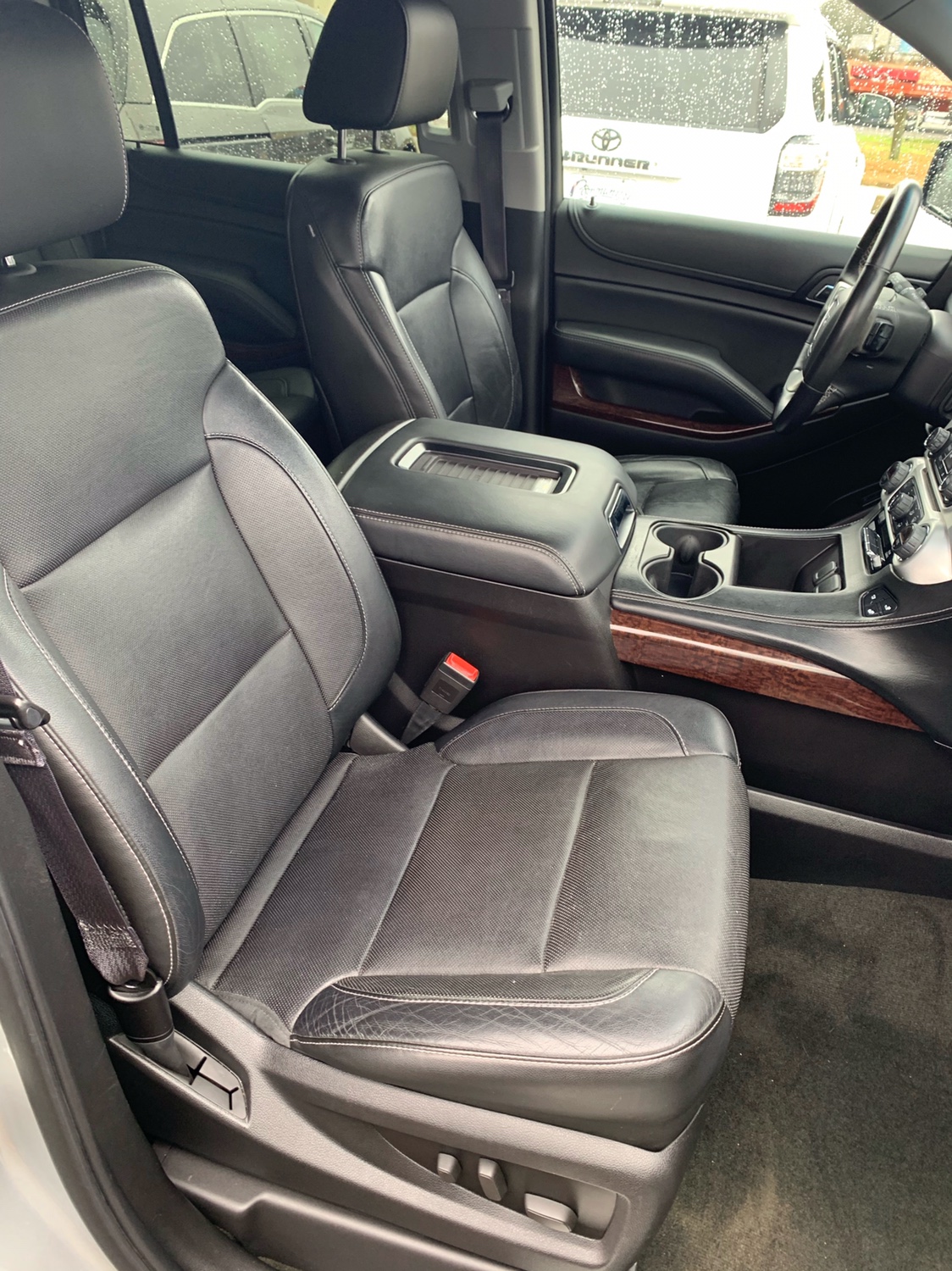

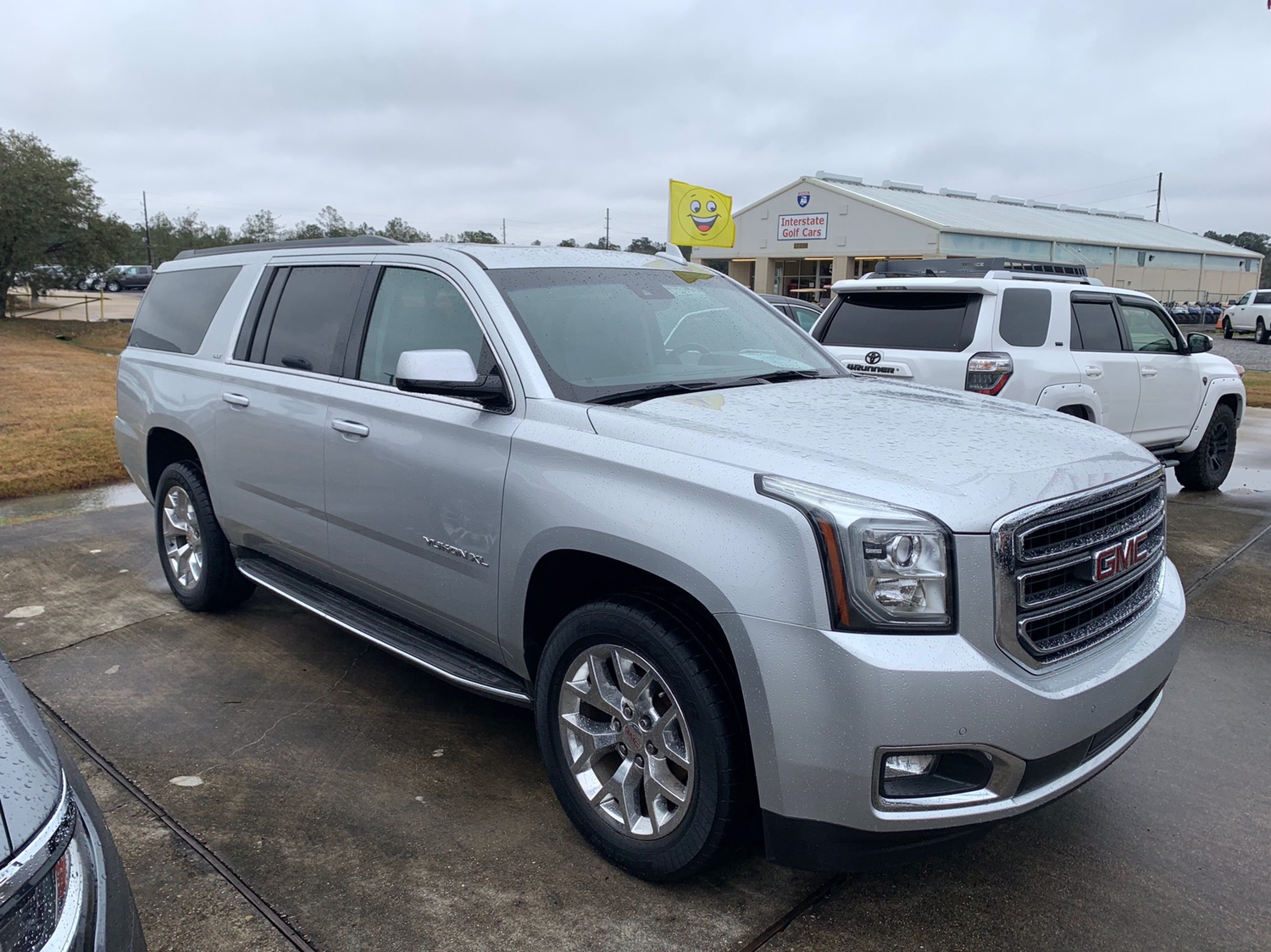

Thanks everyone . We picked it up today, 2015 SLT XL. Very clean. 5.3, 3.08 gears 2wd. Won’t tow often, maybe 3-5 times a year, 5-6k lbs max. With 3 kids, we outgrew the Armada. IMG_2767.JPGIMG_2768.JPGIMG_2769.JPG
