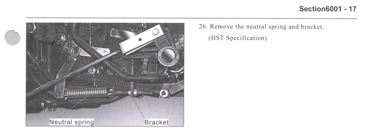

If you look at the underside by the pedal, you will find a pullback spring that works for forward and reverse. It can be adjusted pretty easily. Had to do it to my 1816.

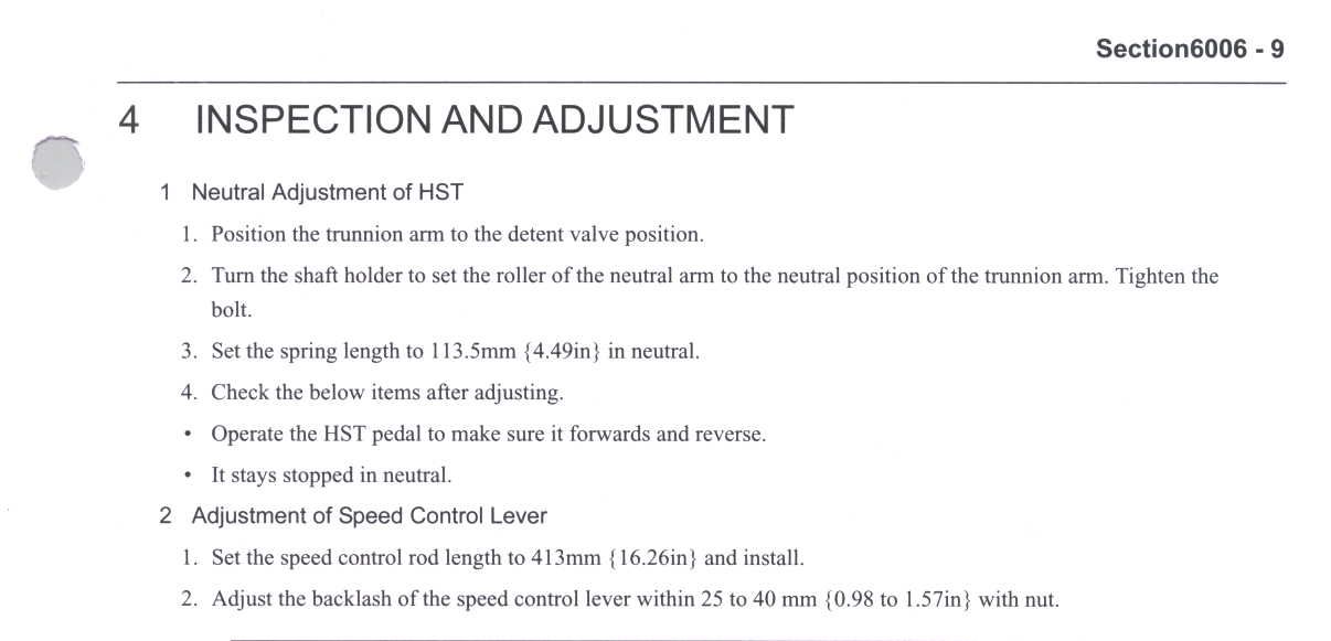

If the 2015 is like the 2615, under the floor board there is a valve with a rod on both ends. The ends are threaded, and there is a locking nut on each end. I think your valve is probably a tad off center. Try loosening both nuts, and see if that allows the valve to return to a neutral positon. If it does, re-tighten, and check to see if all is well. This is only and educated guess. :)

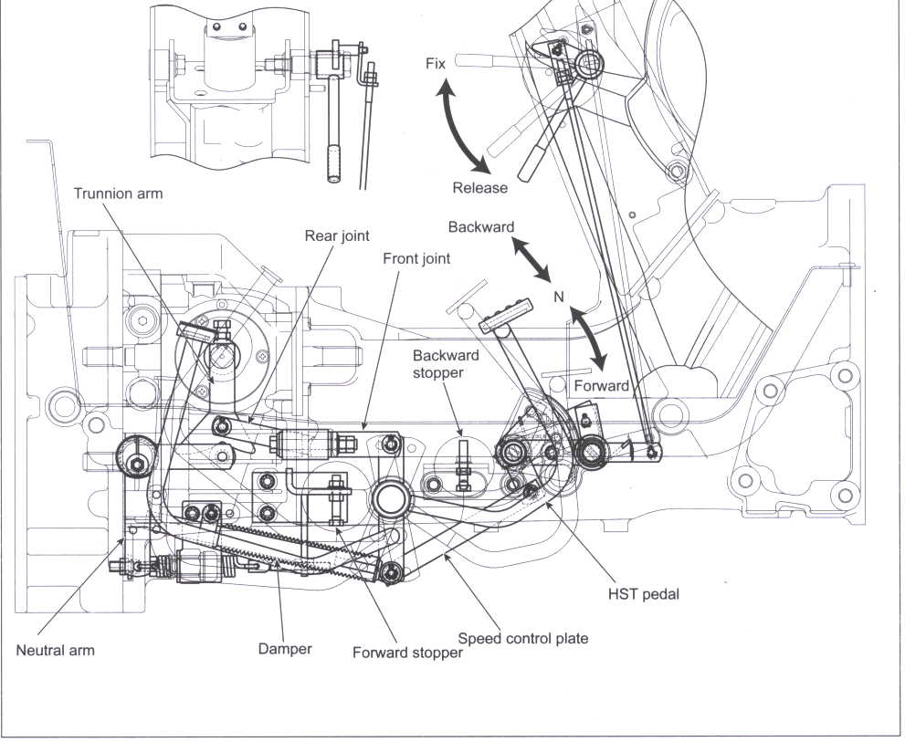

After read Wanderer53 posting which seemed to be good ideal I started looking more into my manual and found the following which for whatever reason I overlooked so I've scanned and have attached the information below, hopeful this will help.
Added another picture which should help identify the components.

Exactly what he needed. I tried to scan that for him a few days ago but for one reason or another, neither the shop or home computer would scan it and transfer it from the scanner. Even though I know the problem is probably me, I hate computers sometimes.
