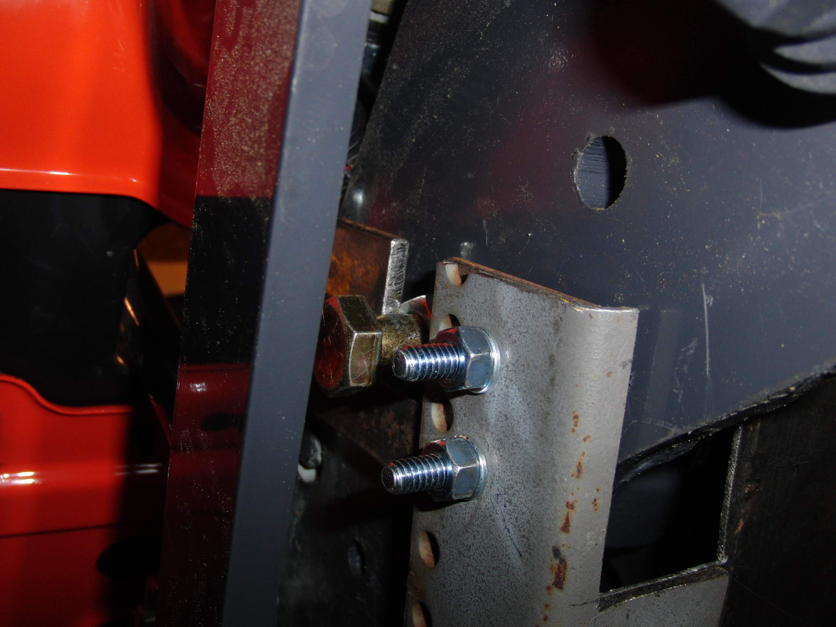

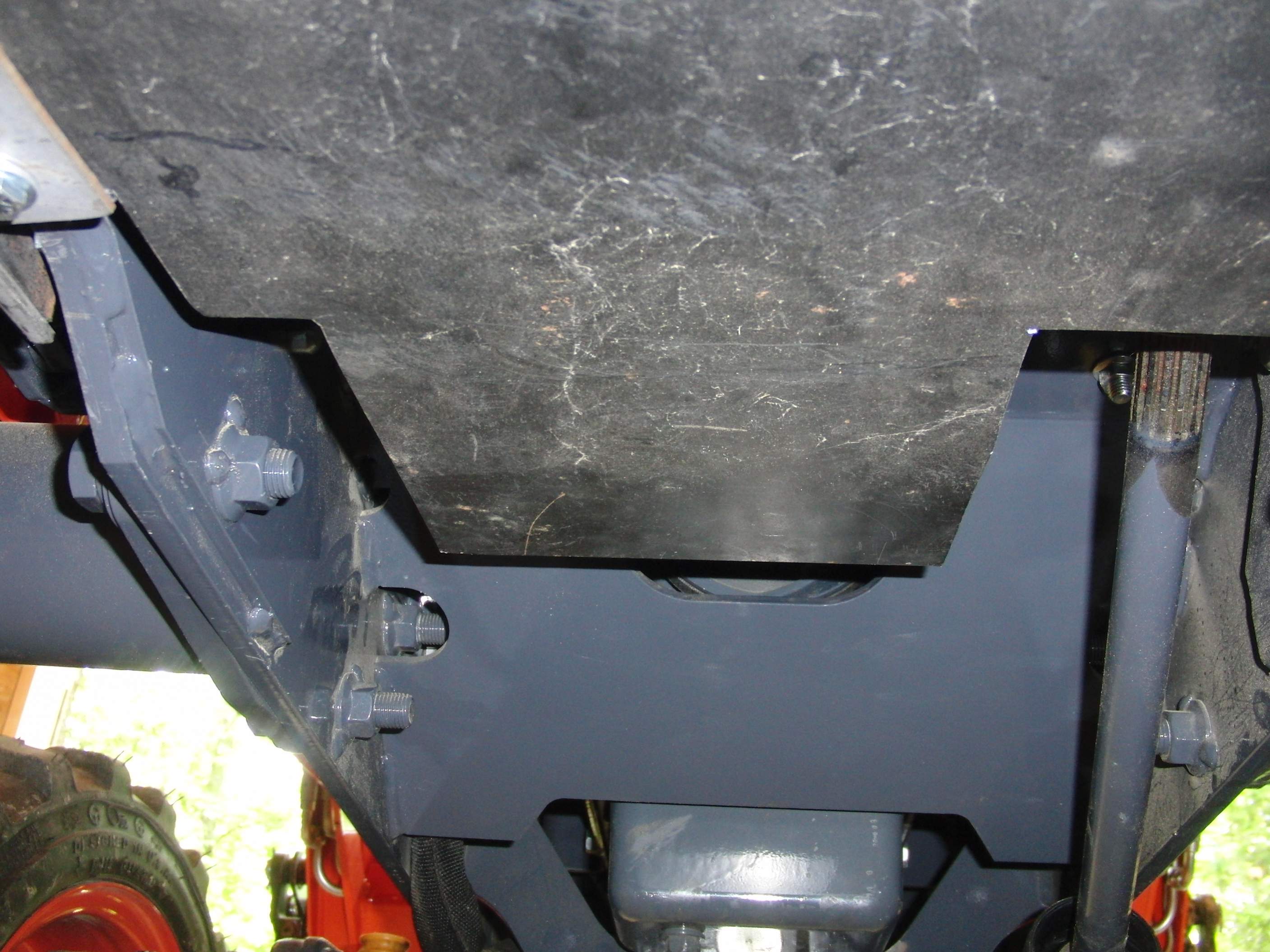

OK here it is - the "no-weld" skid plate.
I used 2" angle iron, some 3/16" x 3" steel, a bit of 3/16" x 2" steel , 2 1/2"-13 grade 8 bolts with jam nuts and regular nuts, a piece if 1/16" sheet steel and a lot of 1/4-20 bolts, nuts and washers. If any one is interested I'll post the drawings with dimensions at some point. It's not the design I originally had, but after crawling around under the beast, I realized that attaching it to the mower arms was the right thing to do. The secret was making the front brackets that attach to the 1/2" bolts installed in an existing hole in the frame. Once I figured that out the rest was just a matter of figuring out what materials I had on hand and how I would use them. It goes on fairly easy and is solid once it's up. The 3/16" steel provides protection for the filter and PTO. The sheet steel covers the existing "guard" as well as the wires up front. I could add another front piece if it seems necessary, but for now this will work. I'll paint it later but need to get some projects finished! The long 1/4 bolts will all get cut off after I get the painting done. I was in the midst of moving some brush when I heard the dreaded bbrrrrrrrrt sound of a stick hitting the fan! I immediately shut down and took a look. No damage but the was a mark on the fan made by a fresh cut pine branch...lucky! So I put the tractor in the shed, and worked on the plate until done! Here are pics of the plate and my shed/shop.

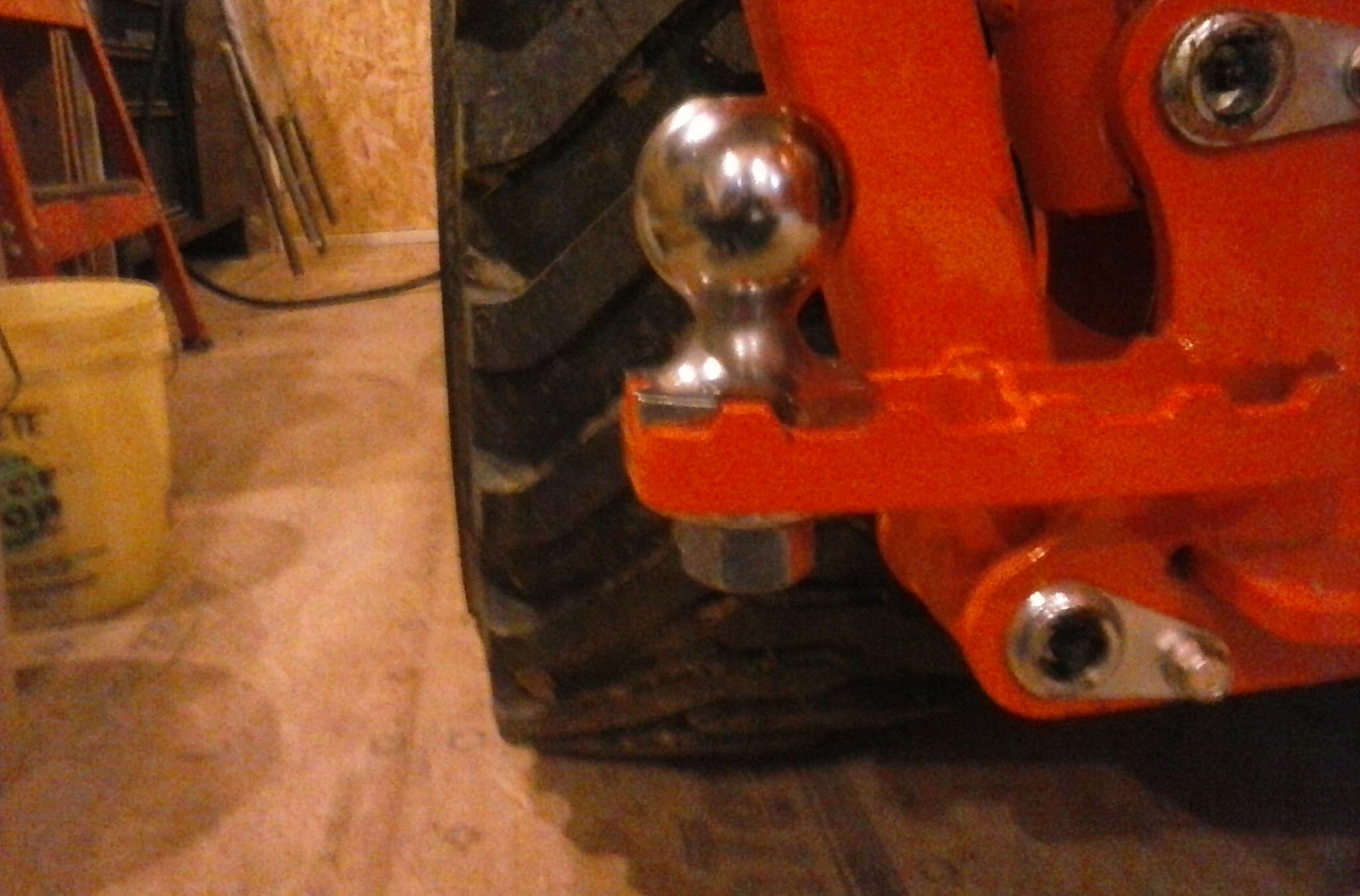

Step Hitch - rainy day here so I spent a few minutes being creative with my die grinder. :D
Have not tested this yet, but it's going to be used with a light utility trailer for brush and the occasional stump. I know I know, it's not the right place for a hitch, but I figure the weight that the ball hitch will see probably won't exceed 200 lbs., and if the tractor isn't tipping over when I step on it, :eek: it should be OK. :thumbsup:
I took a standard 2" hitch ball and ground notches to fit the "bumps" in the step. Then put a 3/4" washer and lock on the bottom...voila!

Pretty slick.

Yeah it look "cool" but it failed :mad:...when I backed the trailer up without a load, the step started to bend! :eek: I could reinforce it with some angle iron but I think I'll write this one up as a lesson learned. :cool:

Ah too bad... obviously can't stand much of a lateral load compared to vertical. I'm a continent away from mine to look at the 'structure' but maybe some kind of gusset if you are still serious about making a go of it but likely you need to pick a more stout area to start with. Good luck.

Thanks for sharing (a la Paul Harvey) the rest of the story. Most folks won't share a failure. But, more is learned from a failure than most will admit, or can imagine. Thanks again.

It's amazing how time fly's when you have a BX25D! Just did my 50 hour service. Review TBN and John's advise first then got it done! The only difficult part was having to remove the factory HST fan guard to get the HST filter off. I didn't remove it when I put my own skid plate on but now that it's off it will stay off!
Skid plate is working well and seems to be protecting everything under there. I've really abused this machine but it "takes a lickin' and keeps on tickin'"! :cool2:

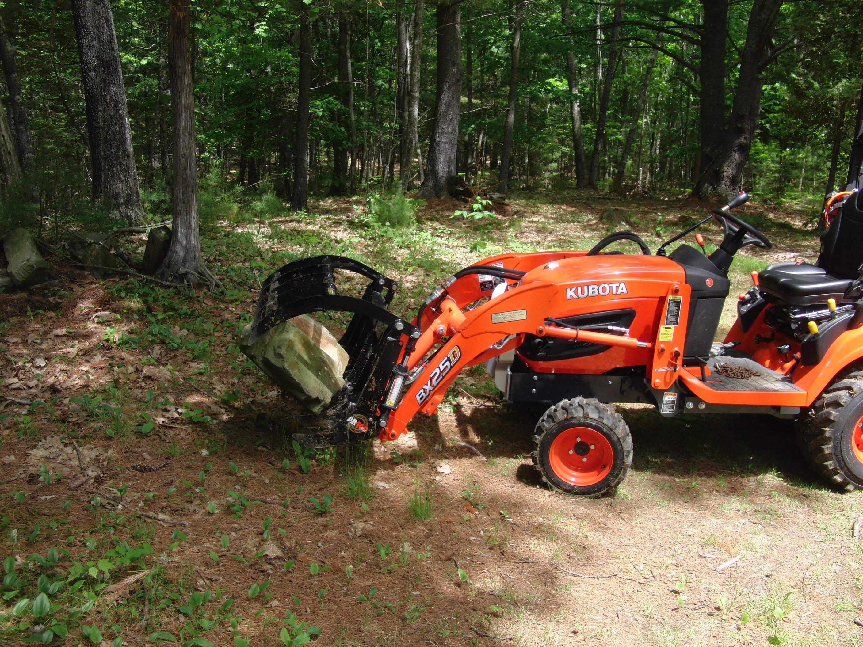

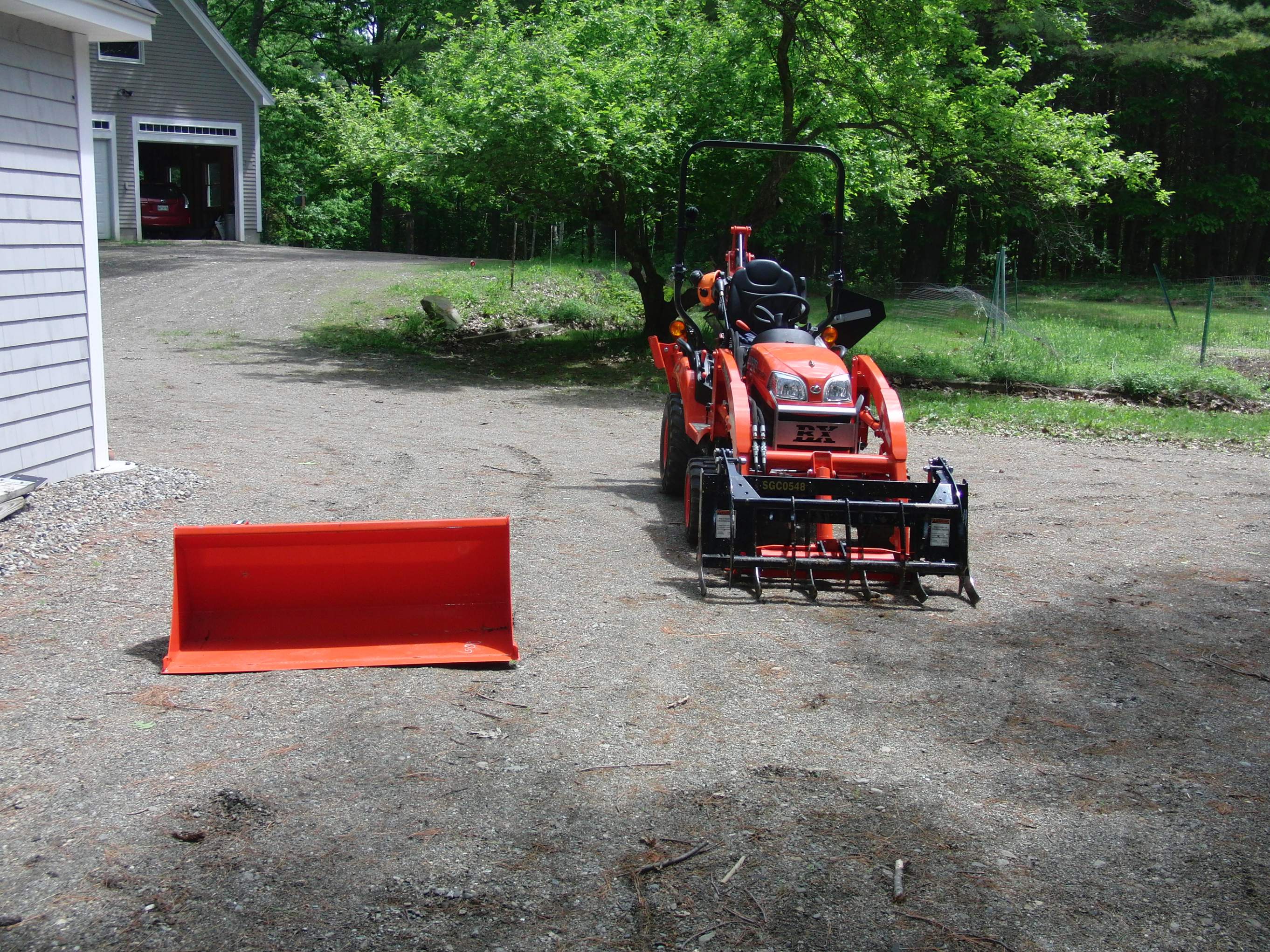

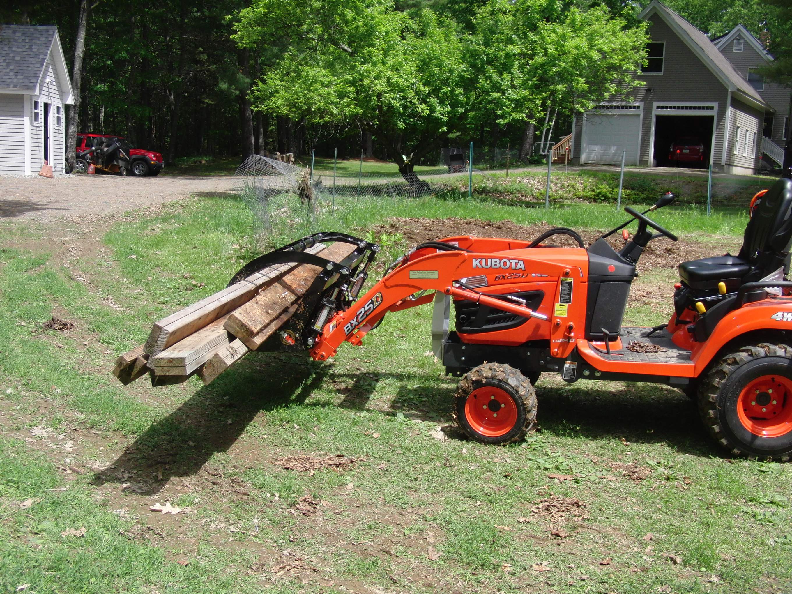

0914151120.jpgBucket Forks - not on my original list but realized I needed them so...
I looked in the scrap steel pile and found a couple of fifth wheel mounts for a pickup bed. They are about 4 ft long and real sturdy so I got some chain, chain binders, 3" u-bolts I had, a couple of 40" 2 x 6 and some carriage bolts...voila! Bucket forks! (Thanks to the folks on TBN that gave me the ideas for this!)
