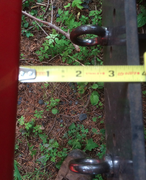

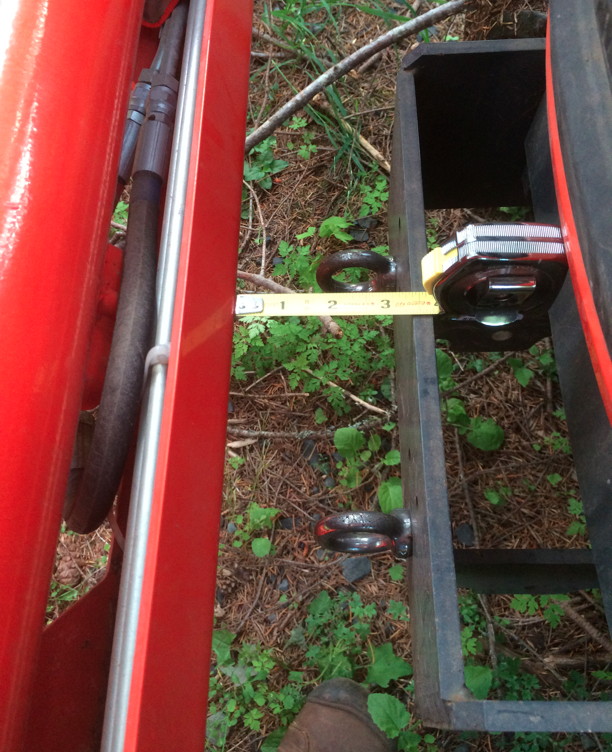

Be aware that, while the BX looks like it has plenty of room for a medium sized winch mounted to the front of the frame, the space goes away quickly when the loader frame goes below the level position. You don't usually see it in that position, but you need to check before going ahead with the winch mount.
Loader all the way down, there is only 3 5/16 inch space between the loader stand and the front frame of the tractor.

Good point! I didn't realize that. Since I don't have the BX yet I'm planning a bit blind in places. Advice like this is why I love this forum! I'll rethink my winch plans. Thanks!

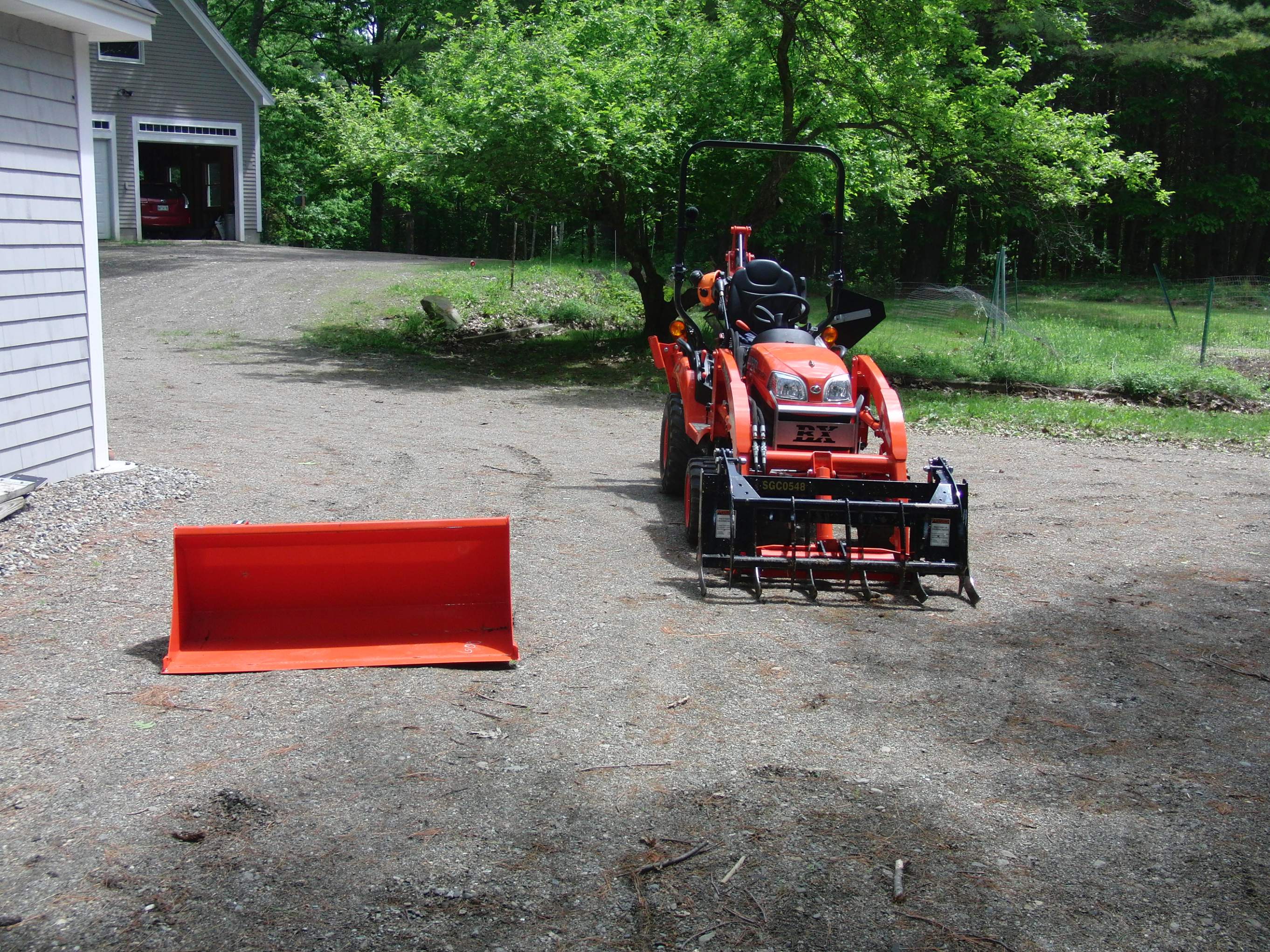

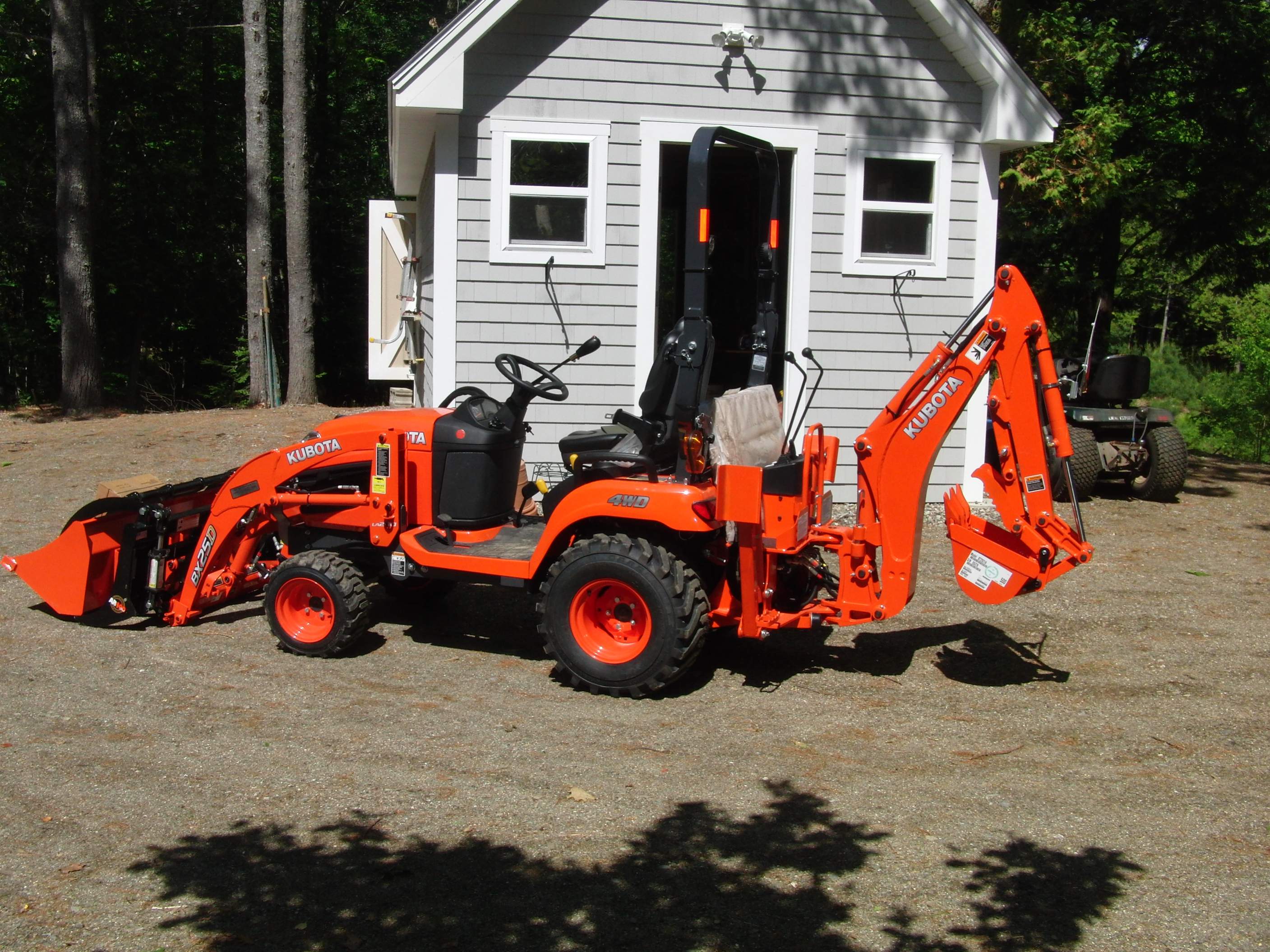

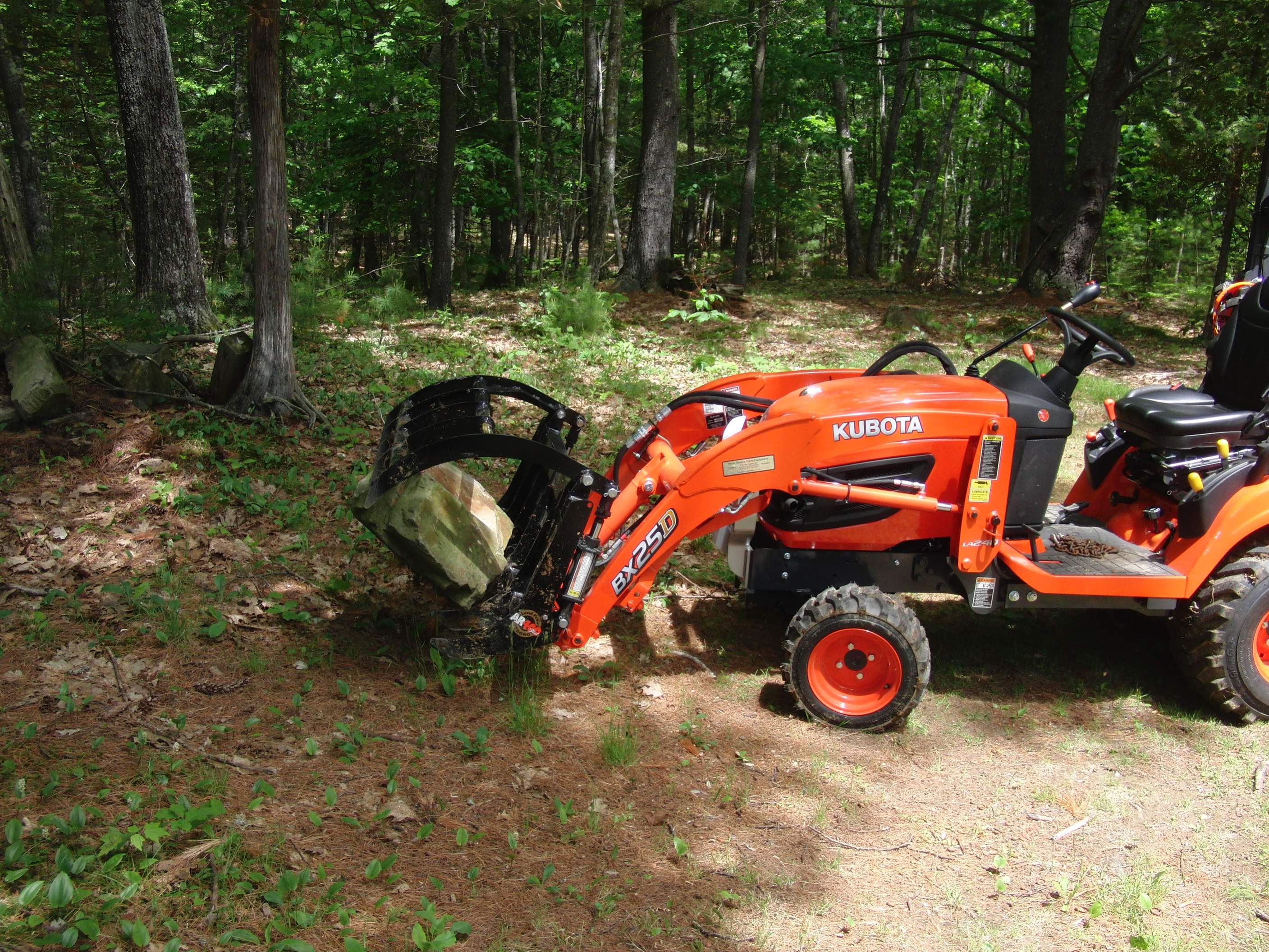

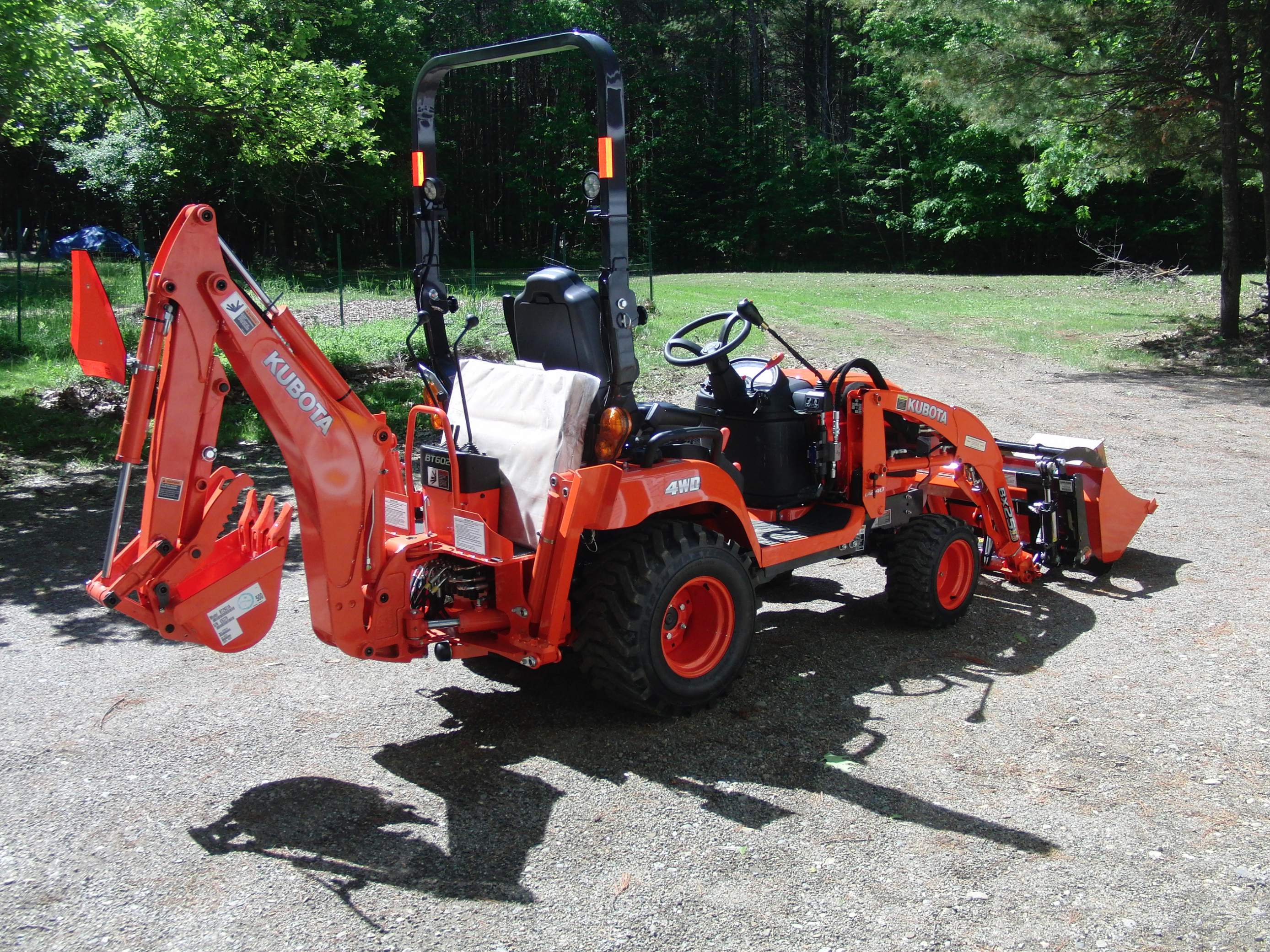

:cool2:It here It's here! :cool2:
Barlow's dropped it off this AM and I got to work right away! The Grapple is awesome, plus! BH works great for tilling the garden too!
Now I'm hoping it rains tomorrow so I can get busy with measurements and figure out what's next.
Like they say "Happiness is a new toy - er tool."
