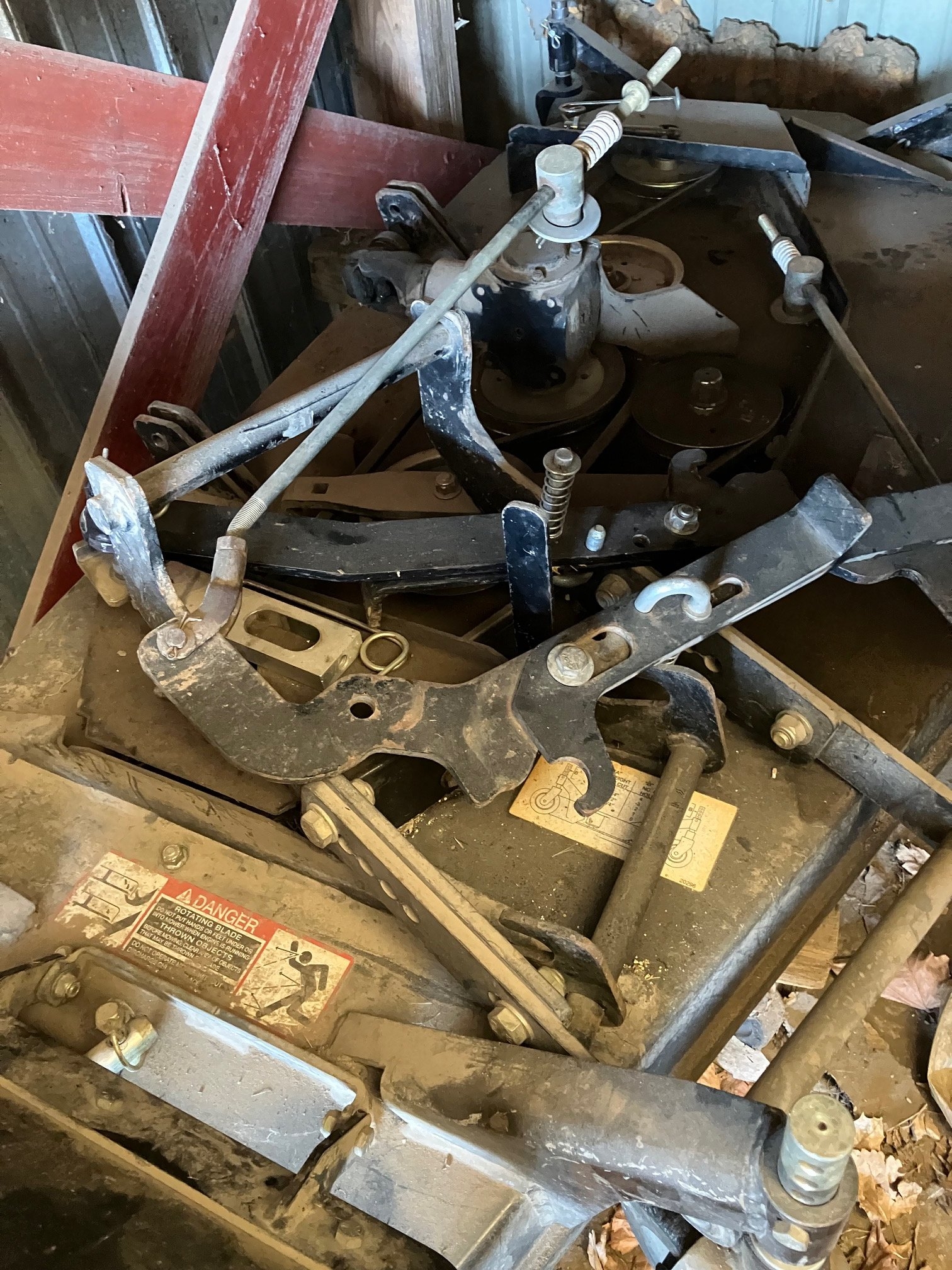

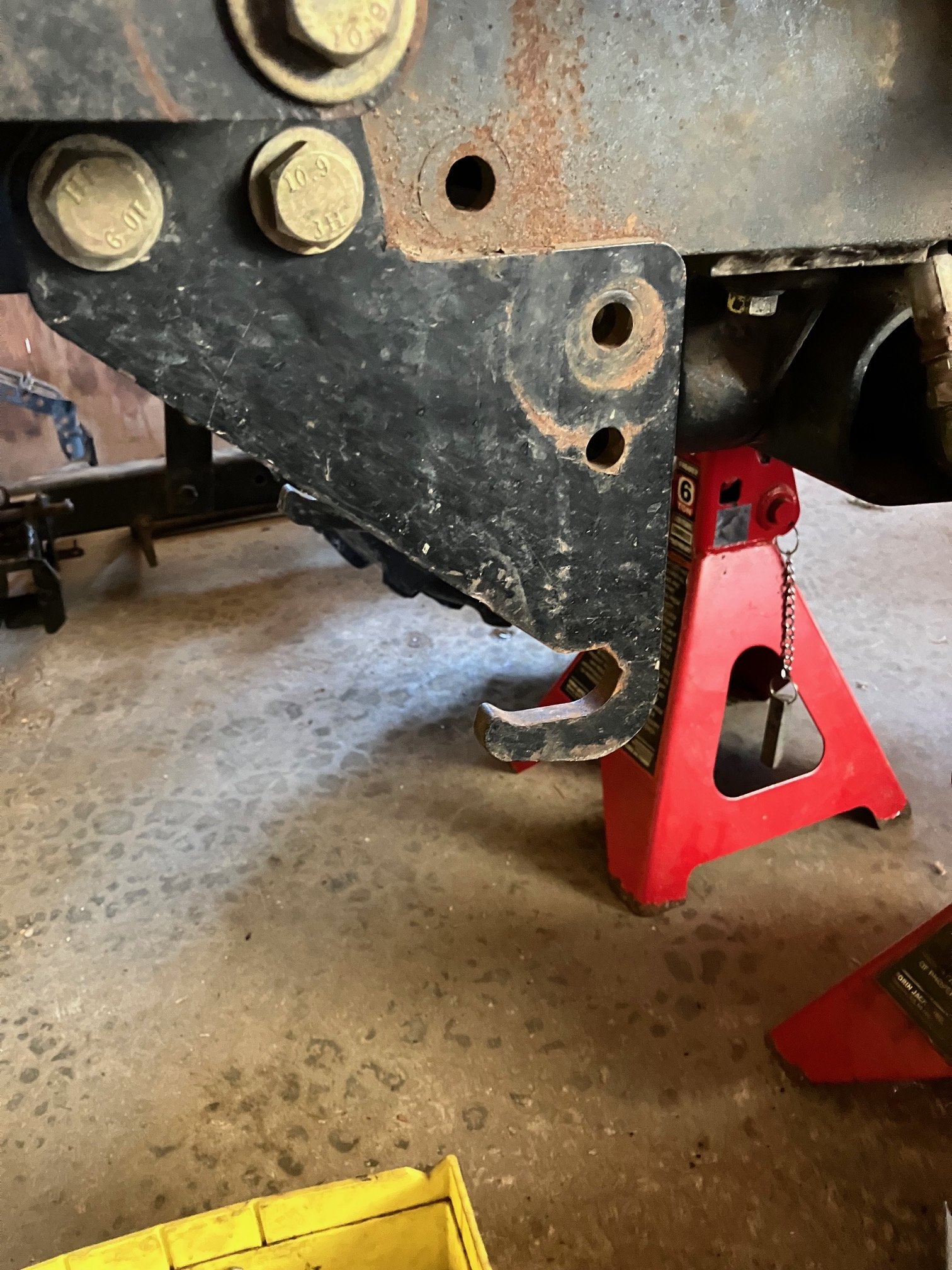

Manual I have for mower says it is an MB60A. Note this requires a mounting kit that includes brackets that bolt to front on tractor, side rails under floor board and arms that hook on lower 3 point. Without this the deck is useless. Will head out to shed and try to get some pictures of these items.
/ 2013 Branson 2400H question. #10
Some pictures of the different mounting components.
Front hanger brackets.
3 point lift brackets
linkage that connects between tractor and mower.
the round pin on the road attaches to the 3 point brackets and under floor boards. didn't take a picture of those attachment points.
Piece that looks like sled runners is the front bracket that goes from deck to the front hangers
Hope these pics are helpful.
NOTE: This on a 2012 model so not positive the mounting is identical for a 202* model. I believe the deck shape changed but again not certain on mounting brackets.
