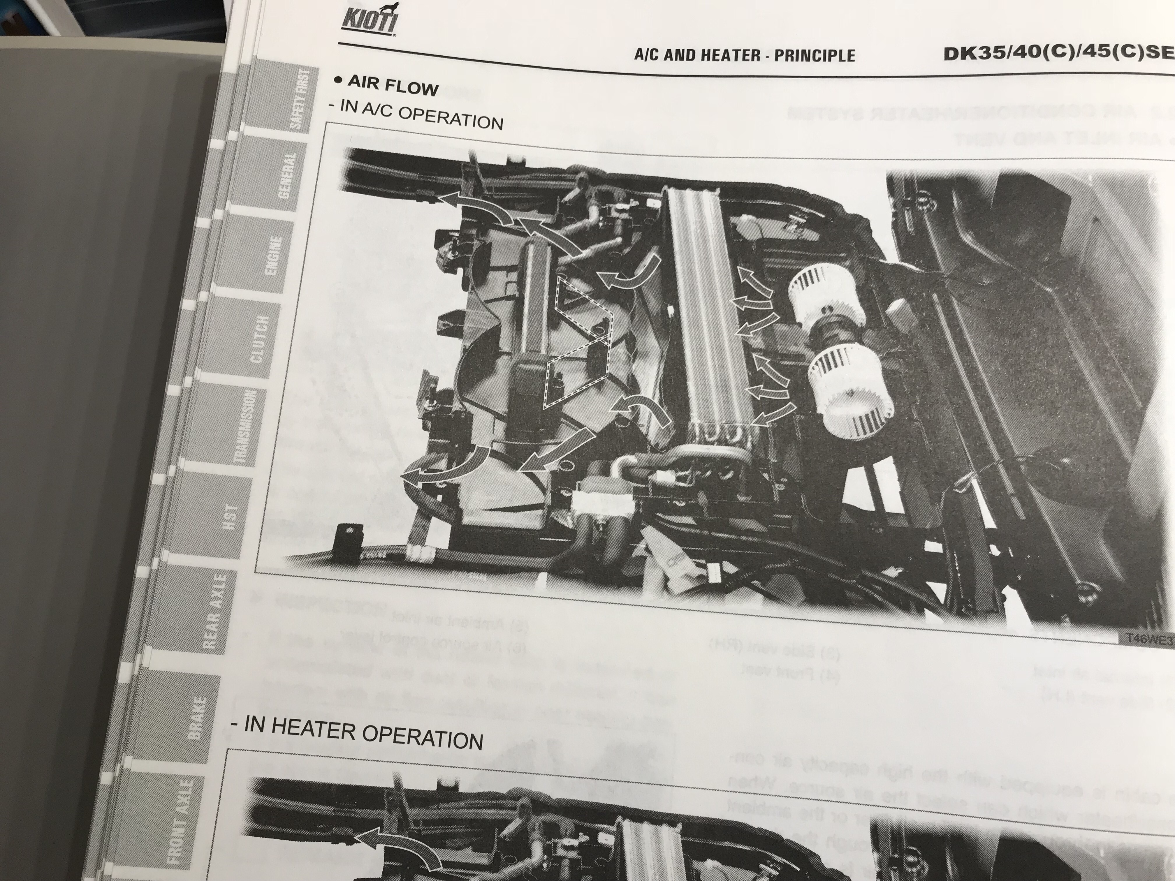

The 2010 version i have has 2 separate fans, not a squirrel cage. Ill opst a pic when i get on real computer

If you can, post a picture of how it sits in the attic of the cab too. I'll see if I can adapt the newer to the older.

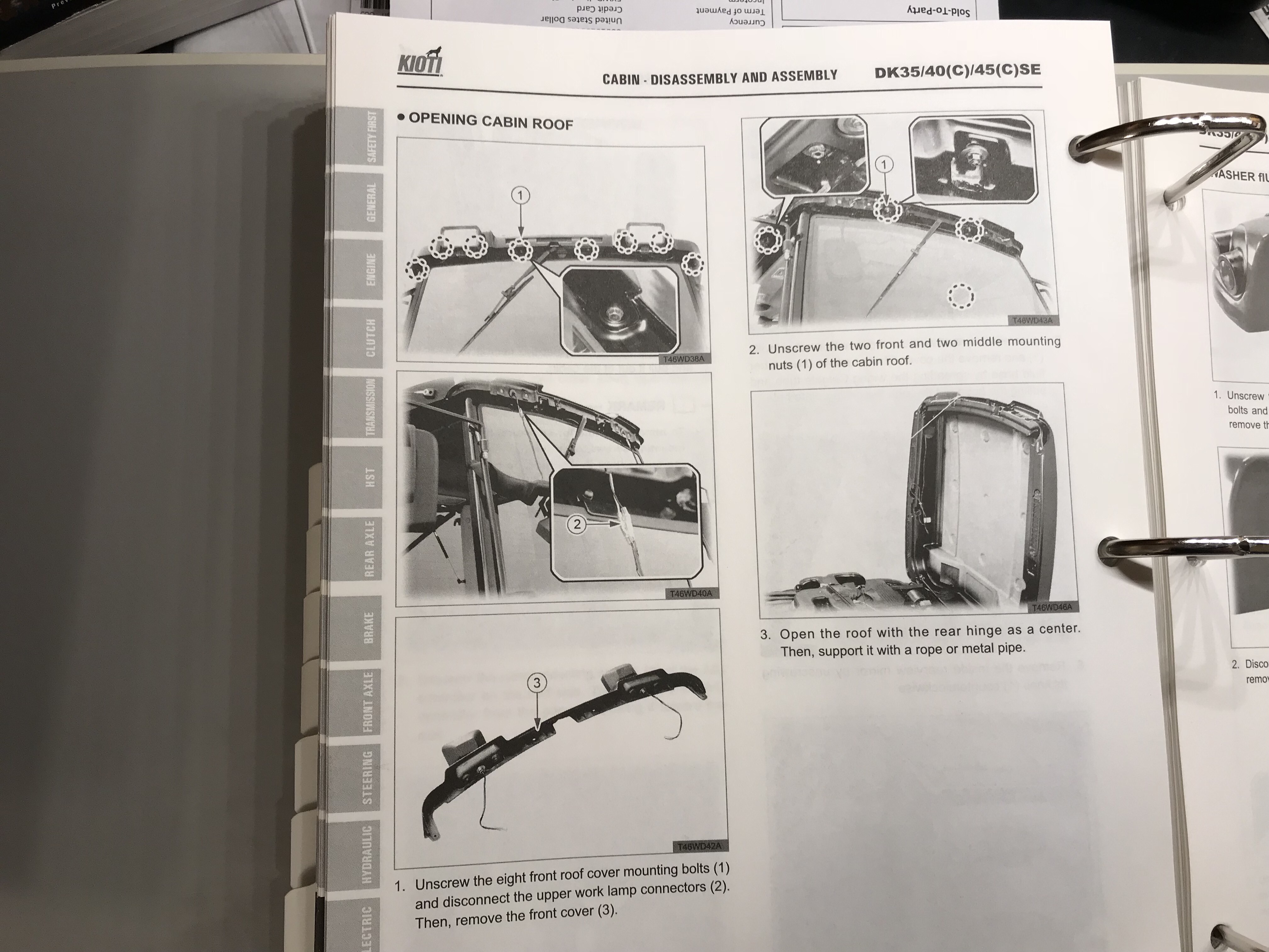

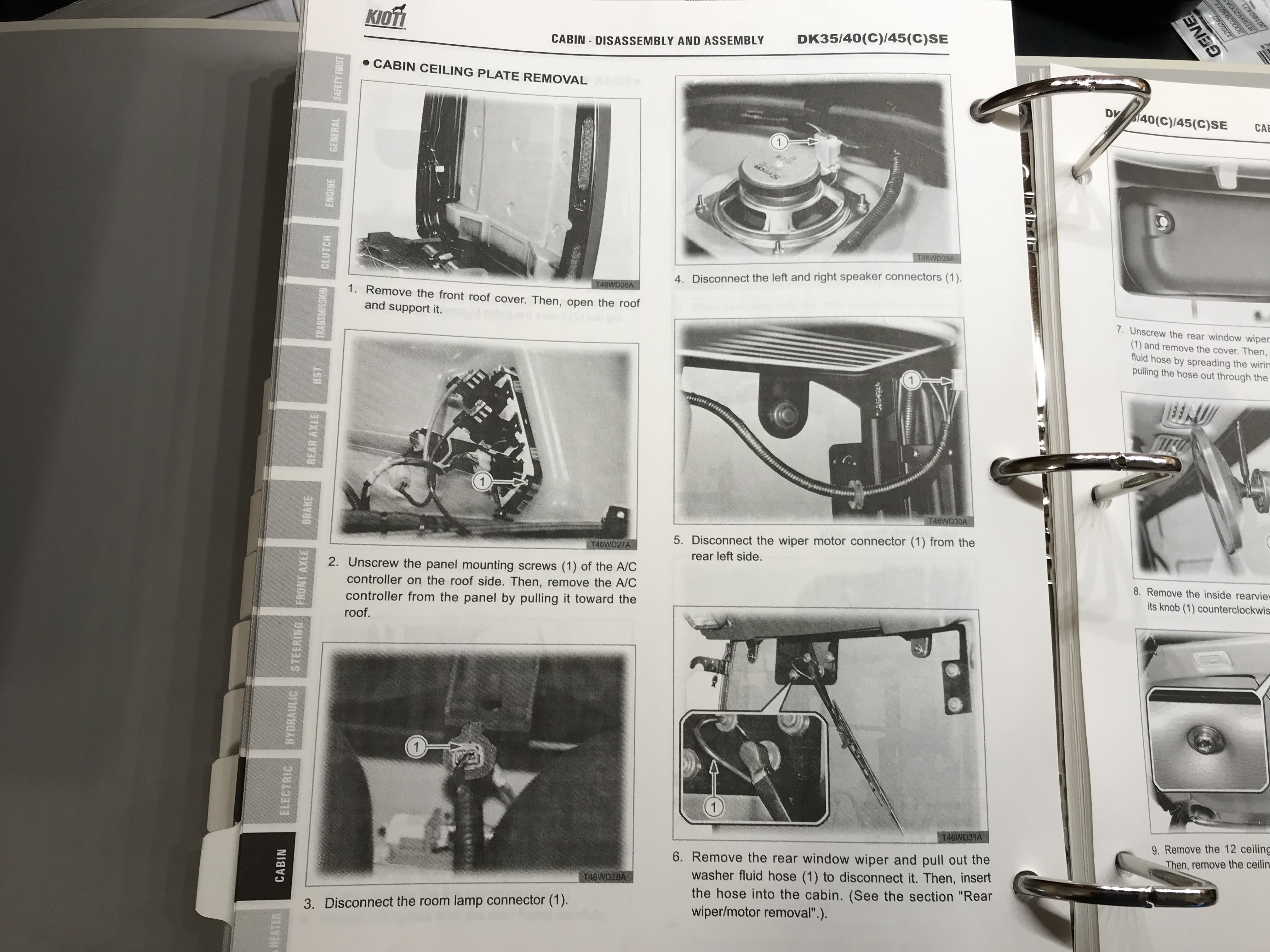

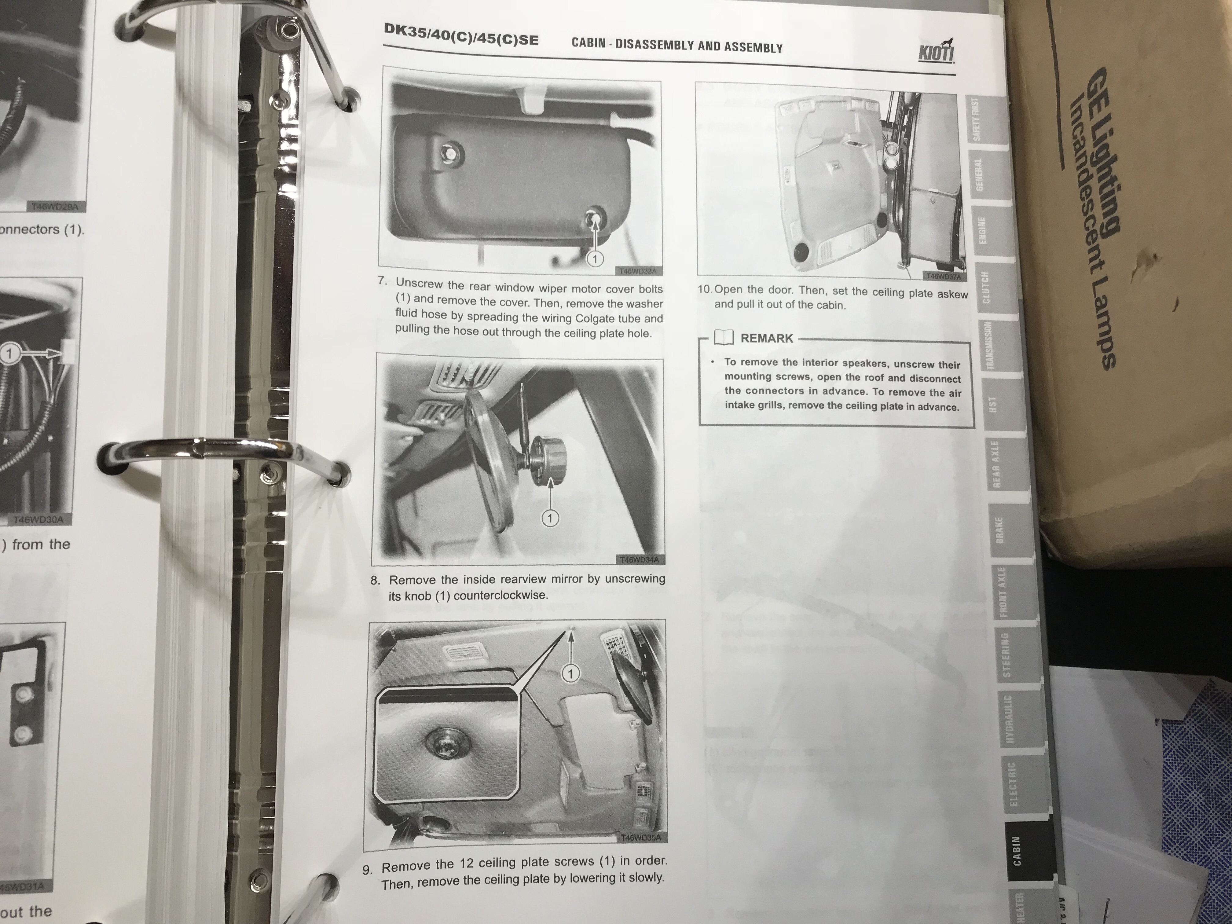

this is what im finding on the dk45 cabView attachment 591422
That's definitely different than mine, but it looks like have room in my attic for that. I like the idea of the heat coming down in different areas. How's it work for you?

My tractor heats great. I only set it half way on heat because it get too hot.

i got it thru my dealer. i have the "Kioti tractor workshop manual..its huge View attachment 590724. its been very helpful over the years
Is the tractor workshop manual available anywhere for purchase? I'd pay for a copy. I have a 2009 (engine stamp) though sold as a 2011 BobCat CT-450 which is a badged over Kioti DK50, with cab and I can't get any action out of the fan so no heat. BobCat is uninterested in supporting those tractors (208-2013) so I've been trying to figure things out from the Kioti perspective. Thanks
