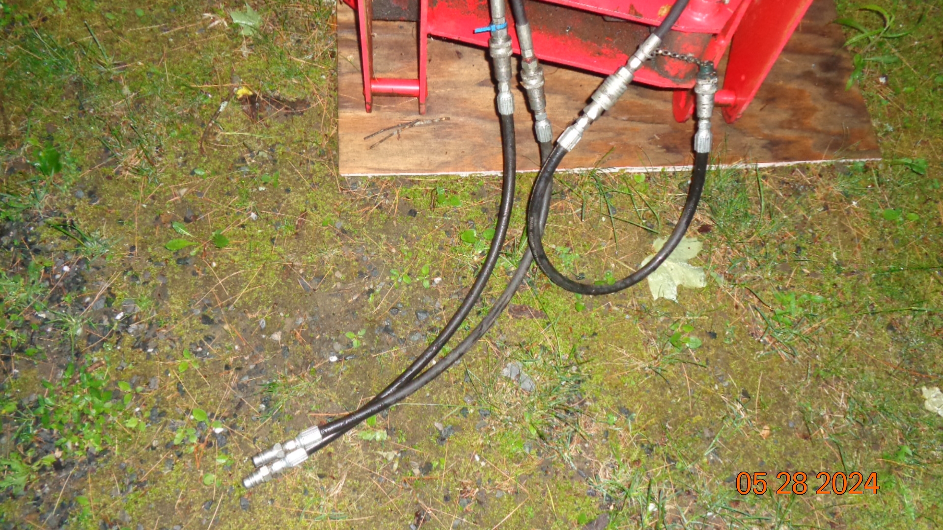

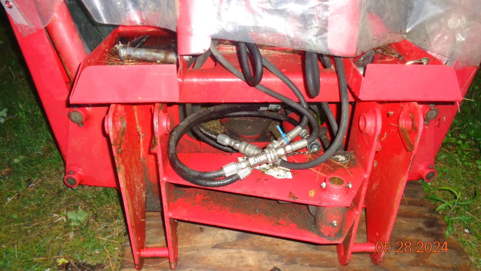

Yep, that's typical. You can make it a lot easier if you get some hydraulic extensions made up -- mine are a bit long at 24", but having them allows you to connect the hydraulics before mounting the BH -- just back up close and connect.
You can then lower the stabilizer arms to raise, then the boom to tilt, the whole unit.... then back up to it and lower it into the mounting sockets -- all with just one person and a minimum of futzing.
You just have to watch the extensions carefully so they don't get pinched, tucking them into the empty space beneath the "floor" of the BH as you back the tractor up closer. I just leave them tucked in there while using the BH -- they stay out of the way easily.

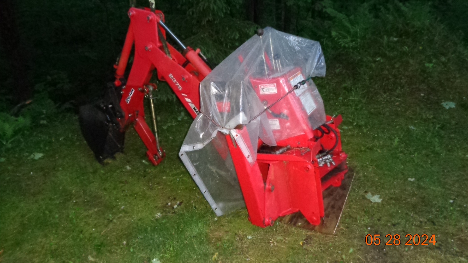

Why was the loader hard to get back on? Had the hydraulic arms retracted by themselves? That often happens with mine.
   / 2003 GC2300 broken radiator.
#50
Oops... you were talking about the LOADER! Must have been a senior moment on my part -- haven't had my second coffee yet....Well, anyway, the BH can also be a pain!
The positioning of the cylinders and also the hydraulic hoses are a little short to the joy stick controller so there was no way to plug them back in until the loader was pinned in place to the tractor's mount.
