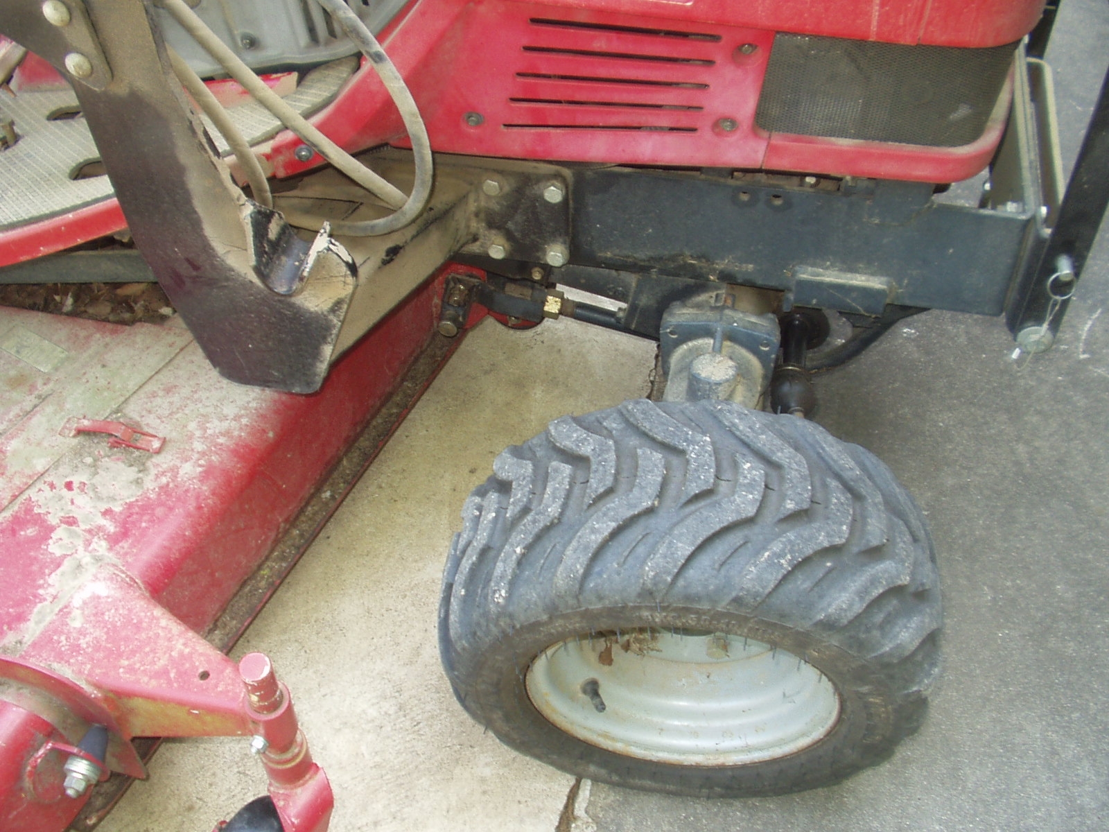

Kind of curious, did you peruse the tractor salvage yards for a radiator?
Modern radiators are a lot different than old ones. Usually, the top and bottom tanks are plastic and sonic welded to the tubes and really cannot repaired. Kind of planned obsolescence and really not repairable. If it still leaks slightly, I believe I'd add some stop leak as well. Back in the day, we used an egg white as stop leak. Works pretty well actually.

It held water so I went ahead and put it back into the tractor. I ran it for a some time until warmed up and noticed no leaking so I buttoned everything up. I then went out and mowed some lawn for little more than 1/2 hour with the Temperature near 80F outdoors. Tractor got plenty warm but not overheated. After parking back on the concrete in front of my shop I looked all over for signs of leakage. Could not find any. So for the moment the repair is holding.
Yeah the tank has the blow molded plastic top and bottom. It really is not designed for repair. But if they wanted to sell replacements for something that has maybe $5 worth of material in it they should set the price more reasonable. Like $200-$300.
How long it will last is anyone's guess but for now it is working. Thanks everyone for your advice and help.
