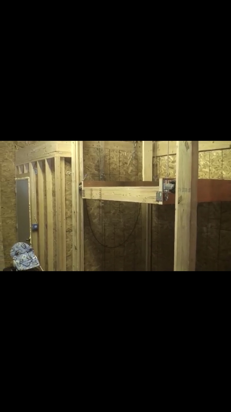

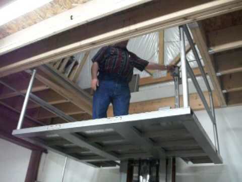

Not sure how much weight something like this can lift..but it looks like it has a lot of cables to get tangled up in. IMG_0838.JPG
The metal one looks perfect but I’m not sure of how much that can lift either and that one is hydraulic. I know nothing of building anything hydraulic...

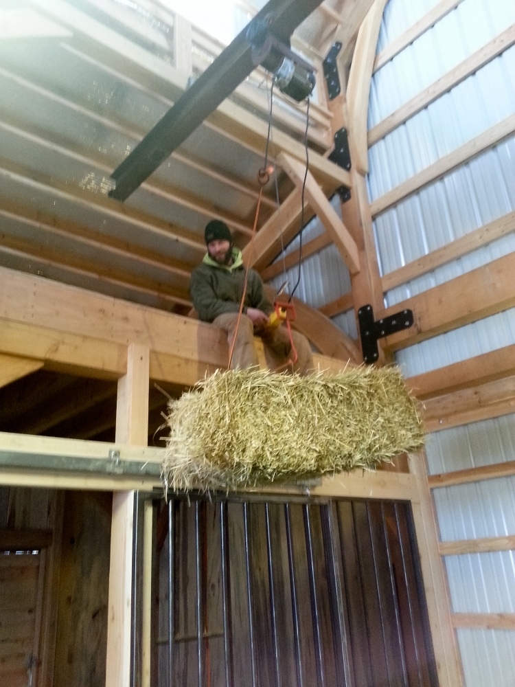

I don’t want to be this guy...using a winch to lift 1 bale at a time. (Although I find this picture incredibly sexy for some reason...)

Don't forget to factor in the weight of the car or pallet you plan to put the hay on. Something 6x8 that will hold that many hay bales is going to have a fair amount of weight JUST in it.
I use a 120vAC "Strong Arm" winch (w/out clutch for overhead lifting) on my wood elevator. They make a model that is rated up to 4000lbs Dutton-Lainson Company - Since 1886. This is often used to lift smaller boats out of the water for winter storage.
I use the SA9000 model to lift a 2x2x4 car of wood from the basement to the ground floor level. I went thru several lighter weight winches over the years before I switched to this one. So far, it's done a pretty good job.
