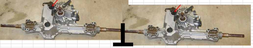

Okay, the question is not particular to the K46 but could be any non-locked hydro transaxle. If you mated them end to end to make a transaxle twice the width with the connected axles locked to the tractor frame where they
couldn't rotate, would each one operate the free axle similarly to a zero turn?
/ 2 Tuff Torq K46's mated together #2
Don't know how long the spider gears would last spinning all the time.
Ahh yes I see what you are saying, in that they normally jus take up the differential rate of rotation between the two axles and now they would be always engaged.
So maybe it would be better to lock the differentials and not lock the unused axle?
/ 2 Tuff Torq K46's mated together #5
Right.
If you lock the unused axles to the frame so they can't spin, the using axles will spin twice as fast as normal.
/ 2 Tuff Torq K46's mated together #6
Your next problem is traction. The tire that spins is the one that losses traction, the other tire just sits there that has traction. You would need something with limited slip. That way power is to both wheels whether it has traction or not and you will still move. So if you tie the inner axles together, you won't move.
/ 2 Tuff Torq K46's mated together #7
What are you trying to build?
So the locked/welded differential will make both axles spin and the spider gears are no concern. Don’t connect the axles of the two transaxles together Traction is guaranteed, at least power will be transmitted.
What am I wanting to build? I’ve had this configuration in mind for either a home made mower for an unused 6’ 3 point hitch mower I have - could be zero turn or front mower type both require individual wheel steering. Also though it might work for a tracked snow/mud toy. Not an immediate project but trying to understand the possibilities of these widely available transaxles.
Thanks to all for the replies.

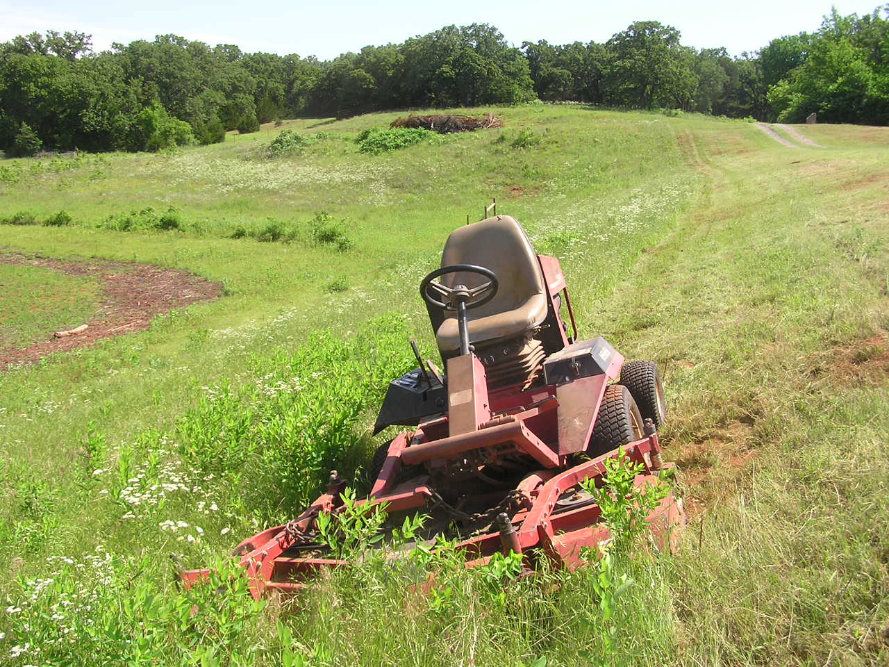

I know there are front deck zero turn mowers, but the rear wheel steer front deck mowers with a differential axle are awesome:
/ 2 Tuff Torq K46's mated together #10
I remember combines with their rear wheel steering took a little "getting used to" in order to drive straight. Is that true with the Toro type mowers? I can see where the rear wheel steering would outshine a ZTR on slopes.
/ 2 Tuff Torq K46's mated together #11

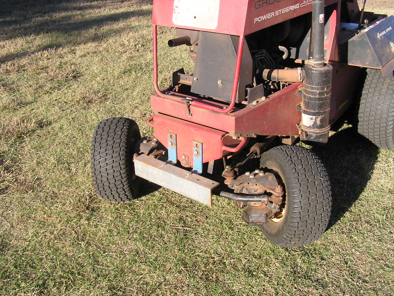

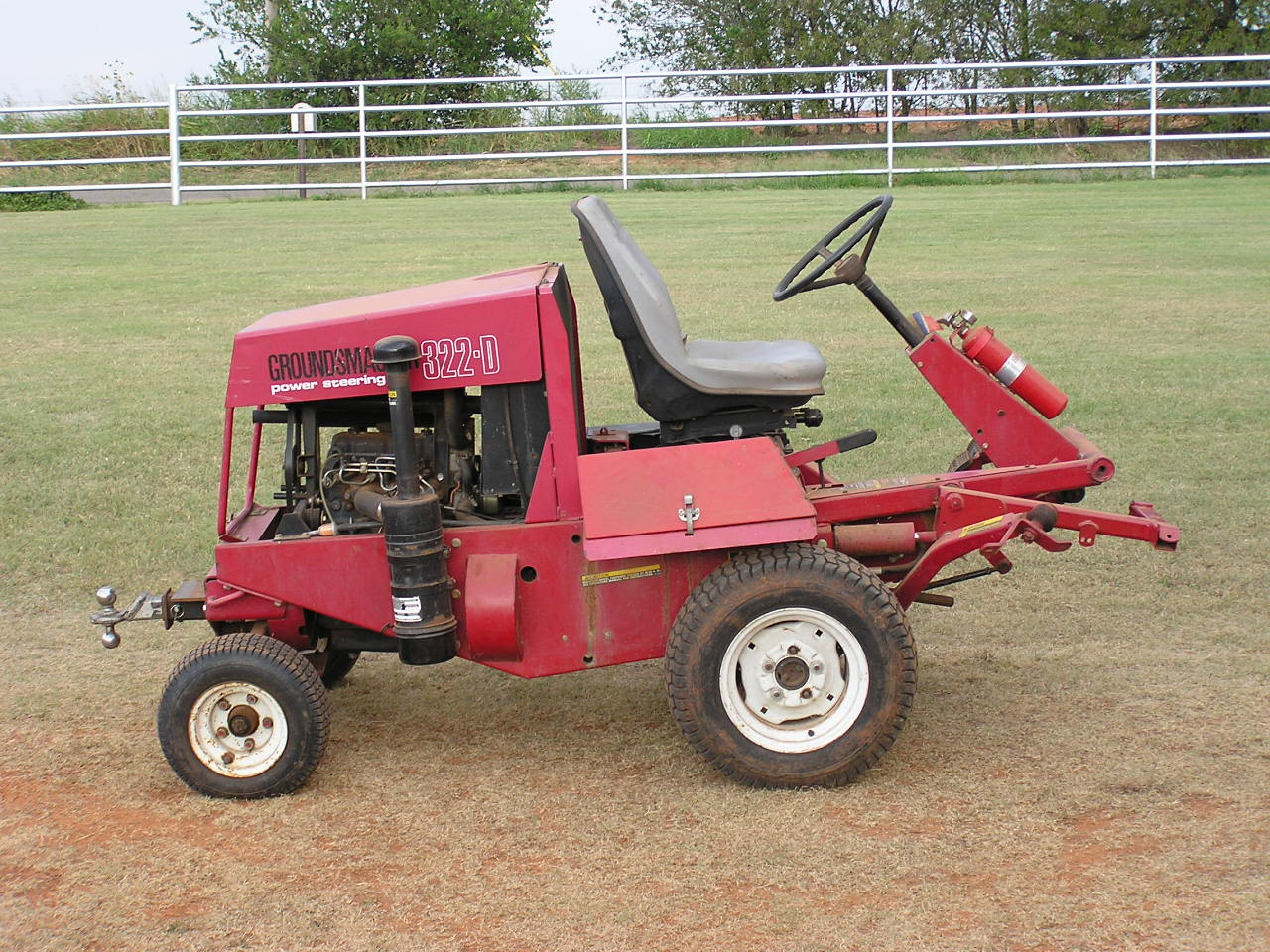

I guess I got used to rear wheel steering pretty quick, no problem driving straight. They do turn very sharp:
Got my first one in 2003, a 1990 model 322D:
Still have it, added the loader:
