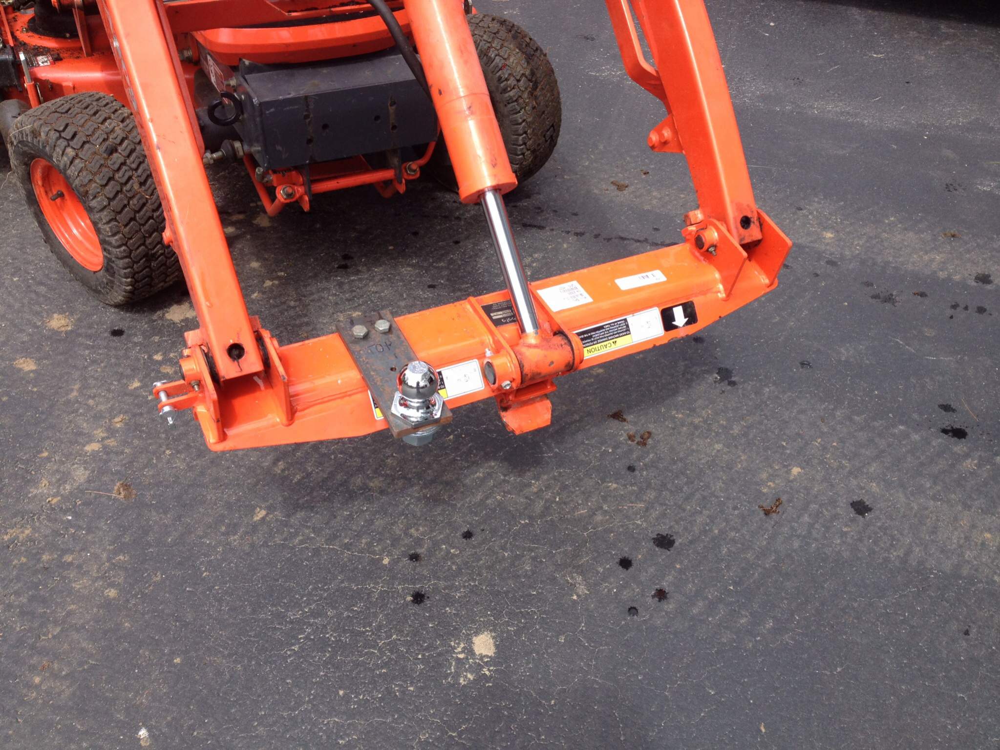

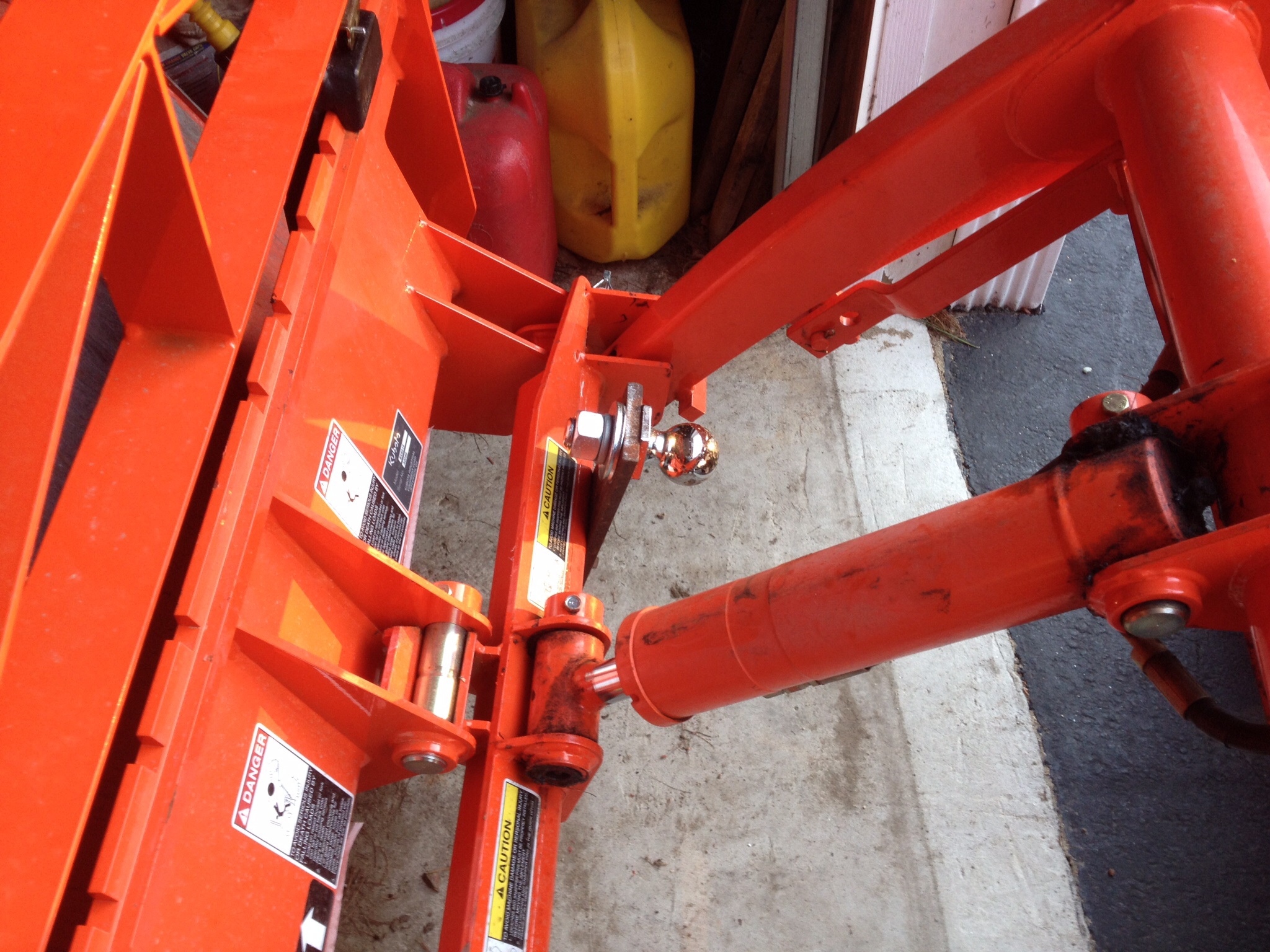

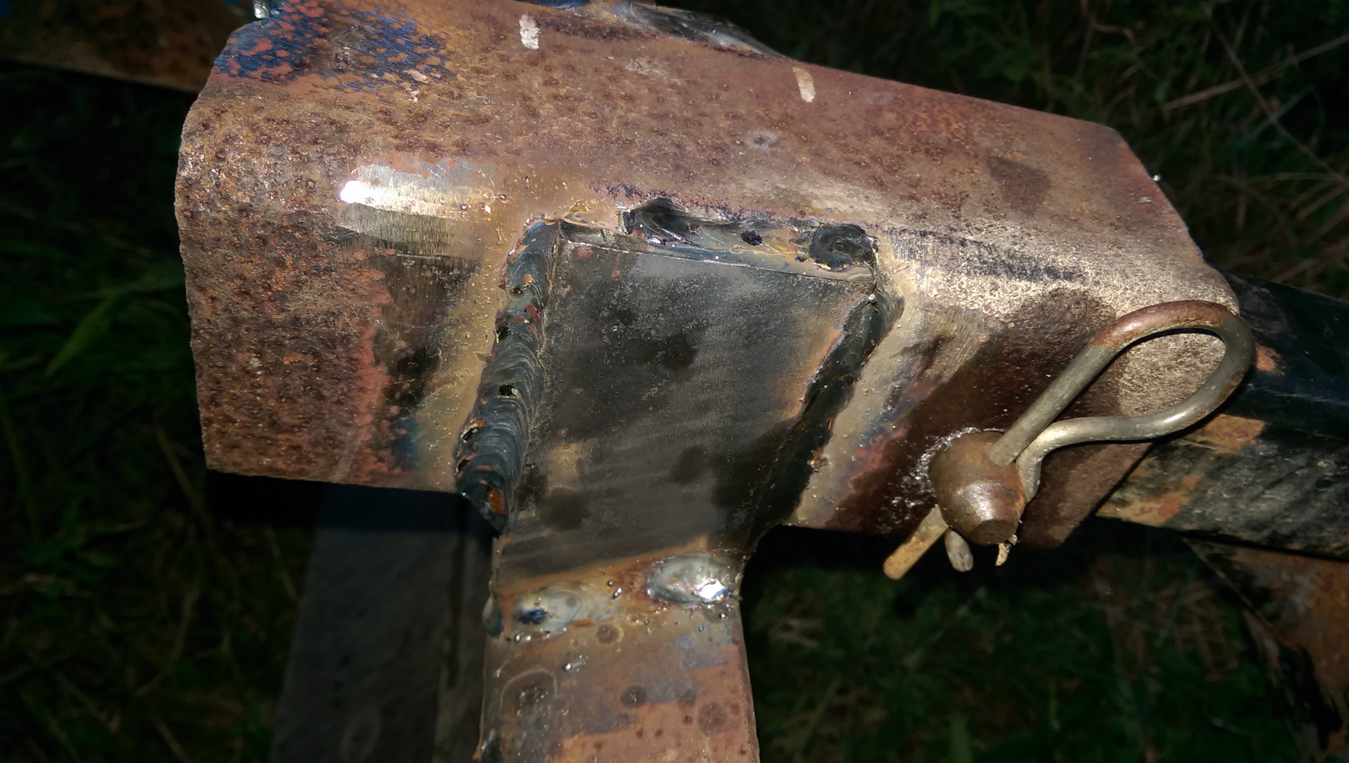

Found an easy way to add a trailer ball to the quick hitch. Just bolted a scrap piece of 1/2" steel to the quick hitch, and drilled it for the ball. Works great for moving the trailer around the yard, just roll it all the way forward. It is out of the way when using the bucket or the forks.

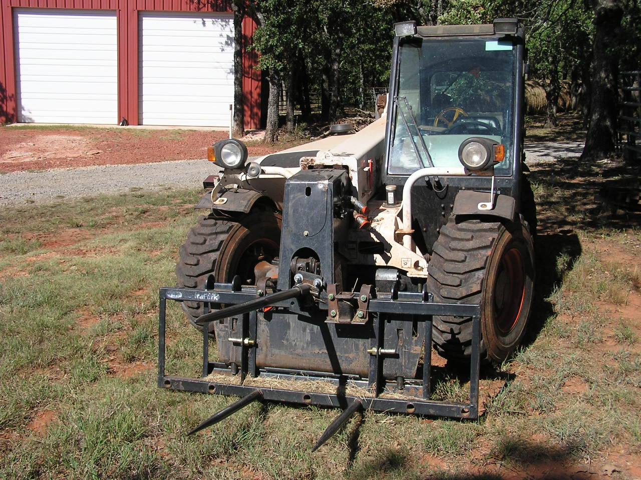

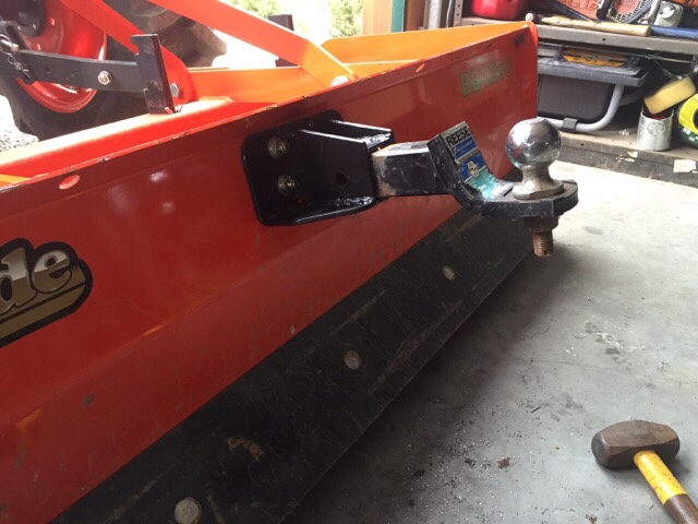

That's cool heres my version of it .

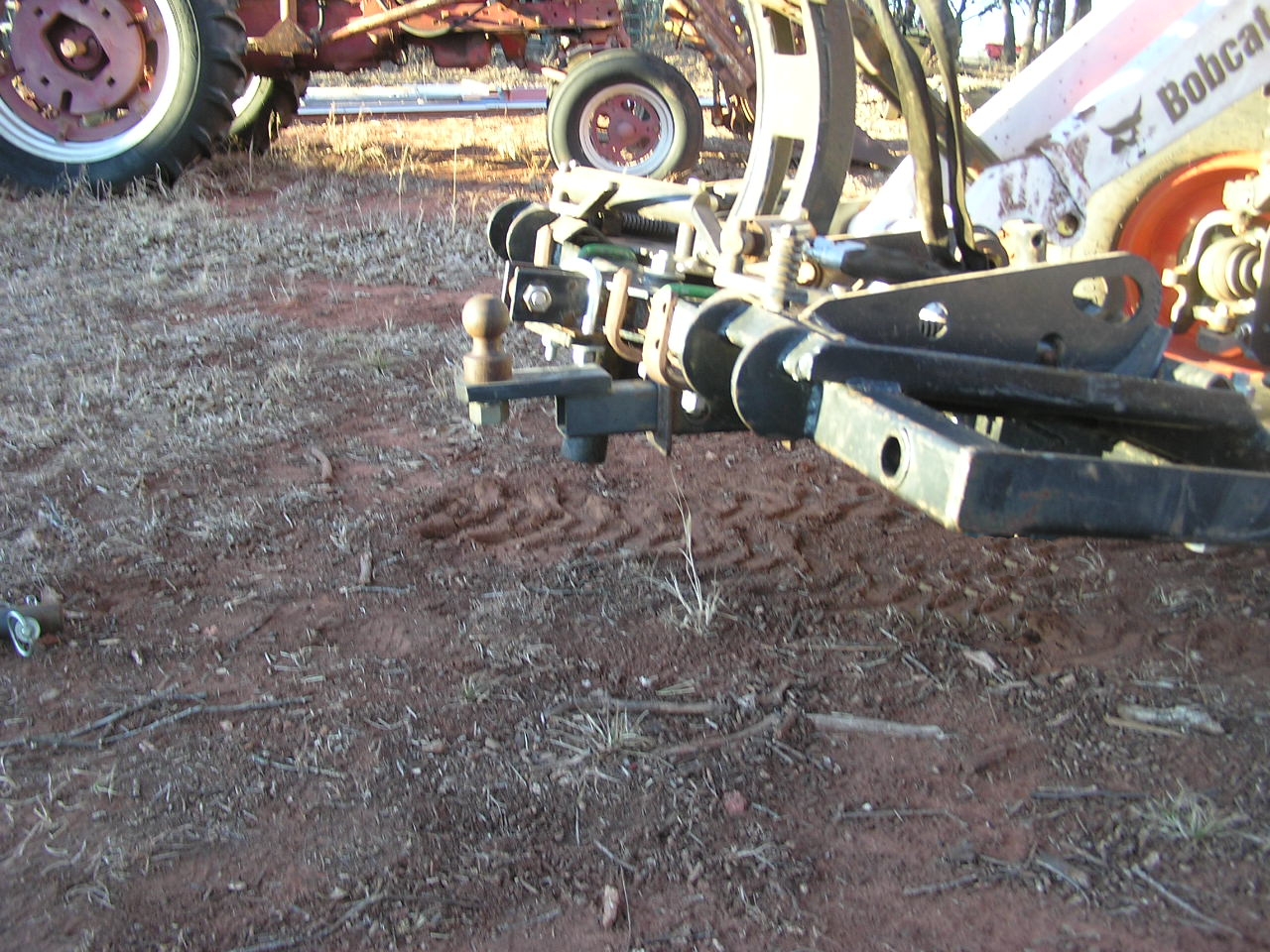

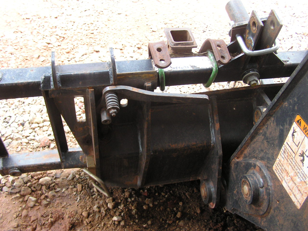

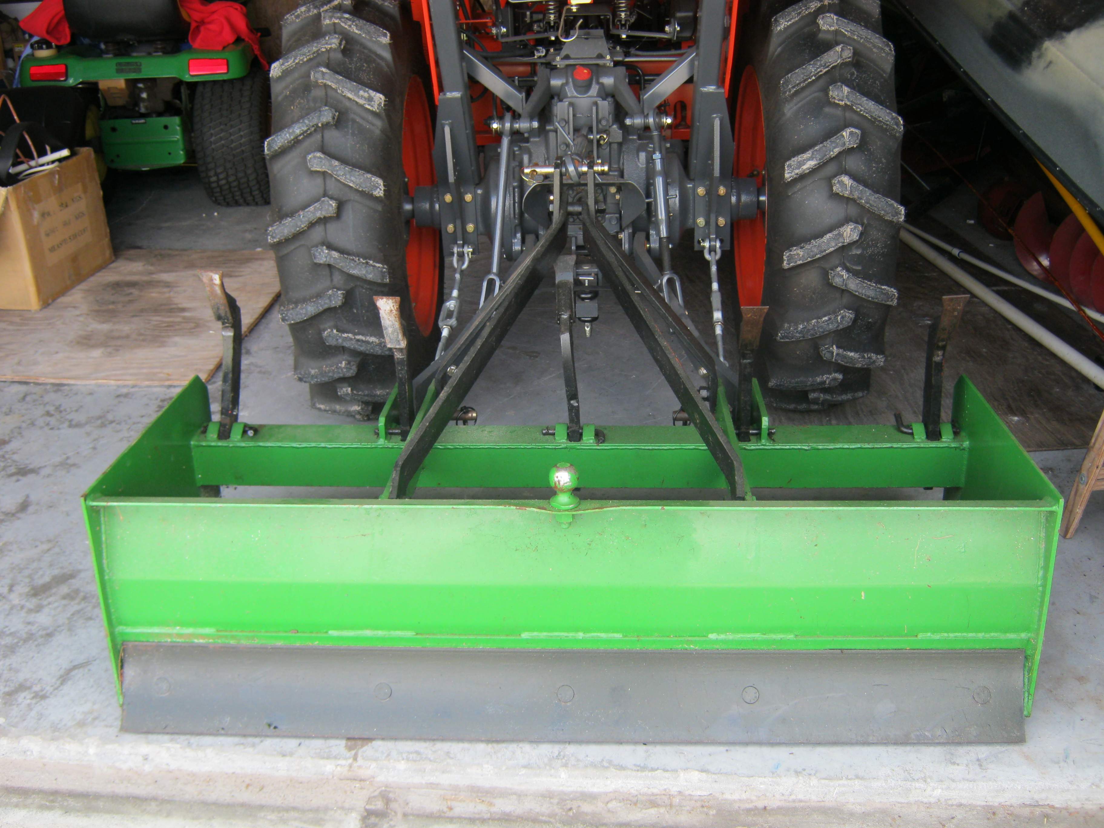

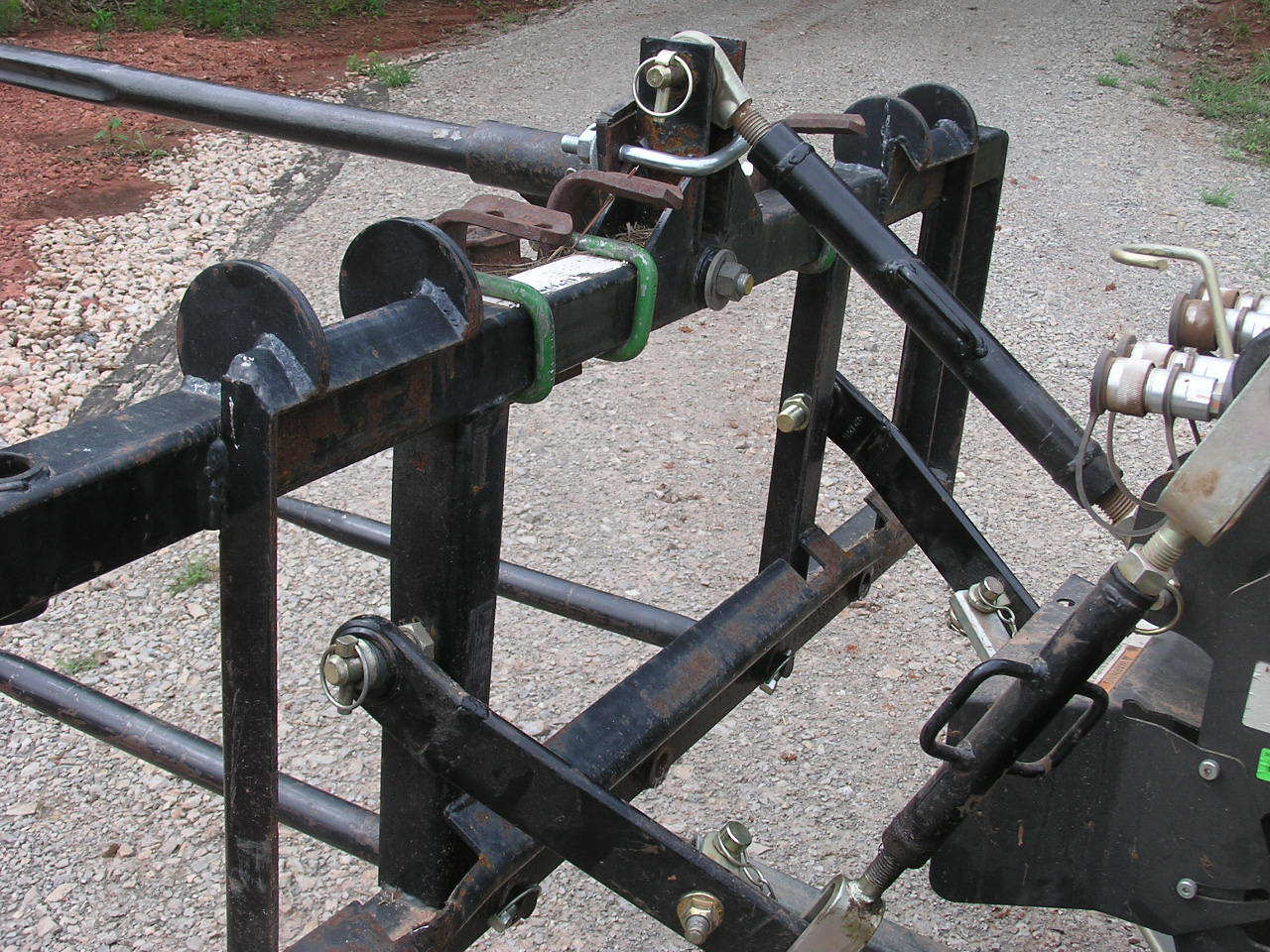

Reminds me of the receiver hitch that I bolted to the top frame of the Speeco Ultra fork.

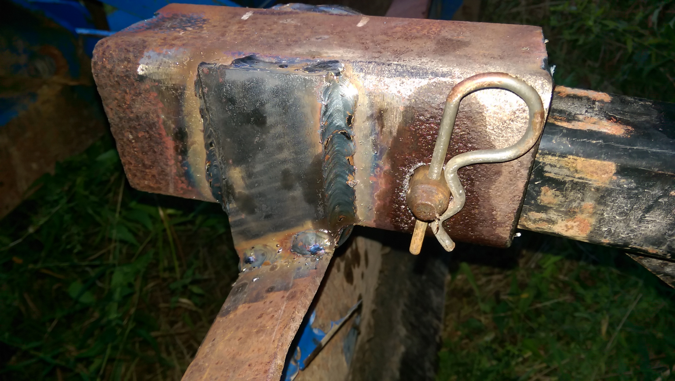

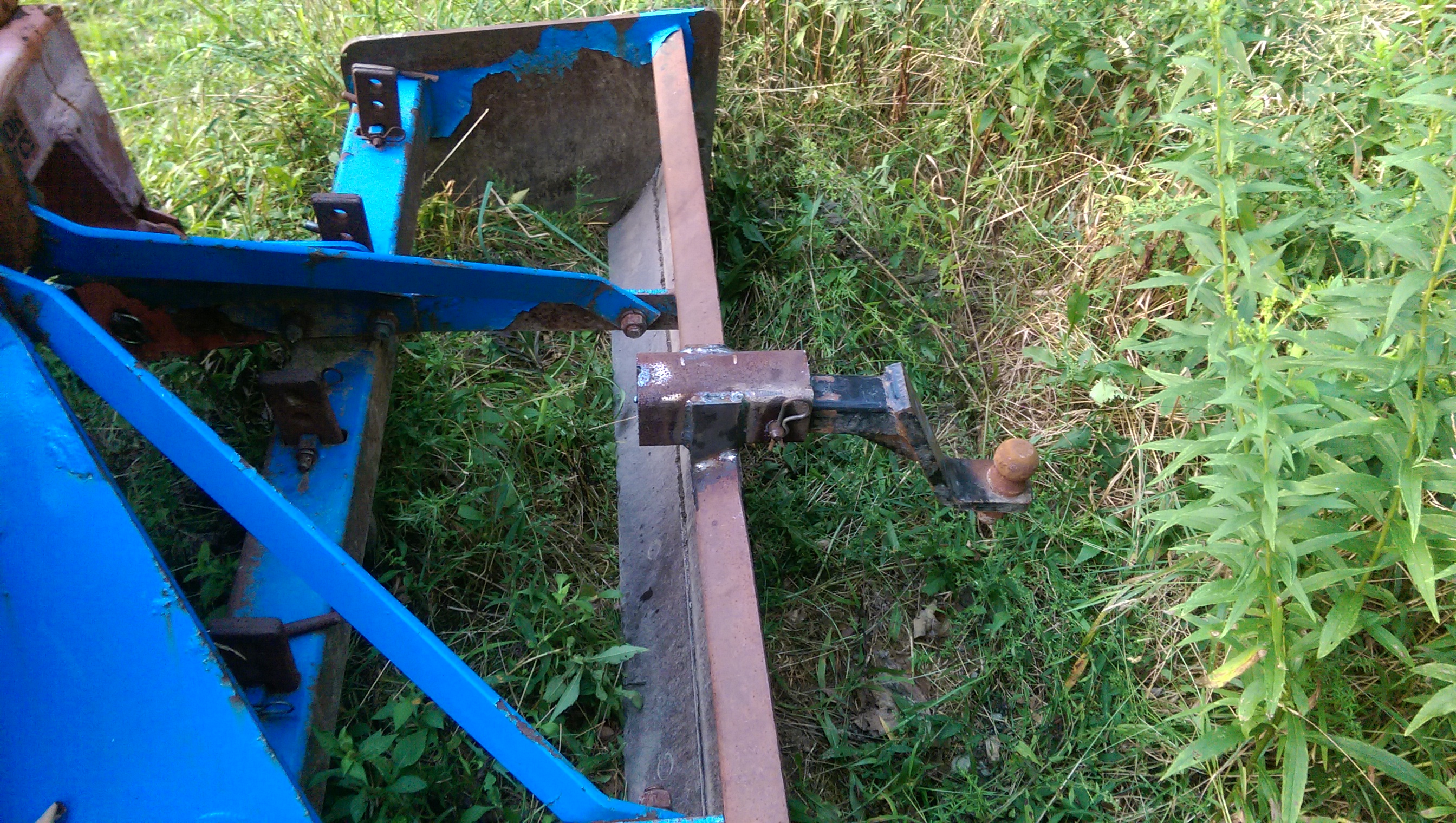

Here is what I added. I forgot this box steel was too big for the Reese hitches, so AFTER installing it I added some flat stock inside to make a better fit :eek:
Worked quite well for a popup we converted into a two layer canoe and camping gear trailer. Really like the ability to maneuver in tight spaces.
Thanks for the inspiration!
Welding? You will have some weight on it and pulling a load. If you have someone nearby who welds, invite them over. Do you have a welder? If not, a portable 110v should work for this.
You can have them show you basic welding while you're at it :thumbsup:
I am going to look for a couple of rings or something to hook chains to- especially since it is light duty. I used flat stock on either side, but still only something like 5"-6" of weld, so better to be safe.

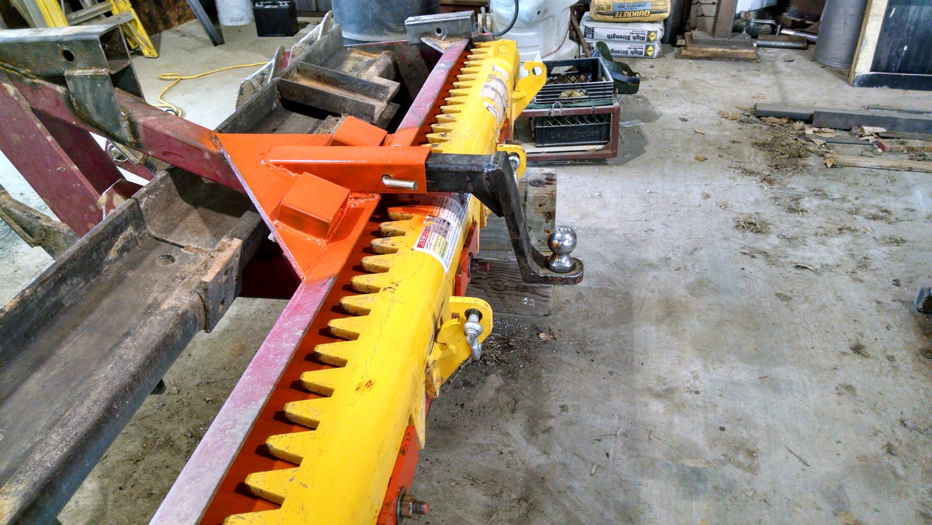

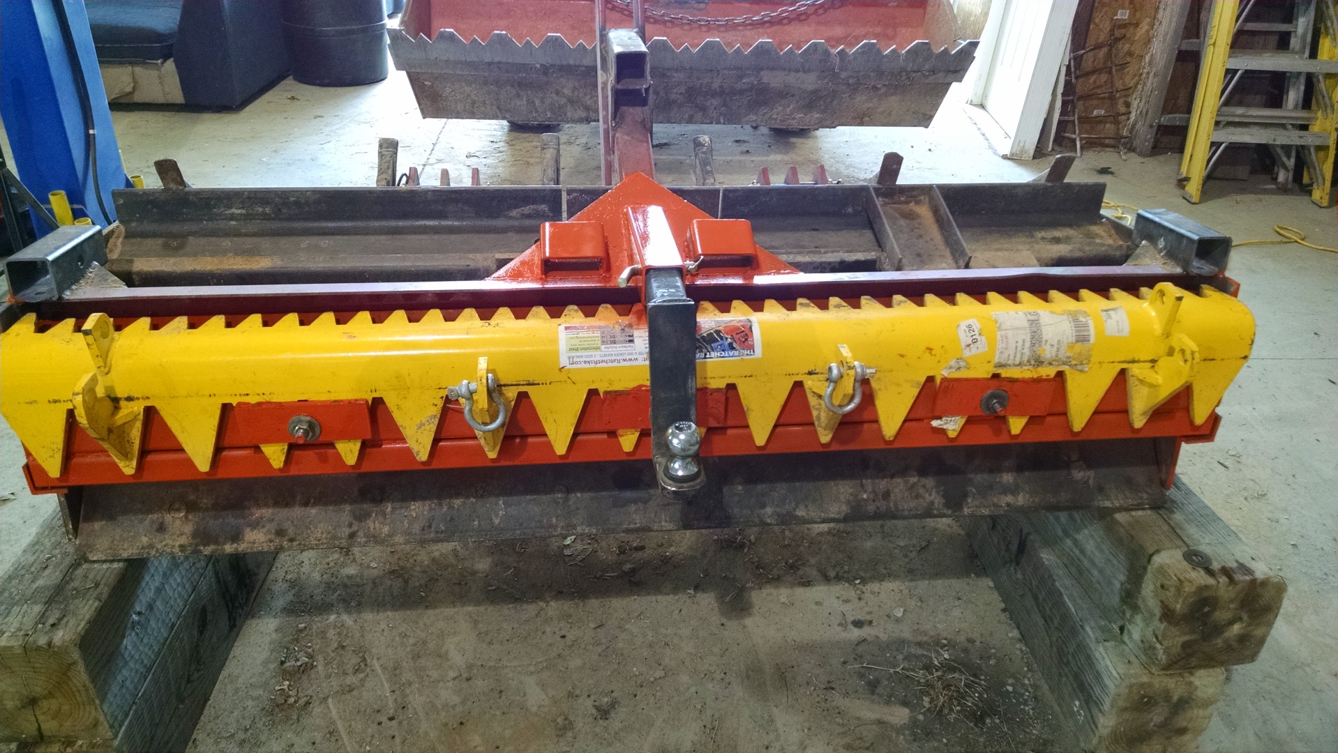

My version on my LMC BB:
/ 2" trailer ball on box quick hitch #12
/ 2" trailer ball on box quick hitch #13
Very nice! Did your BB have the center brace already, or did you add it?
What are the teeth? Did you add those? Looks like you added weight, too?
The triangle was alrea1dy there installed by the manufacturer; you can see it on their MT BB here: Box Blades
The rear is a 8"x8"x72" steel, lead and concrete weight block. It weighs 410 lbs. I made it into a Rachet Rake (yellow teeth) holder as well. Total weight = 520 lbs. Made the BB far more effective.
Sweet! What are the box sleeves for on each side of the triangle? Do you mount something there?
What do you use a Rachet Rake for? I use the BB, then York Rake with the spring tines. They don't look deep enough for much seeding?

The "box sleeves" are 3/16" stake pockets from AWDirect. Far more useful for chain work then hooks.
I've used the RR once, then never again. For me, didn't work all that great.
