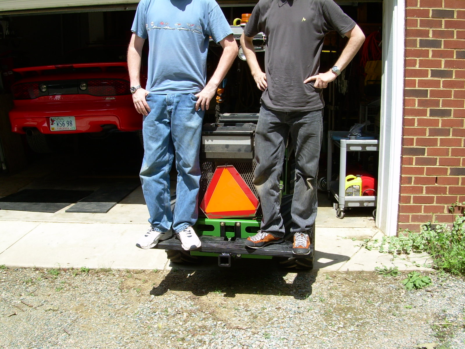

Hopefully this is my last set of pictures for this attachment. I expect everybody is getting tired of the updates.
I noticed a little tilt. Other than that it looks good. I had some friends stand on it to demonstrate its strength. Their total weight is about 330 pounds. I cut their heads off because that would have been too much weight. I also put my 250 pounds on one side (not at the same time as theirs) and there was very little give.
Thanks for all of the interest, support, and advice. This make for a much better attachment.

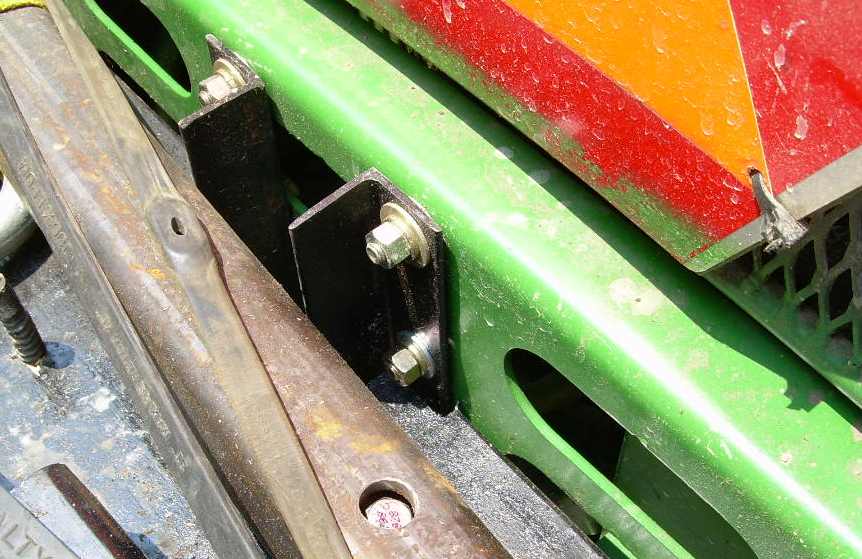

I figured it is time for an update. I added two more bolts near the middle of the angle irons. This is probably not needed, but it was easy. Notice that they are installed where the metal web is located, not where Power Trac had cut out slots. I think this is important. I am now comfortable with this change and will probably not need to take it off very often, so a couple of extra bolts is no big deal.

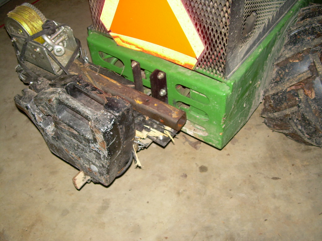

I did an untentional modification to my bumper today when a tree got between the rear wheel and the bumper. I ended up breaking off one end of the bumper. The metal was not damaged and I guess. I should be happy because that was the idea. The wood bumper breaks and not the metal. I have made a new wooden piece and it is only 29 inches long so it only sticks out 3.5 inches past the PT body. The old one stuck out eleven inches, even with the wheel. I have attached a picture of the broken bumper. The new one is in the paint drying booth which looks a lot like my garage. Lession - Don't stick things out to far or they can get broken off.
